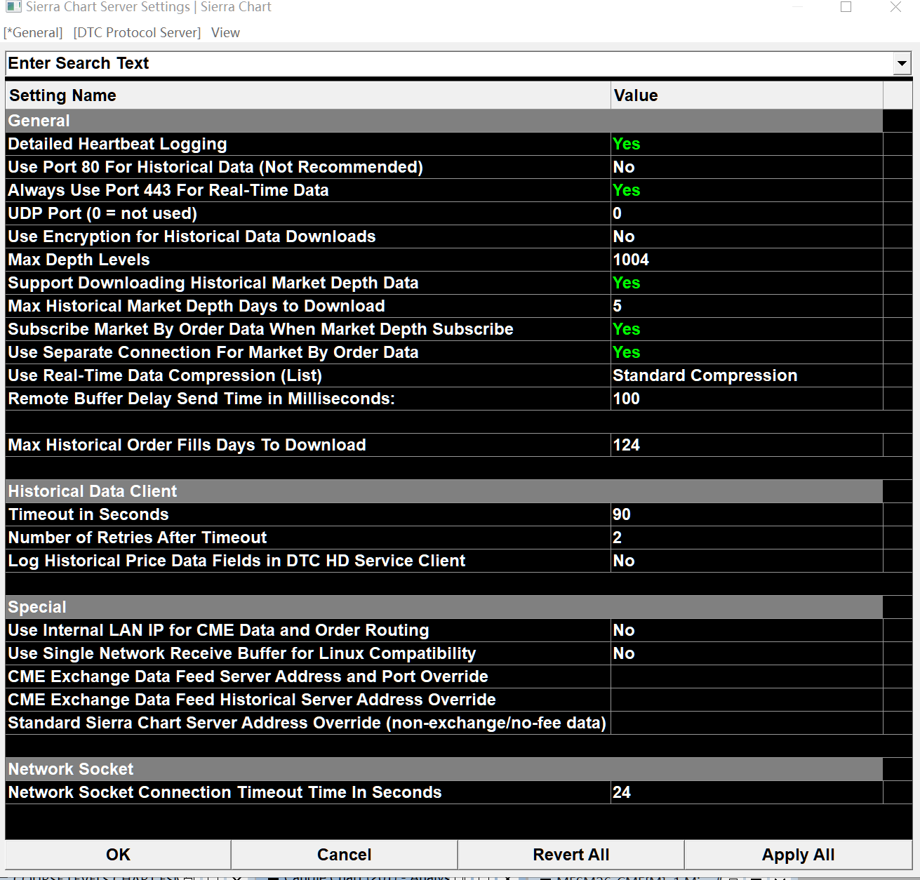

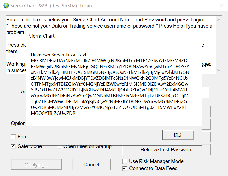

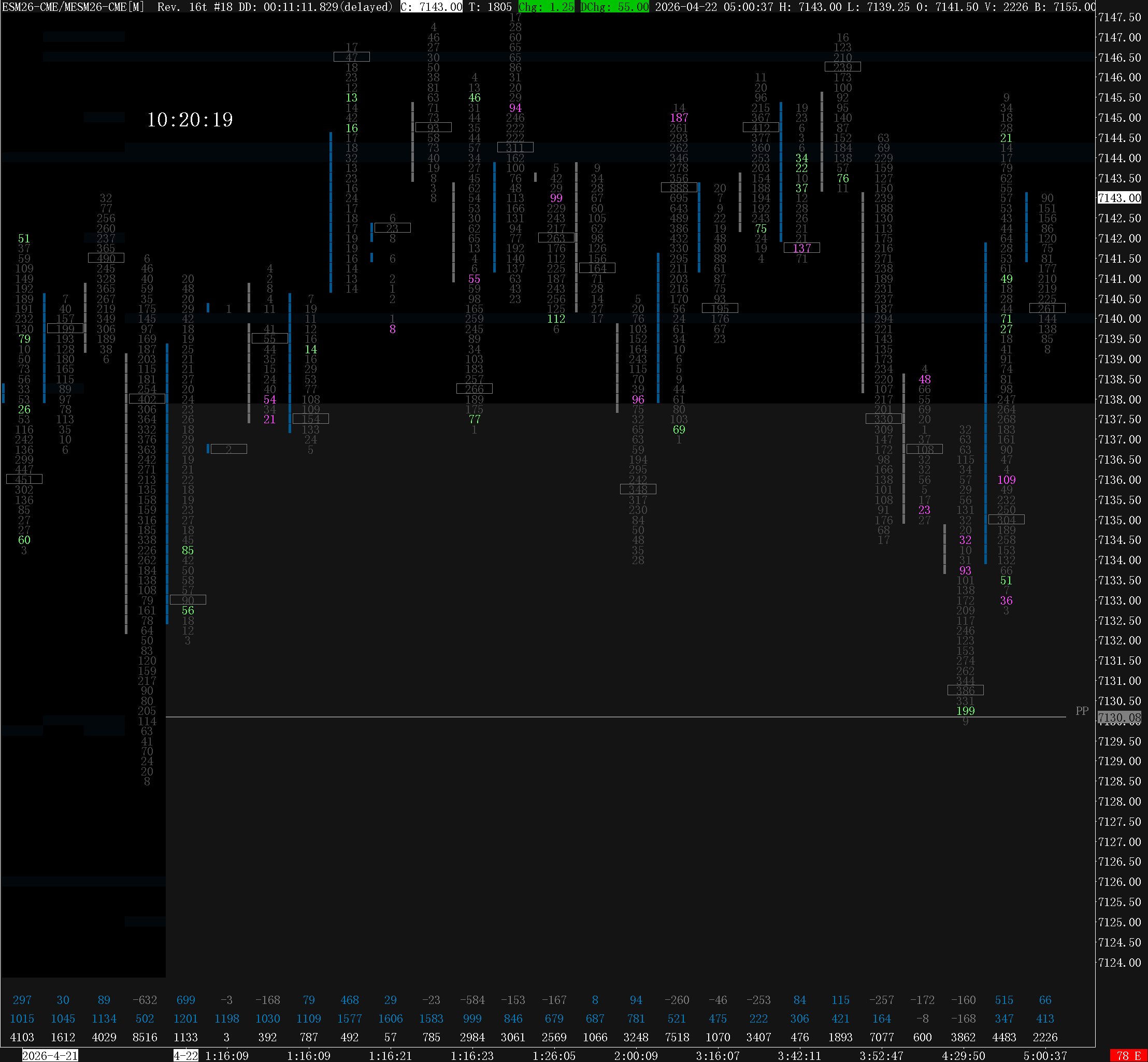

Firstly, when I login sc, this error happens more than half of times. And pic2 is my sc server settings.
imagelogin-unkown-error.png / V - Attached On 2026-04-22 19:32:35 UTC - Size: 65.85 KB - 167 views
imagesc_server_settingpng.png / V - Attached On 2026-04-22 19:32:45 UTC - Size: 38.15 KB - 180 views
