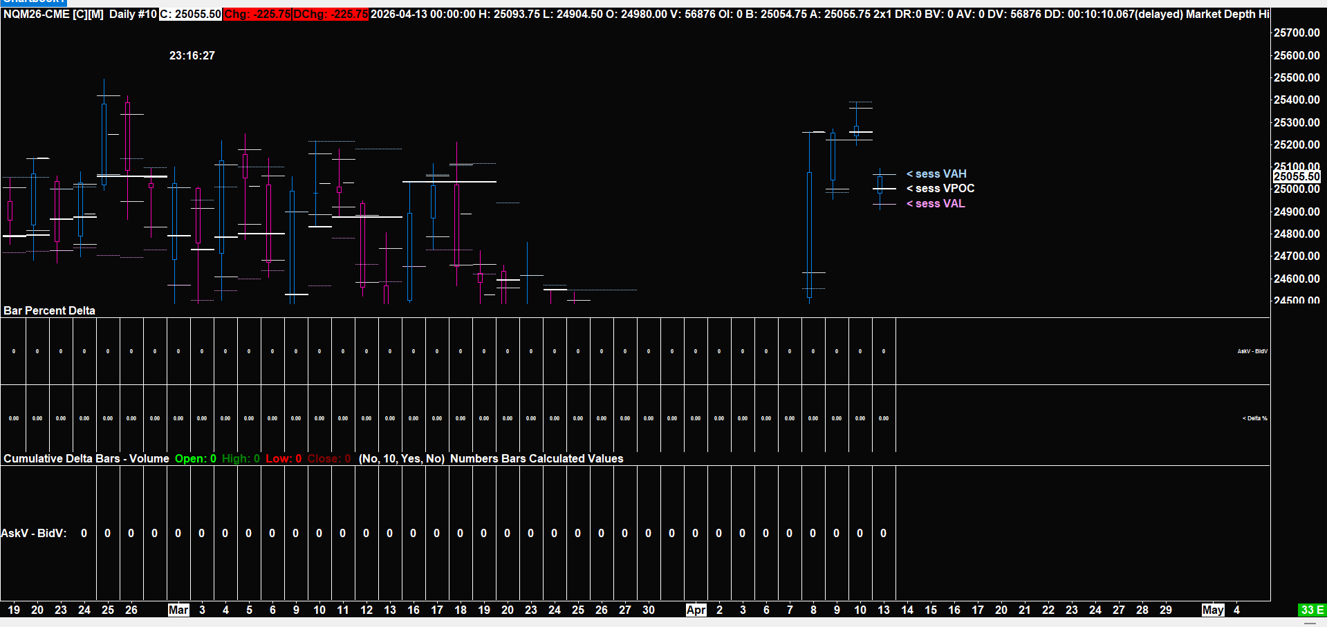

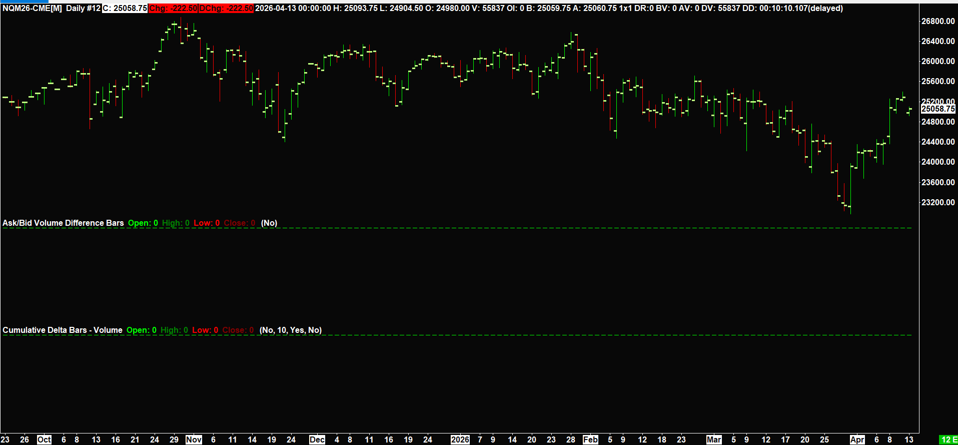

Hello Support Team
My Apologies in advance if this has been asked earlier, however i am facing the below issue
I am using Package 5.
I am not seeing CVD, Delta Bars, etc on my chart, what could be the issue?
Do i need to check any Chart Settings / Global Settings?
imageimage1-Sierra.png / V - Attached On 2026-04-13 04:43:16 UTC - Size: 37.46 KB - 114 views
imageImage2-Sierra.png / V - Attached On 2026-04-13 04:43:23 UTC - Size: 53.75 KB - 140 views
[2026-04-13 14:19:08]
Sierra_Chart Engineering - Posts: 25489
You need to use Intraday charts for those studies that you are using. A Historical Daily chart does not have the necessary data for those studies.
