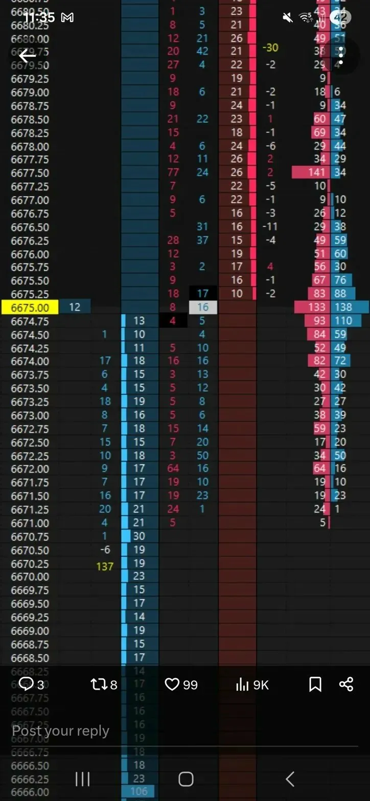

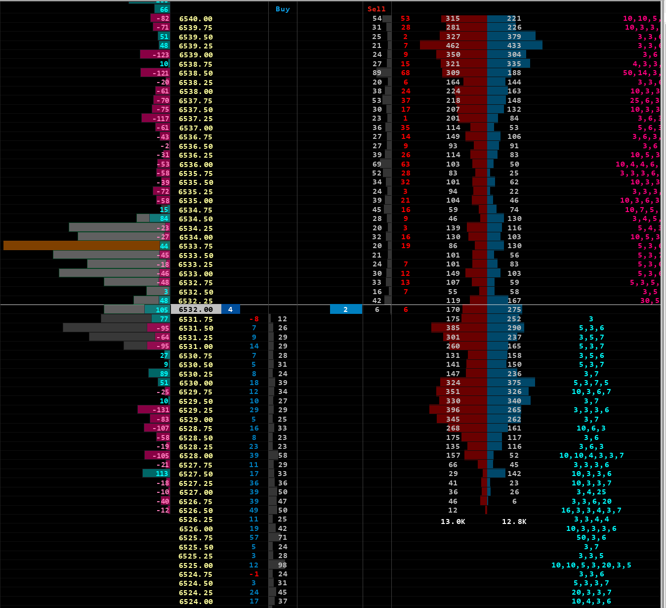

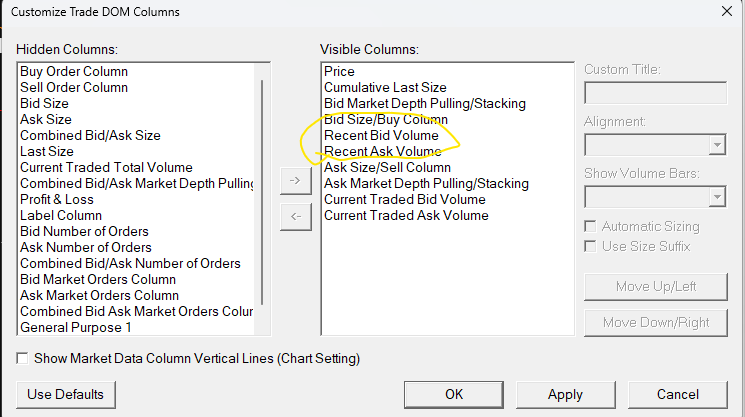

I am trying to replicate this dom, currently my dom shows everything except the middle which is Recent Bid Volume and Recent Ask Volume, only shows at current levels and not all levels even though i am subscribed to the highest tier on sierra chart MBO etc.. not sure what is the issue it used to show previously

If not the tick size, then the other item to check is the color setting for the "Recent Bid Volume" and "Recent Ask Volume" and make sure these are not set to be the same as the background. Refer to the following and the item below it:
Customizing Fonts, Colors, Line Styles, and Widths for Chart Trading, Chart DOM, and Trade DOM: Chart DOM Recent Bid Volume

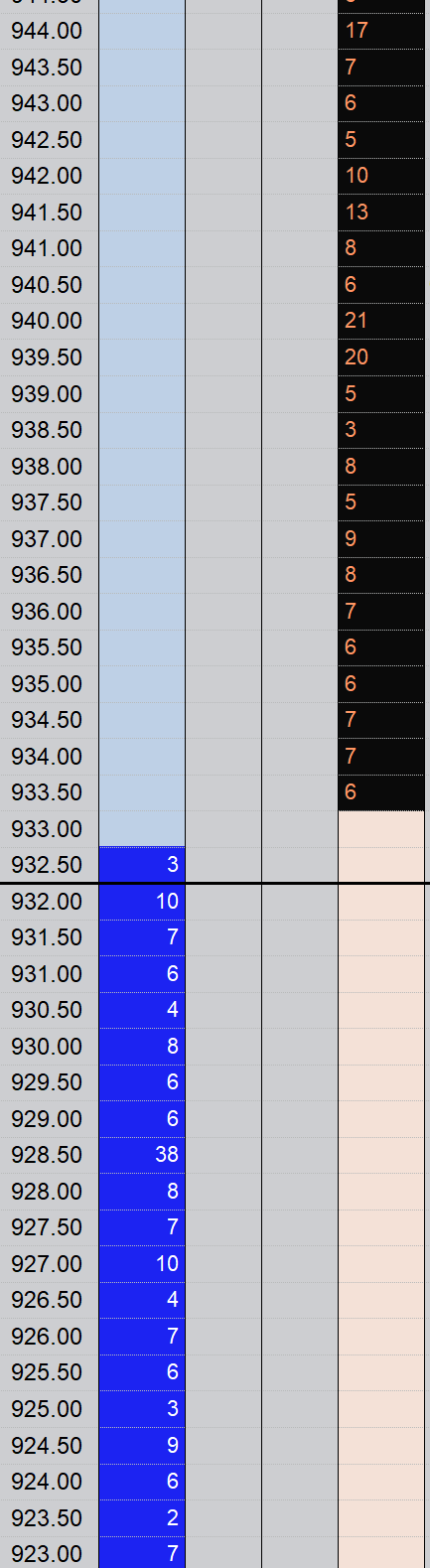

Will that bug be fixed, because before I had my DOM on a 1 pt compression and combined increment in ticks enabled, now using the method you have posted, my recent bid ask is now not lined up with my gridlines, and my volume profiles won't increase in tick size.

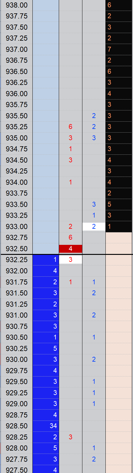

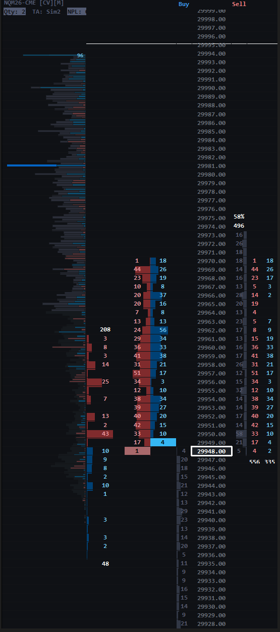

John, your suggestion to "change the tick size back to the default for the symbol you are using" is not a workable solution for 2 reasons: (1) the whole point of changing the tick size is to show fewer price levels, and (2) the "ticks per volume bar" setting cannot be changed to anything other than "1" on a VbP on a trade DOM.
The way it worked before is perfect, this just seems like a bug that was inadvertently introduced.

User431178 - Posts: 910
Follow the exact steps listed in the post above, then adjust the scale and grid to match.
If you had ticksize set to 1.0 (for 4 ticks) then set:
- Volume At Price Multiplier (in chart settings) to 4
- Market Depth Combine Increment to 4
- Scale Range to 4x what normally fits in the window
- Scale Increment to 1.0
- Horizontal Grid Line Increment to 1.0
You have fewer price levels, i.e. round numbers, and VBP is automatically matched.
It works, I am looking at an NQ chart combined into 1pt increments now.
@User431178
Thank you for this. It's a lot to change for what was once a single setting, but it actually makes my custom study which changes tick increments on the DOM simpler.
Orders are still allowed at the original (more granular) tick increment (0.25 in our example). Some might call this a feature, and I guess it could be useful.
