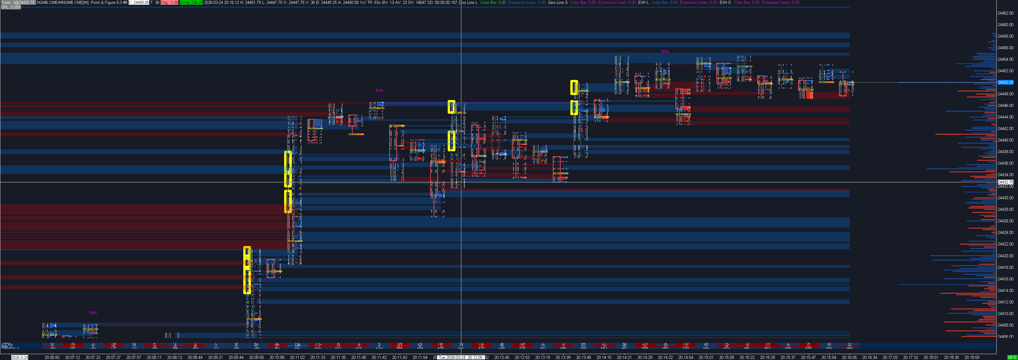

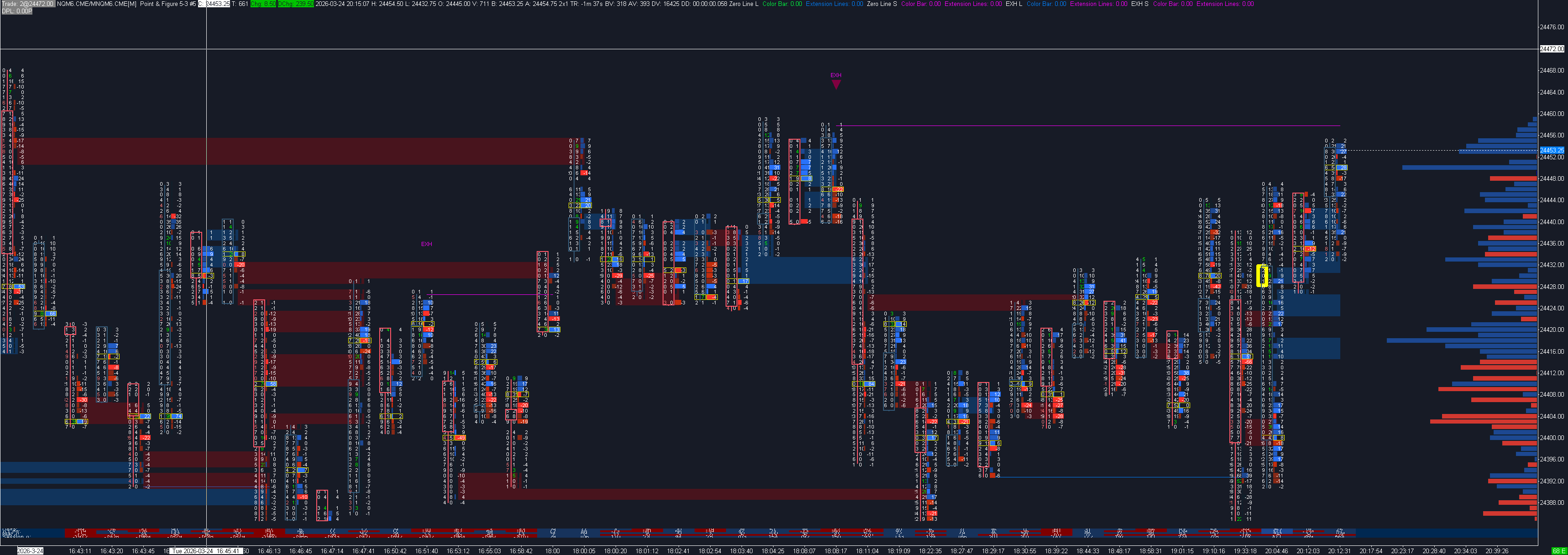

I'm trying to duplicate a chart and when i do all the values, numbers and etc are gone and gives me single digit numbers.
https://www.sierrachart.com/image.php?Image=1774397709222.png
https://www.sierrachart.com/image.php?Image=1774397777463.png

Did you do anything other than duplicate the chart? In particular, did you change the number of days to load, or any specific settings in the Chart Settings (particularly "New Bar at Session Start")?
One of the things we find odd is that the times for the bars are different, which they should not be if the chart was just duplicated.
As to the display itself, we wonder if it is just a scaling issue. Is the duplicated chart displayed on a different monitor with a different screen resolution? If you work on the scaling so that you can view the numbers properly, how does it look?
Refer to the following for scaling the Numbers Bars chart:
Numbers Bars: Scaling a Numbers Bars Chart
[2026-03-25 18:47:49]
User291819 - Posts: 8
Did you do anything other than duplicate the chart? In particular, did you change the number of days to load, or any specific settings in the Chart Settings (particularly "New Bar at Session Start")? -- No, i just did hit duplicate chart within the same chartbook and also tried to do the same to different chartbook.
One of the things we find odd is that the times for the bars are different, which they should not be if the chart was just duplicated. --> I haven't changed anything. Just dupilcate chart and then it came like that.
As to the display itself, we wonder if it is just a scaling issue. Is the duplicated chart displayed on a different monitor with a different screen resolution? If you work on the scaling so that you can view the numbers properly, how does it look? --> I tried with the same monitor and also to different monitor. It has the same issue. When scaling, i can see the numbers but it's all wired data.
I'm going to look more into studies and see if something changed. But i believe something has changed when hitting the duplicate chart which shouldn't. If i happen to see something will let you know.
