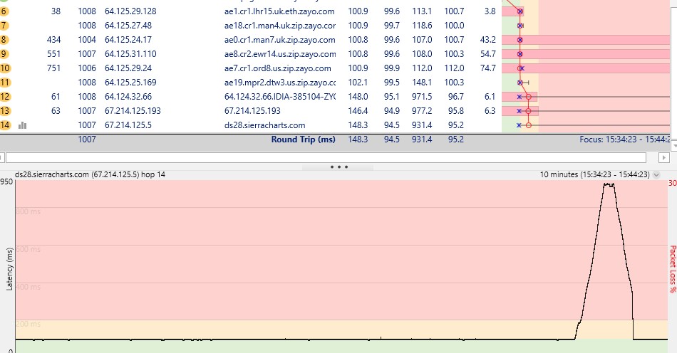

been happening a few times recently but long hangs this morning.
tried a ping plot but only had ds28 saved bu it showed problem, see attahched ping plot. This happened at the same time as SC DATA freezing/hang
I'm UK.
SHould I try a different server?
imageScreenshot 2026-03-23 154630.jpg / V - Attached On 2026-03-23 15:49:31 UTC - Size: 90.94 KB - 136 views

If you have not exited from Sierra Chart since you had that issue, then please get us your Message Log by following these instructions:
And please give us the time that the issue you are referring to occurred in the Global Time Zone that Sierra Chart is set to ("Global Settings >> Time Zone").

Based on the response from Interactive Brokers about "Market data farm connection is inactive but should be available upon demand.usfarm.nj", it looks like you lost the connection to Interactive Brokers at that time.
Even if you are setup to get data from our Denali Exchange Data Feed, if you can not connect to your selected trading service, the data will also stop.

You also lost the connection to the Denali Data Feed:
2026-03-23 11:44:08.251 | External Service | Denali Data Feed | There has been no activity on the network socket for 1m 5s. Will reconnect.
So that explains the disruption with other instances as well.
