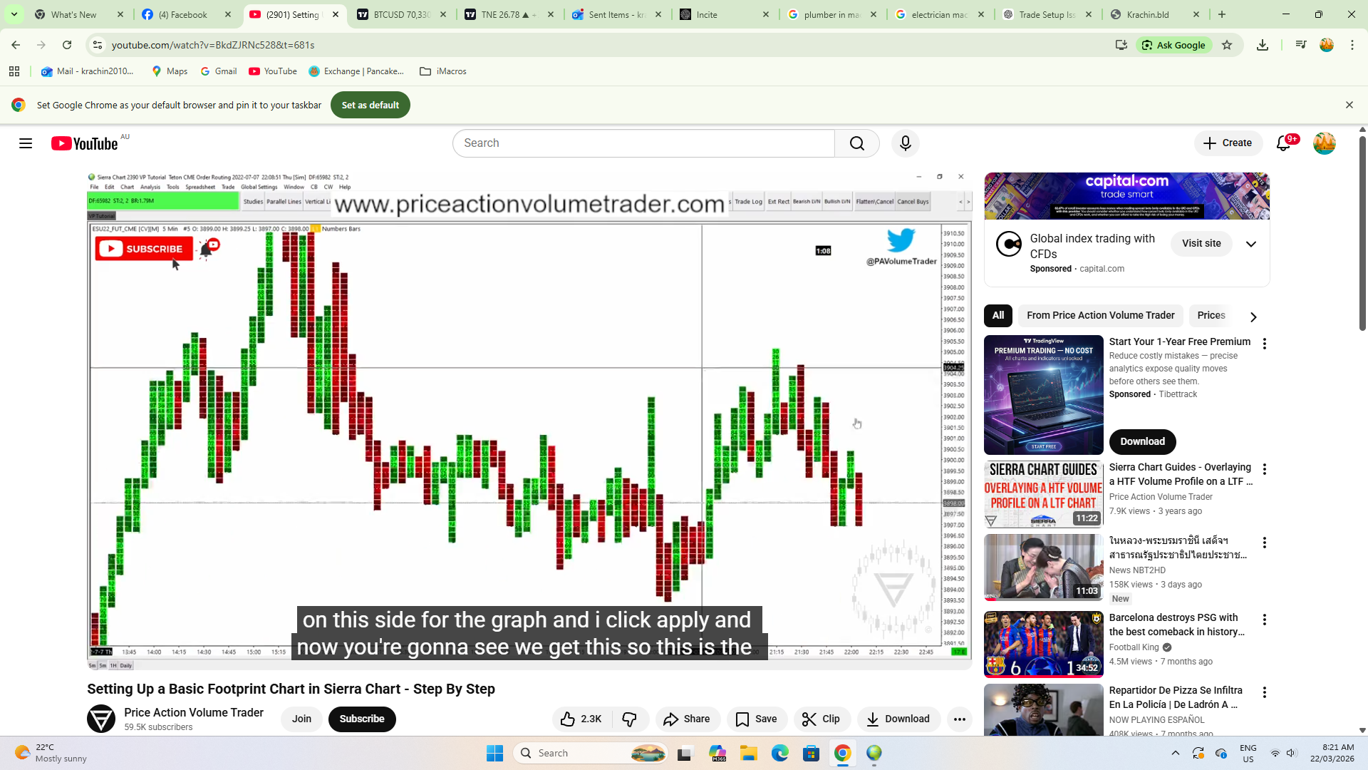

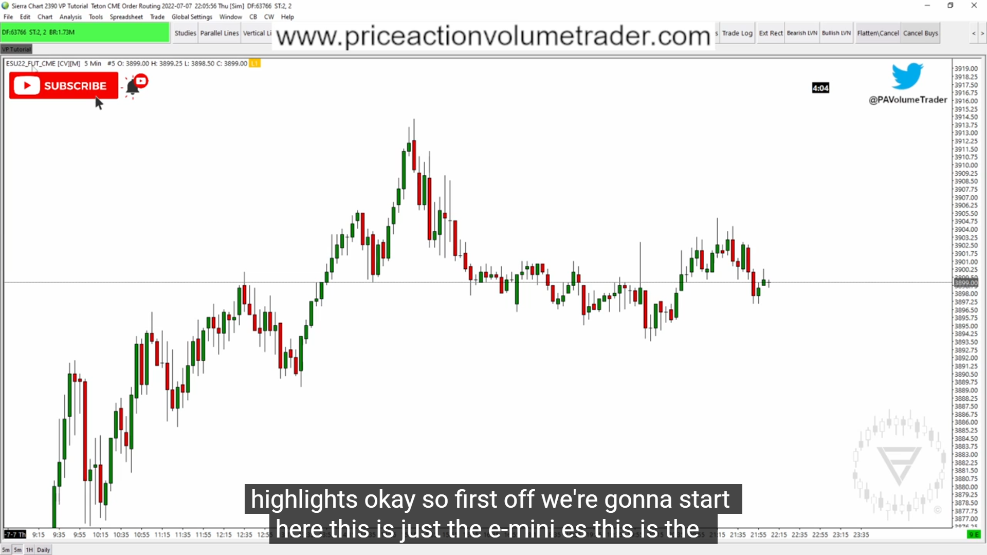

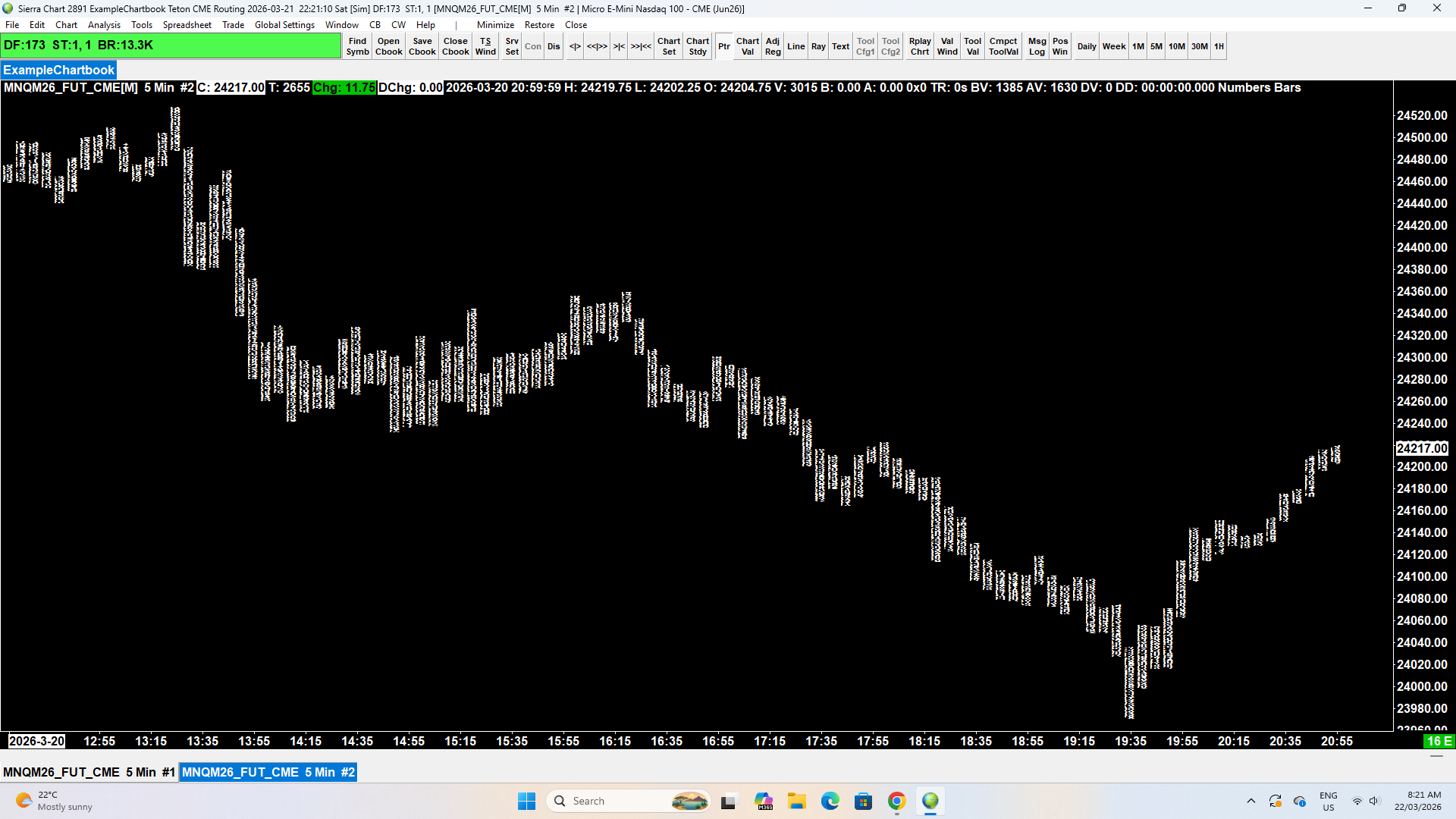

why in chart setting does not have numbers bars and after apply number bars in study mine one look blurry can not see numbers and no color but youtuber can see numbers and look clear if i can see nu mber clear like youtuber should set up easy what wrong i been used without see number more than a month already now i need to fix properly can you reccomment what i have to do been try many many times already screenshots number 129 sierra chart and youtuber the same candle sticks then after study number bar then apply look different from sierra chart number 131 and youtuber 132 only start from step one diffence already if step 1 as same as youtuber the rest will be very very easy please help me fix thank you
imageScreenshot (129).png / V - Attached On 2026-03-21 22:35:52 UTC - Size: 583.74 KB - 158 views
imageScreenshot (131).png / V - Attached On 2026-03-21 22:36:14 UTC - Size: 204.94 KB - 158 views
imageScreenshot (132).png / V - Attached On 2026-03-21 22:39:17 UTC - Size: 1.05 MB - 153 views

This is not how this works. As you have found, the Numbers Bars is a study, not a chart type.
The first issue is that you need to adjust the scaling in order to view the numbers in the Numbers Bars study. Refer to the following:
Numbers Bars: Scaling a Numbers Bars Chart
The second issue, as to color, is that you do not have your Numbers Bars study setup for what you want. If you want to see coloring, then you need to set an options for the "Column 1 Background Type" and "Column 1 Background Coloring Method". Refer to the following and the section below it:
Numbers Bars: Column # Background Type
The Numbers Bars study is a complex study. You need to work through it slowly to understand what you are doing and how to get what you want. If you are watching a YouTube video, then you would need to follow what they are doing, or understand how they are accomplishing what they are doing.
