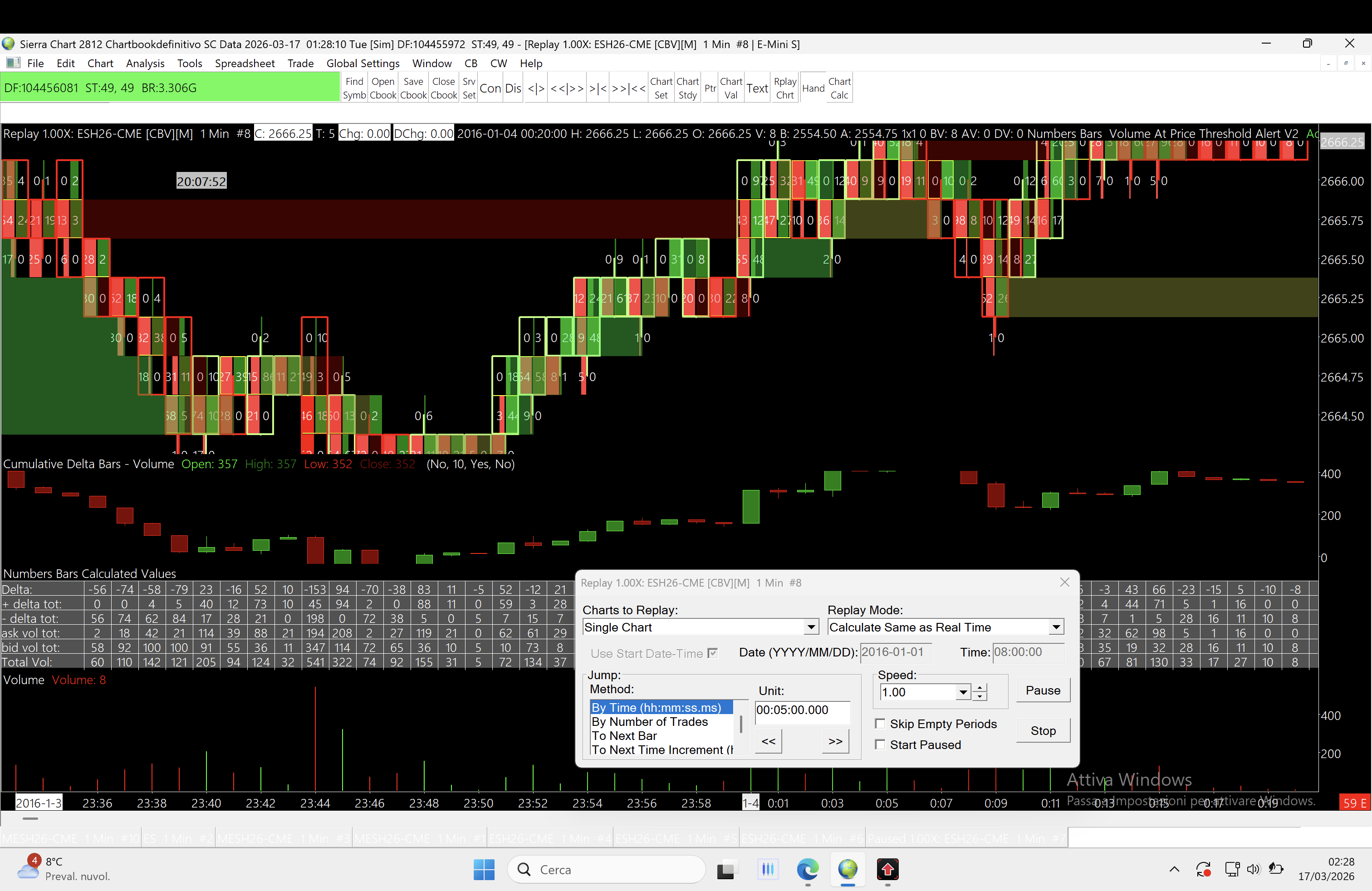

Good evening, sorry for the late message. I'm supposed to backtest the S&P 500 in 2016, and I'd like to know if my method is correct (including whether the candlestick data is accurate or not) or if I need to revise a few things. Thank you very much in advance.

imagesierrachart screenshot.png / V - Attached On 2026-03-17 15:40:14 UTC - Size: 552.77 KB - 198 views

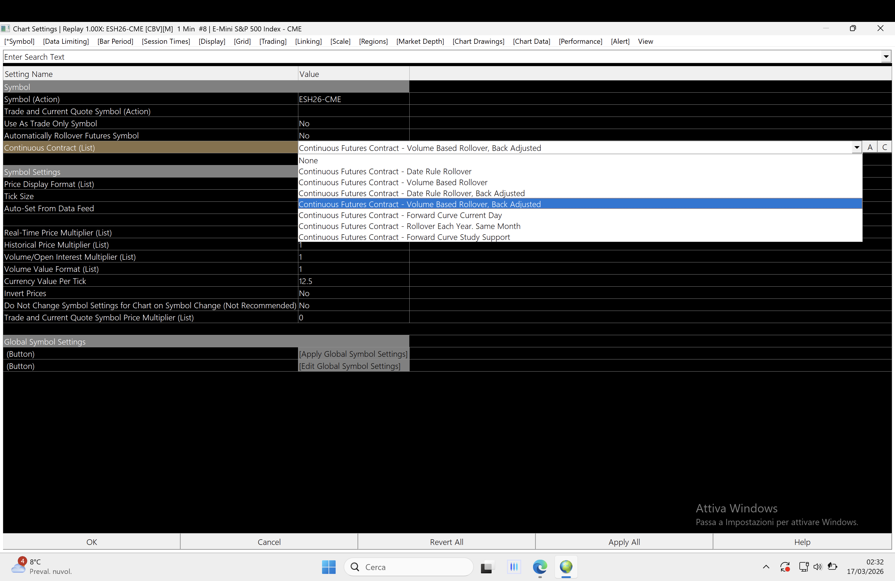

imagesierrachart screenshot 1.png / V - Attached On 2026-03-17 15:40:54 UTC - Size: 335.67 KB - 176 views

We are not really understanding what you are asking.
The choice of a Continous Futures Contract method is up to you. Just understand that a Back-Adjusted chart has the previous contracts data adjusted up or down to match to the next contract, so the data will NOT be the same data as in 2016. Refer to the following:
Continuous Futures Contract Charts: Continuous Futures Contract Rollover Options
The choice of how to backtest is also your choice. Refer to the information on the following page for the options:
Auto Trade System Back Testing
