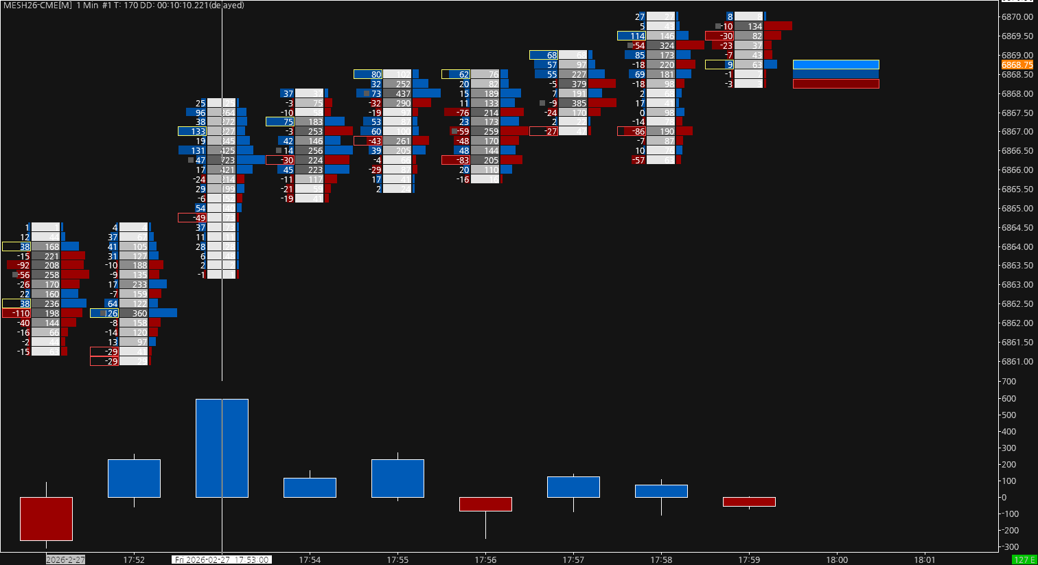

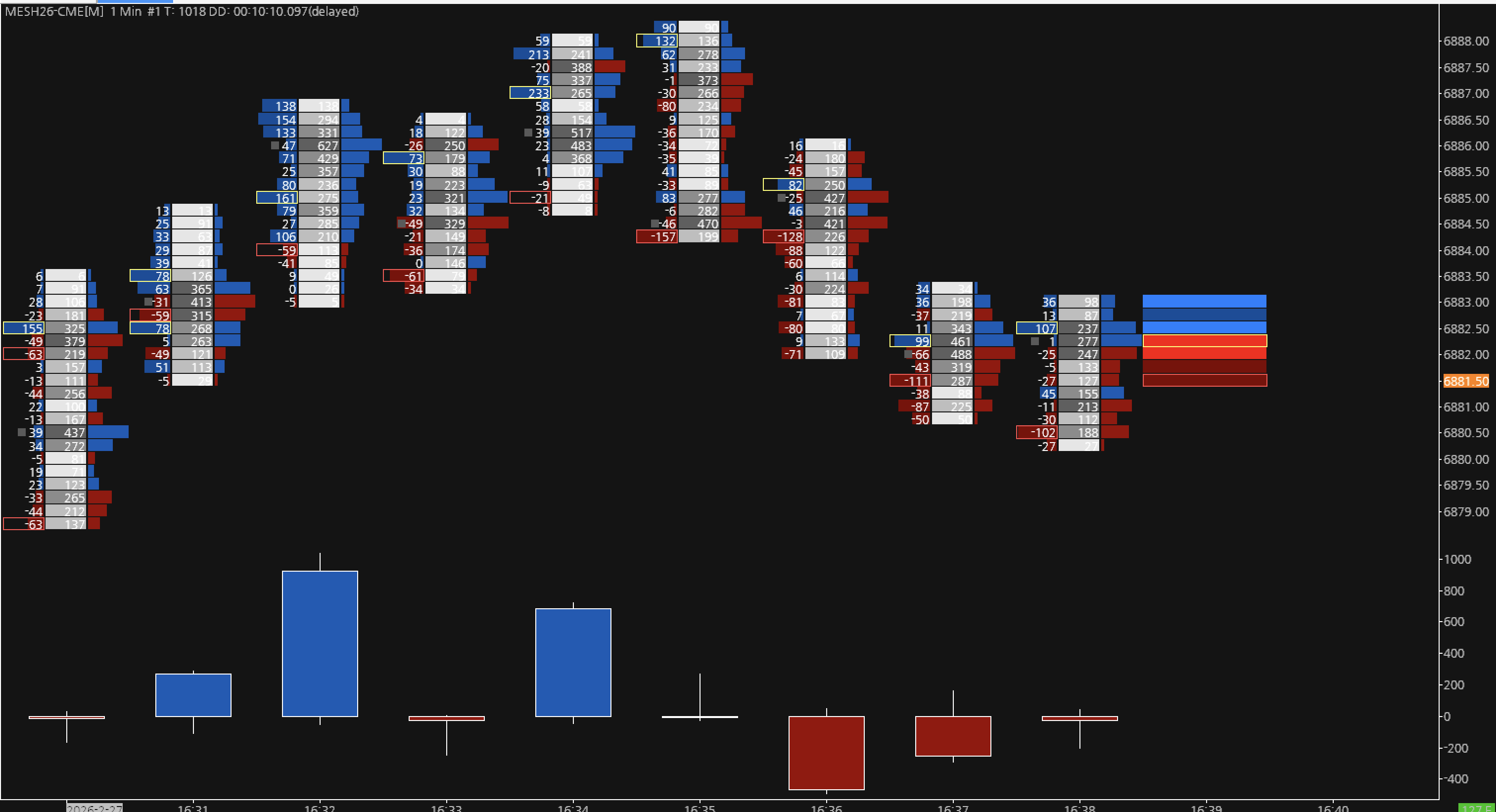

How can I remove the boxes that keep appearing to the right hand side of every current/ new candle?
Thanks!

Our best guess is that you have an option set for the "Pullback Column" in the Numbers Bars study. Refer to the following and the 3 items below it:
Numbers Bars: Pullback Column # Numbers Bars Text

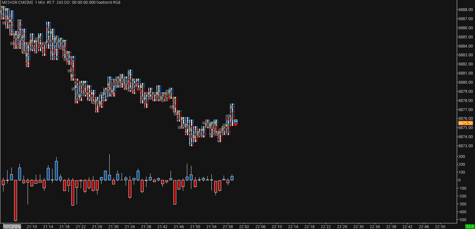

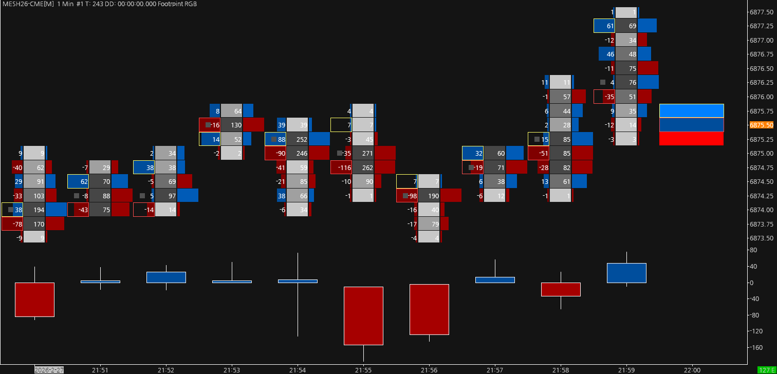

If I open my chartbook and use the same exact saved study on a new chart for the same exact symbol and period it looks entirely different visually... Why? How can it be resolved? Thanks.

Get us the chart that has those boxes to the right so we can see what it is that is causing it. Follow these instructions to get us the chart:
As to the differences between charts, that is a scaling issue. Refer to the following:
Numbers Bars: Scaling a Numbers Bars Chart
