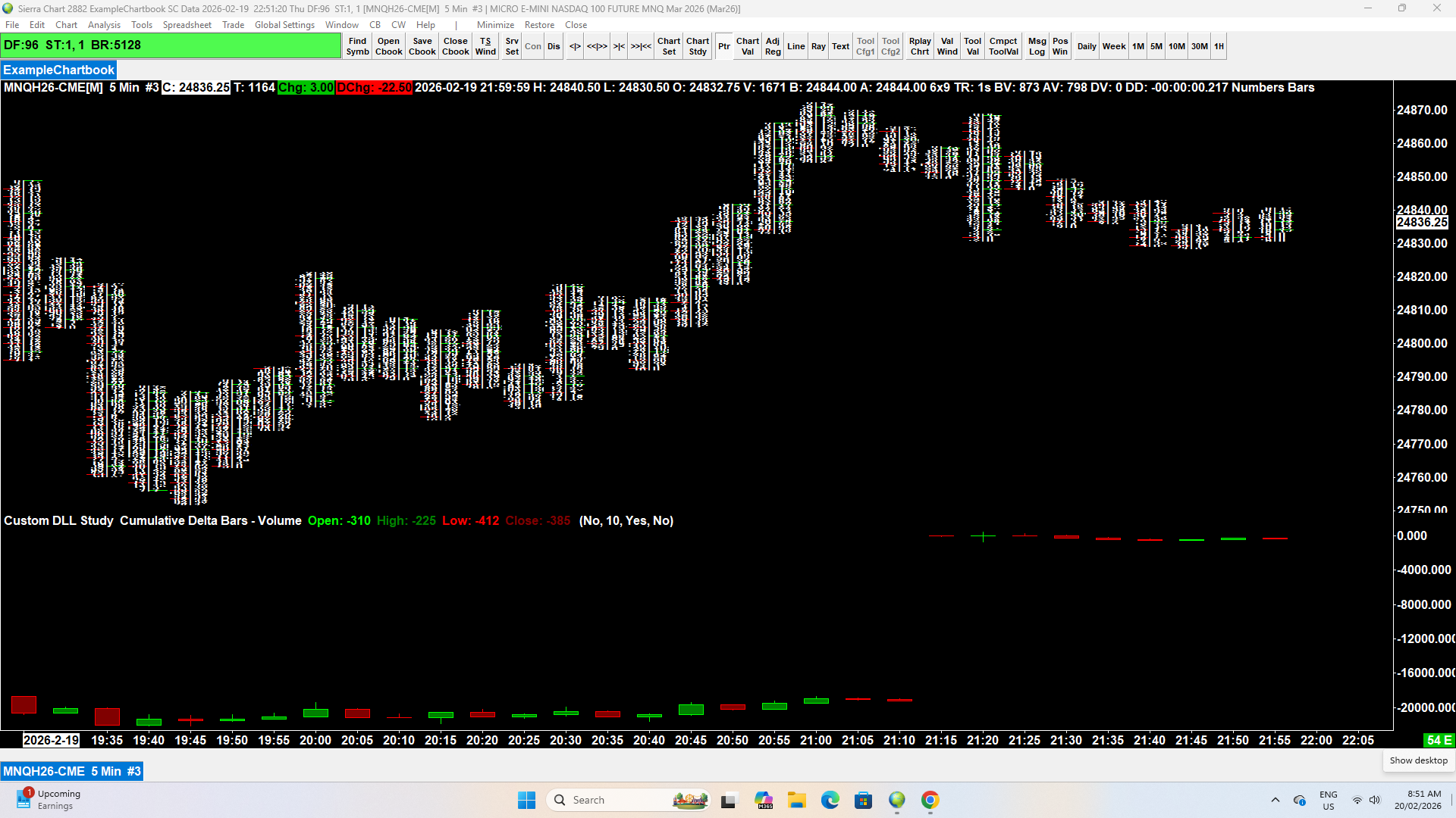

i am using number bars on mnq march contract with denali data on a 5 minute chart
the issue i am experiencing
1 when i scroll the chart to the rightsid the number bars text become unclear or compressed
2 delta numbers are not clearly visible inside the bars
3when i move the chart to the left side the numbers appear clearer
4o jave a;ready switched to the correct march contract
5 i have adjusted bar scacing and text size but the isssue remains
could you please advise the correct configuration for
numbers bars settings
scaling settins
bar spacing
recommended setup for mnq footprintchart
i have attached screenshots of the chart and setting thank you

This is a Scaling issue. You need to adjust your scaling for the Numbers Bars as you move the chart around. There is no other solution.
We have answered this multiple times already. Please do not continue to post this question.

try many way already still can not see number and delta number can you help to fix

You need to increase your bar spacing, so you have more space between the numbers horizontally, and then you need to expand the vertical scale to change the spacing vertically.
You may also need to adjust the size of font used for the numbers.
This is all explained in the following link, which we have given multiple times:
Numbers Bars: Scaling a Numbers Bars Chart
If you need one-on-one help with this, then contact one of the people at the following link:
Sierra Chart Personal Assistance
