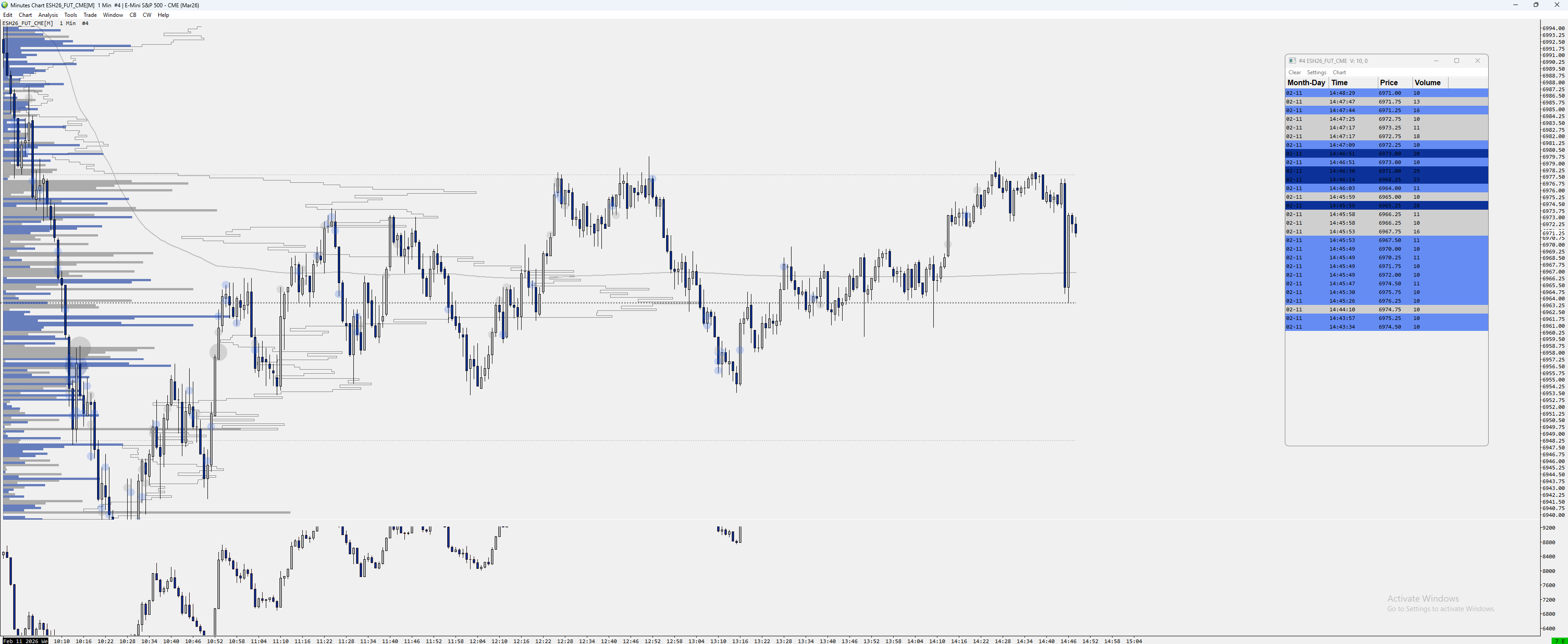

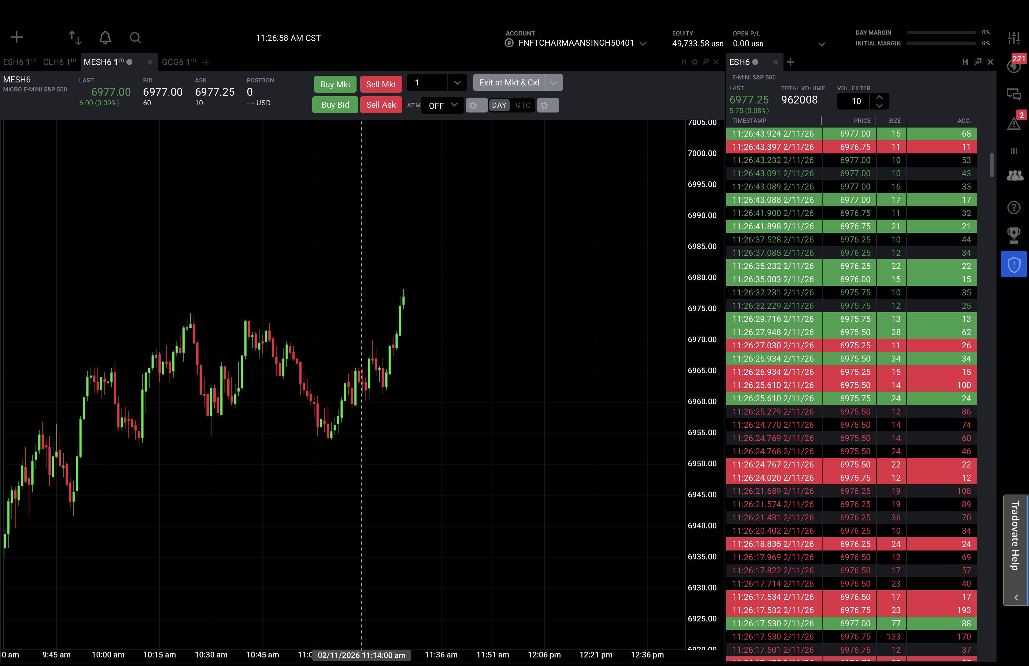

ArmaanSingh - Posts: 23
I attached the screenshot and you can see that there is huge difference. Even on 1 minute candle that formed. It showing the orders coming with volume more than 10.

[2026-02-11 19:25:16]
The images you show have the ESH26 data from Sierra Chart, but the MESH26 data for the other system.
Also, the times are not aligned, so even if we could compare, there were only a few lines covering the same time period.
And make sure that you are not using any filtering on the Time and Sales within Sierra Chart or any combining. Or if you are, you would need to ensure that both systems are doing the exact same thing with the data.

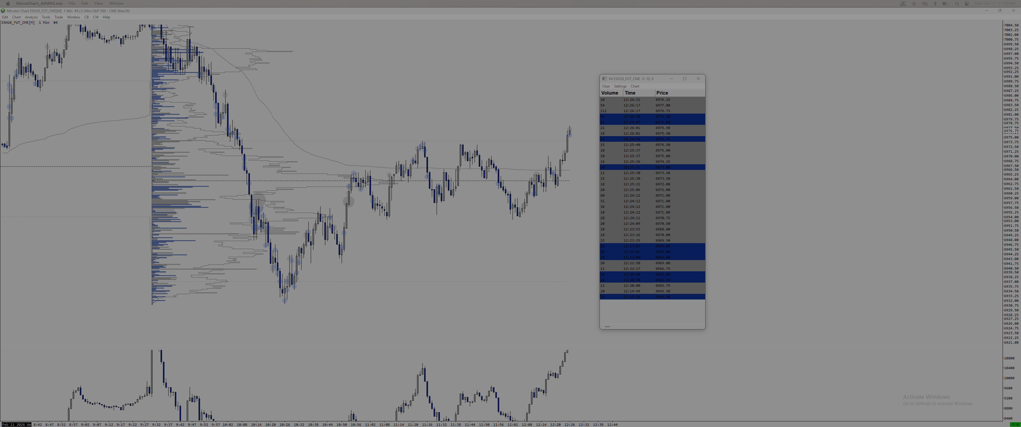

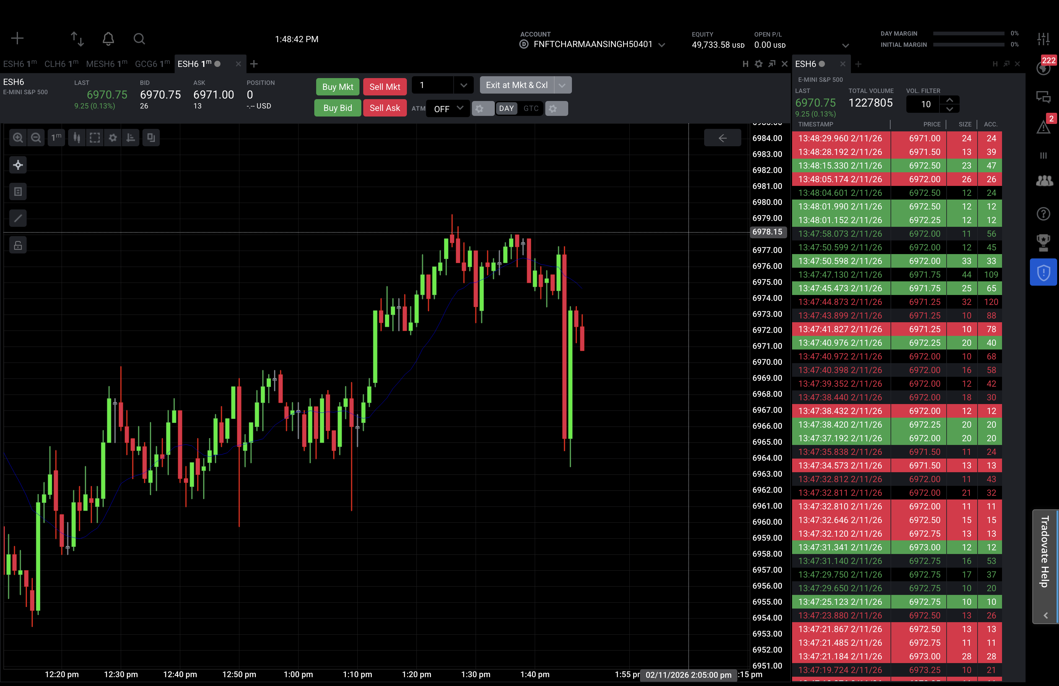

On tradovate and sierra chart BOTH, Filter is set to show trades with more than 10 contracts. And I double check that option is set to DO NOT COMBINE within Sierra chart. And Secondly, on tradovate, I do opened the MES chart, But it showing the tape for ESH not the MES one, You can see its written at the top of the time and sales window
Lastly, I set both charts to one minute, and blue colour represent selling, and grey is buying. And I cannot able to change the time zone of tradovate to New York, as they have just limited time zone settings. But my Sierra chart one have New York time zone. SO WHEN LOOKING AT TAPE OF BOTH CHARTS, YOU HAVE TO COMPARE WITH SEEING MINUTES NOT THE HOUR. As the minute is same for both charts.
And I do think so this is the serious matter for your platform, that you might have to look deeper into, will look forward for your response

[2026-02-11 23:15:09]
Sierra_Chart Engineering - Posts: 25484
You need to remove this filter:
You must remove the filtering from both sides. This is mandatory before you even begin to do comparisons. That is the very first step. We cannot provide any further analysis until that is done.
It could be that what you see, with the other program is combined trades. Not the individual trades which are part of a larger summary trade. There are fine details involved, with filtering that may not be well understood by you.
We guarantee there is not a problem.
There is simply no chance of this.
