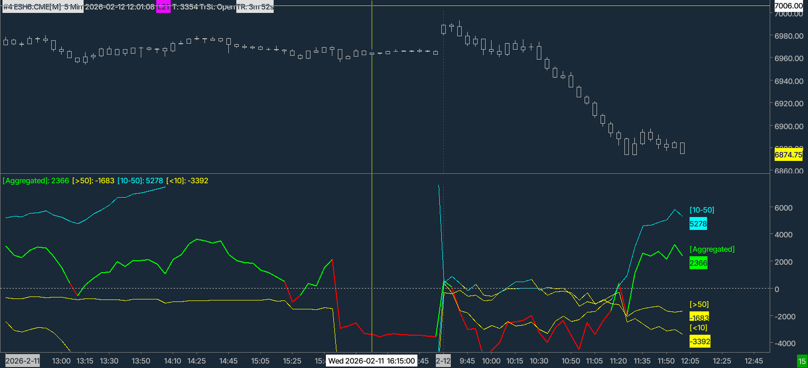

[2026-02-12 17:21:38]
Brookwood - Posts: 45
I don't know if this is what the OP is looking for exactly, but I made this chart based on a mistake I made where the filtered volume of the chart was set to filter trades based on size.
It uses the multiple filtered Cumulative Delta Volume studies overlayed on a master chart which is linked so the sub-charts follow the master.
You can manually adjust the subgraph height to show only the chart values for at-a-glance numeric info.
The sub-charts are hidden by default.
https://www.sierrachart.com/image.php?Image=1770915669248.png
Date Time Of Last Edit: 2026-02-12 17:42:31
attachmentCumulative Volume Delta [Filtered] - Copy.Cht - Attached On 2026-02-12 17:39:25 UTC - Size: 17.84 KB - 146 views

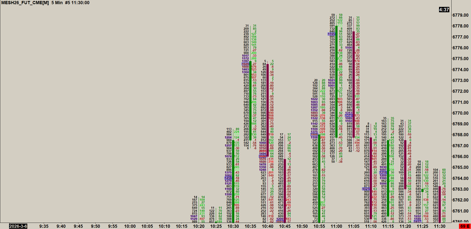

[2026-03-09 01:53:03]
User654358 - Posts: 14
This is an option that might work for you.
Left column = Volume
Right column = Delta
https://www.sierrachart.com/image.php?Image=1773020724541.png
