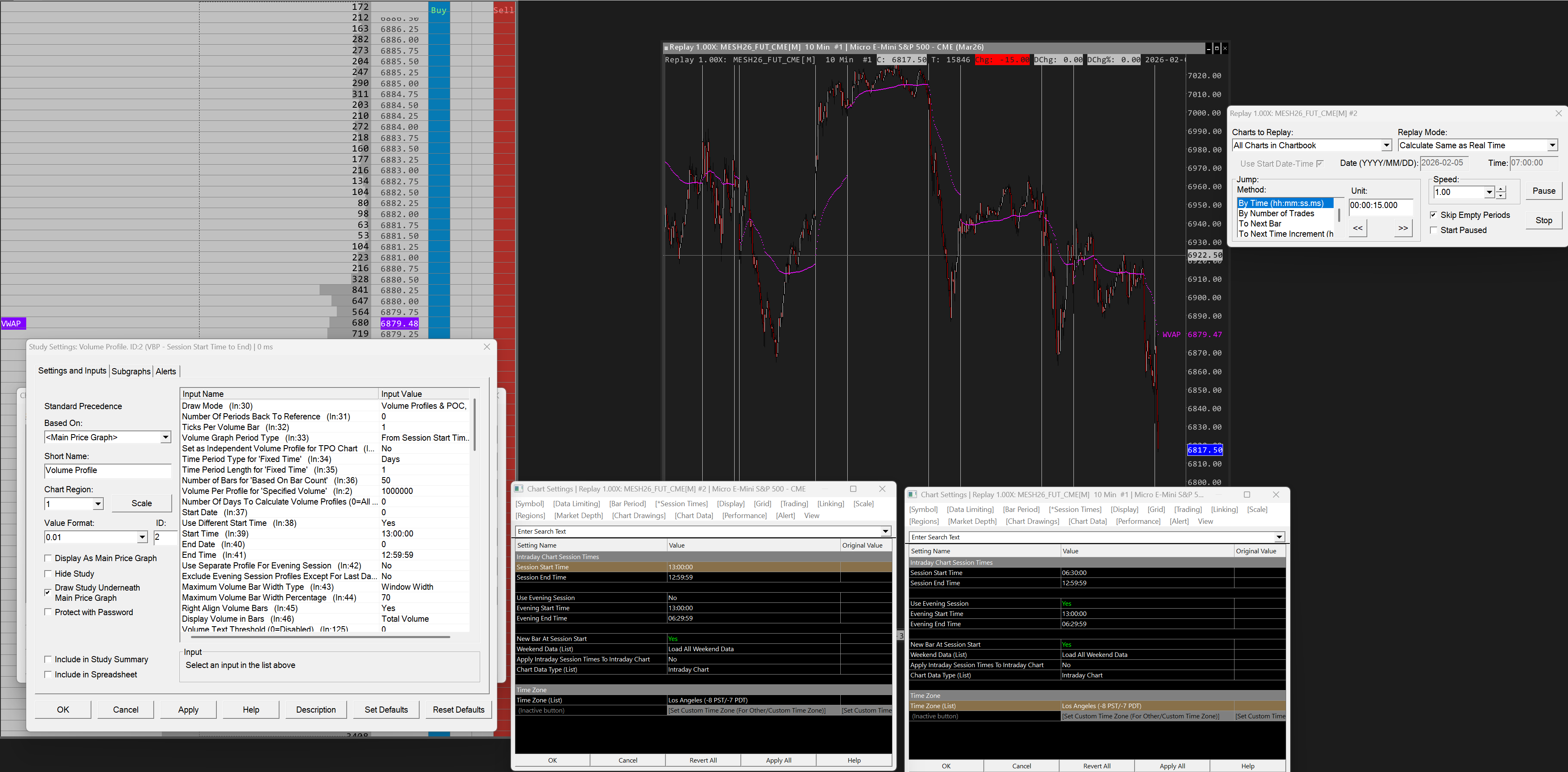

User719512 - Posts: 548
I changed time zone to PT so I could mentally process the times...
Looking at your 10m chart, I can see the Day starts/resets at RTH/Cash close which is 1300 PT.
I changed the DOM VbP to use that session time, made it a 10m bar period chart as well to match the other chart, and set DOM VbP for the corresponding time to match the 10min chart via Use Different Start Time and you can see the values match (one changed by .01 when I took a screenshot).
So this is one way to make them match. This may or may not capture the exact period you want, but you can see how the settings do let you line things up.
You will want to tweak the settings, sessions times, etc to see if these 2 studies will align in some other manner. Hopefully this is helpful.
I use custom studies for both VbP and AVWAP to give different flexibility like what I think you are after; the AVWAP that I use was created at least a year before Sierra made that study available natively as I recall.
imageScreenshot 2026-02-05 152126.png / V - Attached On 2026-02-05 23:33:12 UTC - Size: 527.06 KB - 179 views
[2026-02-06 00:37:42]
The very first thing we see when we look at these charts is that the 10 minute chart is set to be a full session (Use Evening Session is set to "Yes"), but the Trading DOM is set to only be Regular Trading Hours (Use Evening Session is set to "No"). This is what "User719512" is alluding to in terms of the Session Times that they changed.
We do not need to go any further. The point here is that you need to ensure that the charts and the studies are setup to be the same in order to get the same results.
