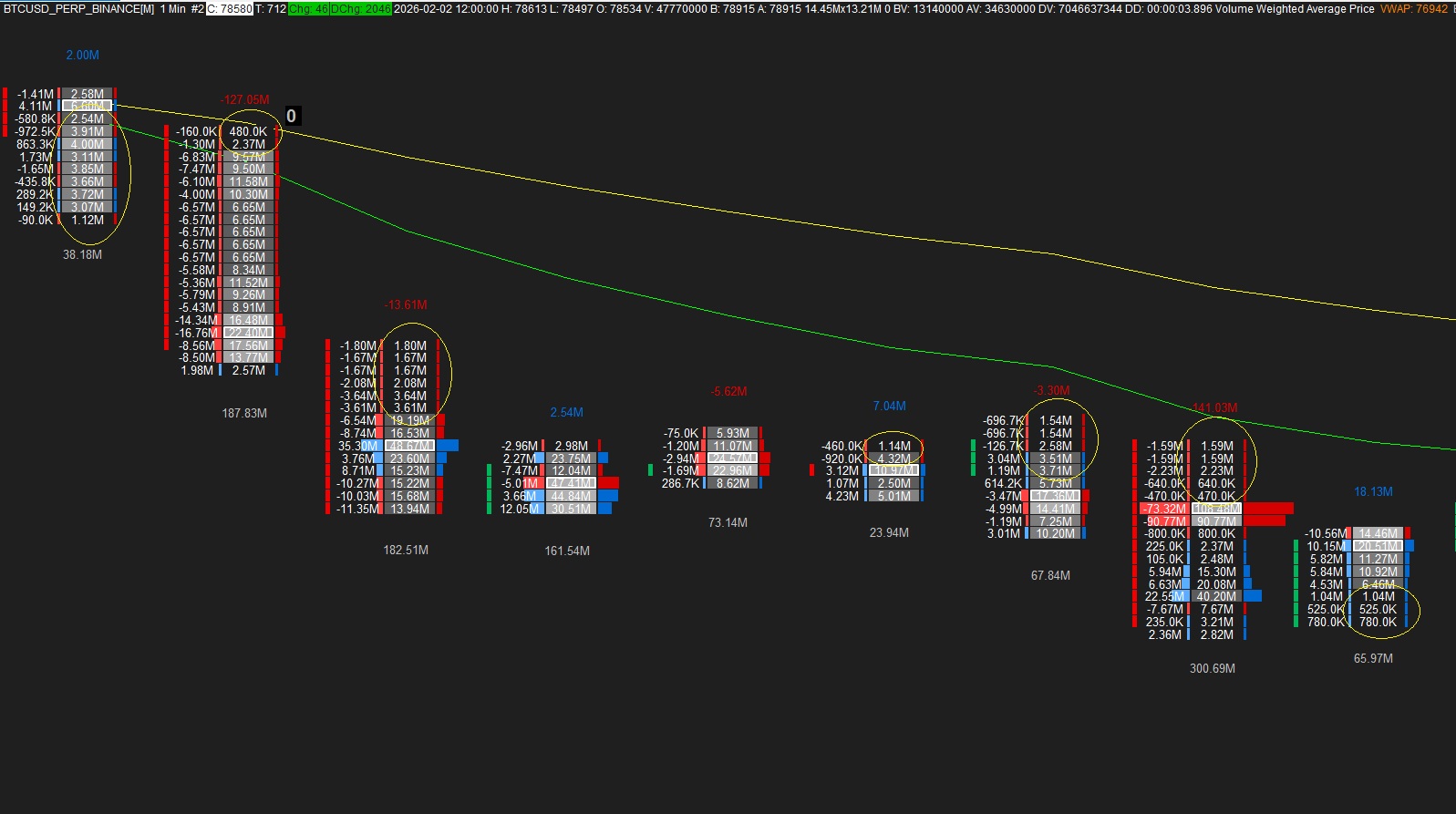

Hi, I am trying to filter my BTCUSD_PERP_BINANCE footprint chart to have a minimum order, but I am not having luck. I have tried various settings in the Number Bars studies area, and also in the Global Settings for the symbol, but nothing is adjusting my chart. If you see attached, I am wanting to set a 5,000,000 filter so all orders under this (for example those in the yellow circles in the attached) do not show on my chart. If someone could please help me locate this setting, I can then tinker with it to get it set to the value needed.
Also, maybe a simpler question, is there a way to remove the decimals from these values on my footprint chart, so that 5.30M, -127.05M, 411.03M, etc. are simply 5M, 127M, 411M? Thank you in advance for your time and response!
imageScreenshot 2026-02-02 122809a.jpg / V - Attached On 2026-02-02 17:31:07 UTC - Size: 239.96 KB - 171 views
Refer to the following:
Chart Settings: Volume Filter (Chart >> Chart Settings >> Data Limiting >> Volume Filter Settings menu)
Numbers Bars: Volume Display Multiplier
