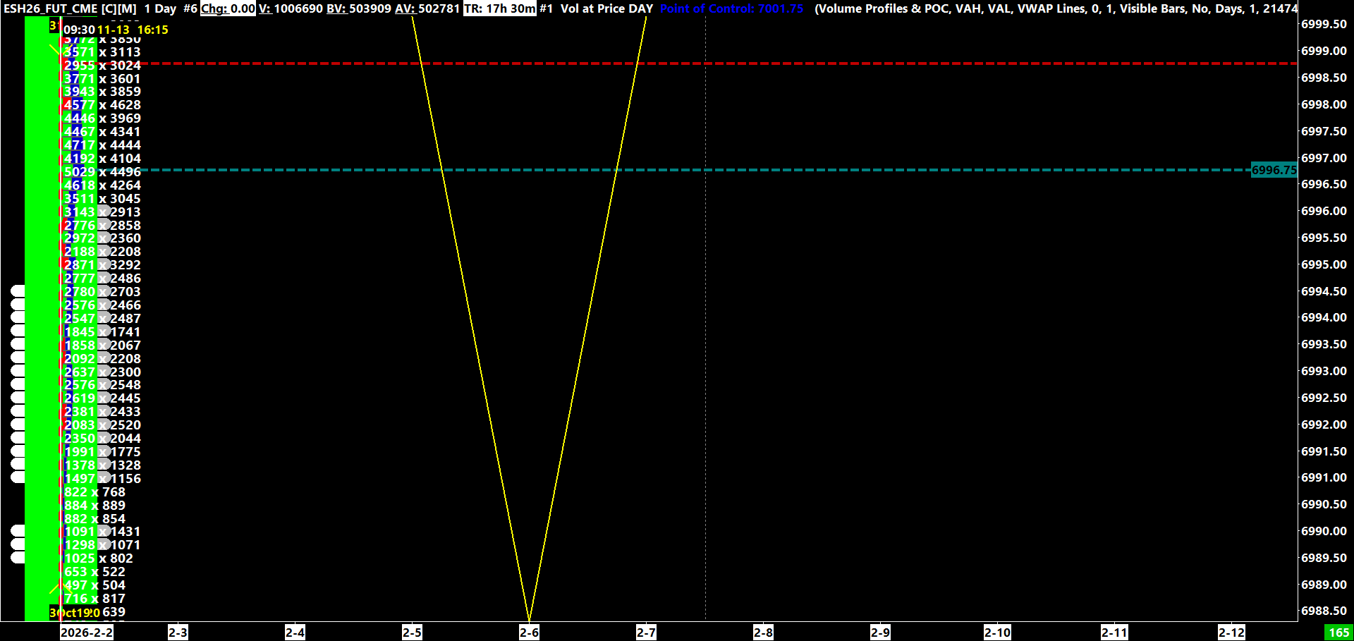

Yes, my chart is set to Intraday, and 1-0-0 Yes, I have tick data. See attached pic, you'll see the grey Rt arrows. In this case, Ask is set to 1000 You'll see that the grey arrow aren't on Ask >1000, nor are the less or equal. No rhyme or reason I can tell. https://www.sierrachart.com/image.php?Image=1769810538565.png Vol at Price settings are: (btw, these cant be screenshoted?) -Comparison method=ASK Vol -Vol Threshold=1 -Additional Vol Threshold=1000 Number of days to calculte=1 |

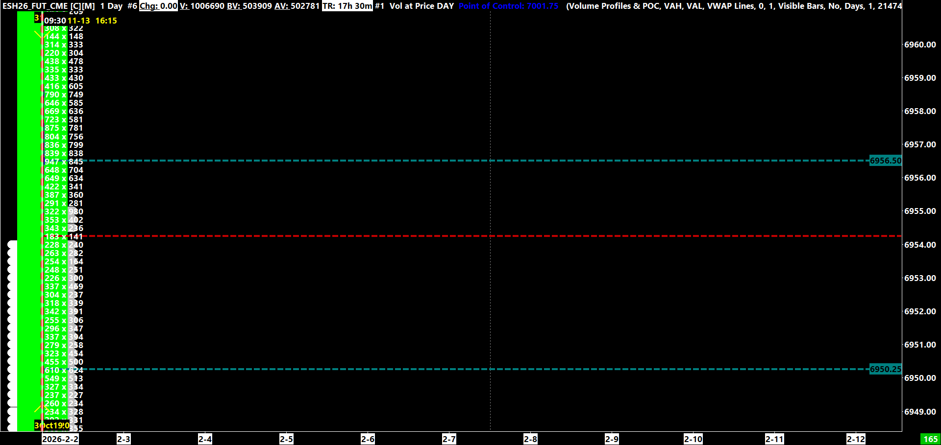

I think i misspoke on the Inputs.I switched the wording. It works, so I know its correct. Let me Clarify: For my Ask Levels >1000, the settings are Vol Threshold=1, and Additional Vol Threshold=1000 (shown as Grey Rt Bar at Level) For my Bid Levels > 1000, the settings are Vol Threshold=1000 , and Additional Vol Threshold=1 (Shown as Left Bar at Level. I realized awhile back that even though different color, if both Left Bars, if both Bid and Ask levels are >1000, I only see one arrow bc theyre stacked [unless I offset one]) So to clarify, the levels and everything are correct if I use it on a Multiple Profiles Based on Bar Count. But I want cumulative real time in RTH. To to that i would need ONE bar for the day RTH, Ive tried different settings and cant get the alert to work on ONE DAY. I currently have an interday chart with 1-0-0 I have the above alert settings. As you can see from the upload, the arrows are at over 1000 on some, but not all of them. (btw the White/Grey Arrows are "Draw Study Underneath Main Graph, but you can still see the ends) https://www.sierrachart.com/image.php?Image=1770075487185.png below if the alerts set to 150. As you can see again, no rhyme or reason. Most are above 150 Ask or Bid, yet only some have an arrow https://www.sierrachart.com/image.php?Image=1770076600677.png |
