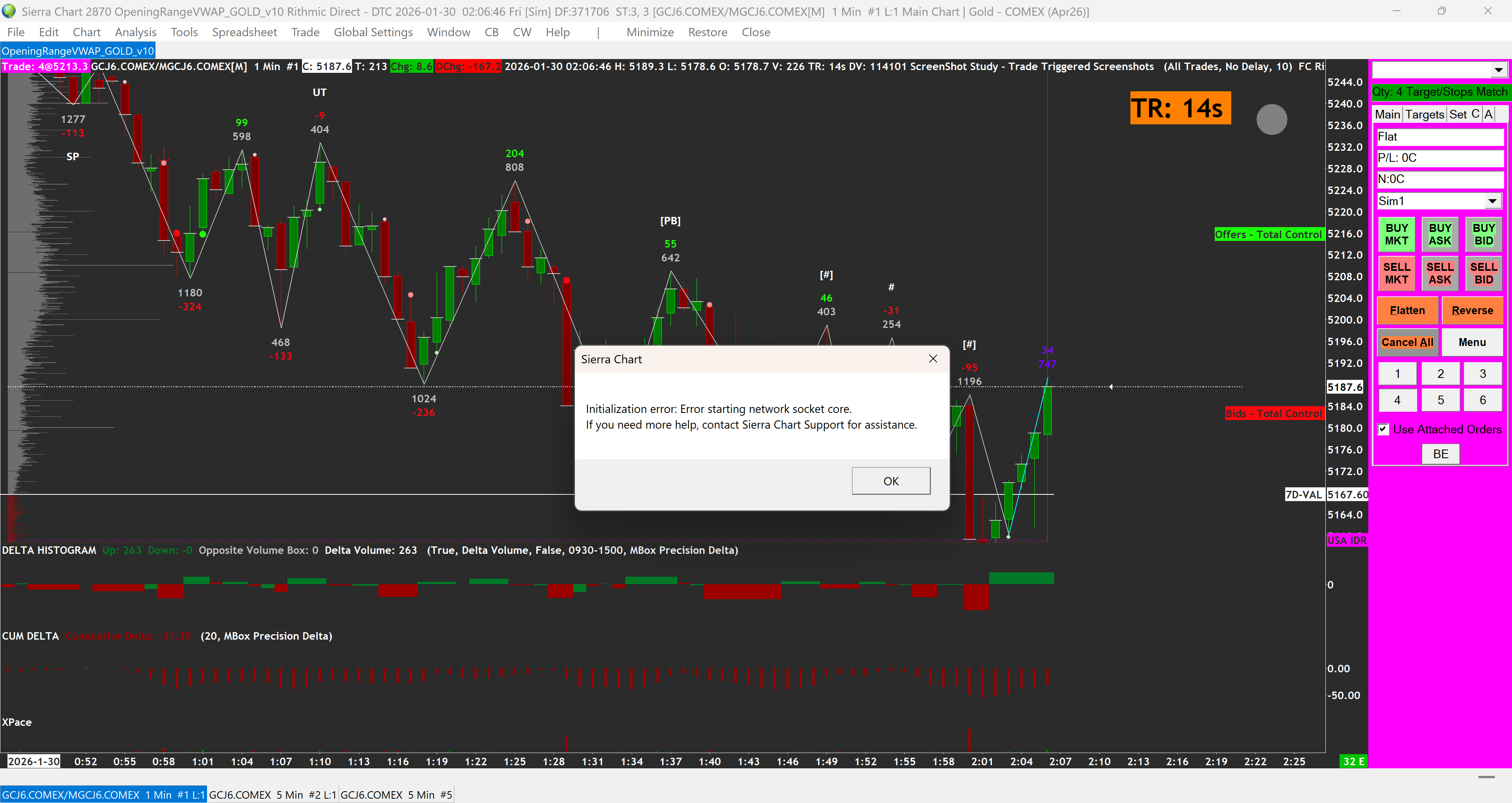

getting an error message:
New Instance: installation error
error starting network socket core; contact SC Support for assistance
please advise
imageScreenshot 2026-01-30 020649.png / V - Attached On 2026-01-30 07:10:58 UTC - Size: 318.35 KB - 211 views
[2026-01-30 07:31:12]
mlt124000 - Posts: 63
oh wow.... now i am getting the same message just open SC --- help?!
[2026-01-30 07:55:20]
ok update:
i performed the Restoring Backup Global Configuration File, and now i can open my main instance [again]... but still get error message for sub instance

[2026-01-30 08:54:04]
and now again.... main instance getting the error message
update: i did the copy/paste deleted the backup files again and can access... BUT why does it keep happening?
Date Time Of Last Edit: 2026-01-30 08:56:57
[2026-01-30 09:03:35]
update:
reverted to 2798 and now issue resolved...
[2026-01-31 21:26:56]
Sierra_Chart Engineering - Posts: 25432
We have never seen that error message before, that you posted in the first post.
It should not be happening. What operating system are you running Sierra Chart on?
We do not see how this is specific to newer versions. We have absolutely no one else reporting that and there are no changes related to the network socket core.
[2026-01-31 23:15:48]
Windows 11
[2026-02-01 07:42:23]
We know what the reason for the network socket core error is. It is actually an OpenGL error instead. This will be resolved, this Sunday with the release of 2874.
Date Time Of Last Edit: 2026-02-02 22:26:32
[2026-02-02 22:25:54]
This is still not resolved but we expect it will be resolved with version 2875.
