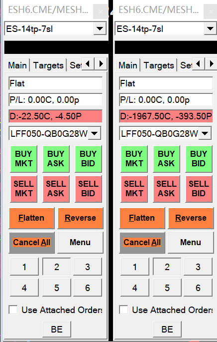

[2026-01-22 19:42:46]
Flowdity - Posts: 74
same symbol, with chart linked, the left one is correct
this is same symbol MES, with chart linking.
https://www.sierrachart.com/image.php?Image=1769110928892.png
imagedownload.png / V - Attached On 2026-01-22 19:38:04 UTC - Size: 25.63 KB - 214 views
[2026-01-22 19:52:52]
Then the "Order Fills Start Date/Time" or the "Start Time for Trades List" is not correct for the chart that is incorrect.
Please go through the items at the following link:
Help With Daily Profit/Loss Value: Simplified Steps to Solve Incorrect Daily Profit/Loss
