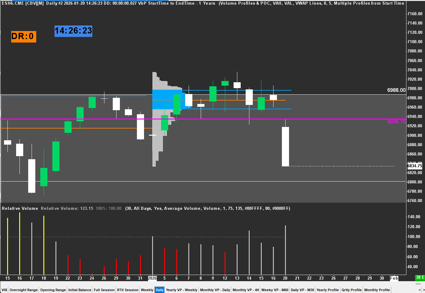

I updated the version of Sierra Charts to the most recent version and have a few questions.i have a daily historical chart and it no longer reflects 1/19 as a day rather it includes 1/19's prices with todays...also i used to be able to see delayed data for nymex comex and cbot and now i cannot...can you please advise

The reason for the lack of daily data for January 19, 2026, is that it was a US Holiday (Martin Luther King Day). So the CME Group puts the trading from Sunday Evening and Monday into the trading day for Tuesday. You can view this information on their website at the following link:
https://www.cmegroup.com/trading-hours.html#tradeDate=2026-01-19

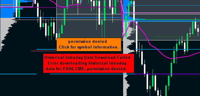

this is the issue i am experiencing now on the pc fed with rithmic

Refer to the following regarding what we know about the Permission Denied error from Rithmic:
Rithmic Trading Platform Service: Permission Denied Resolution Procedure
