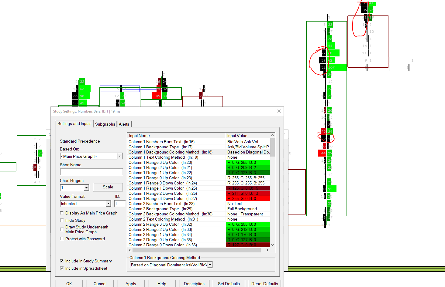

TopGunTrader - Posts: 313
Was playing with some of the newer Numbers Bars study and on black background its amazing clearly lets me see what's going on. Problem is my levels have many dark colors I overlay onto chart so usually use white background. On white instead of the side that looks transparent on black background it shows up on white. Seems the default is BLACK with no option to change!
I'm hoping there is a setting for this and I just can't find it. If not please make that color be the charts background color so it can be used in its best way on non black charts.
imageCapture.PNG / V - Attached On 2026-01-15 13:07:39 UTC - Size: 107.27 KB - 165 views

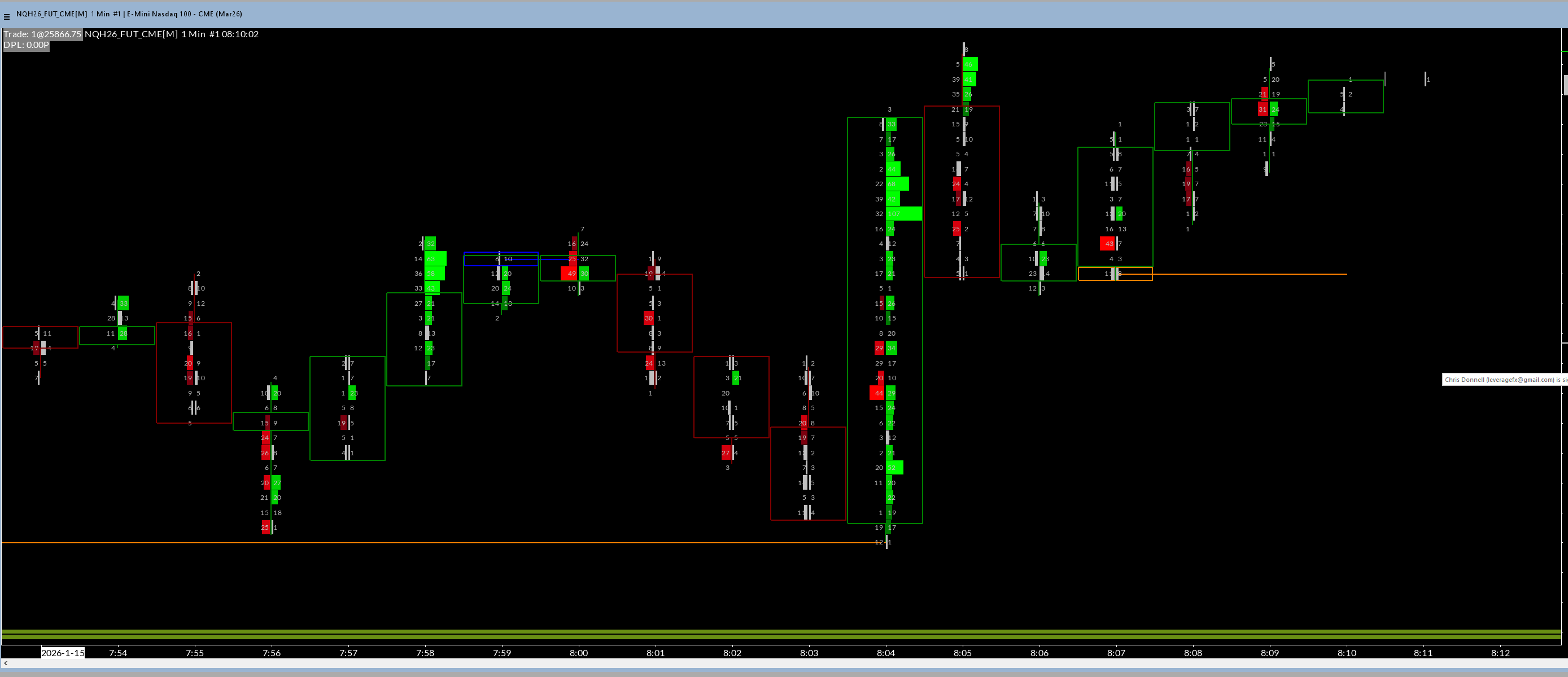

Here is pic of what it looks like on black background NOT SEEING the weaker side is BETTER 100% clear which side is winning no distractions. Sadly it appears impossible to do this on any chart background other than black.
imageCapture.PNG / V - Attached On 2026-01-15 13:11:09 UTC - Size: 107.29 KB - 179 views
