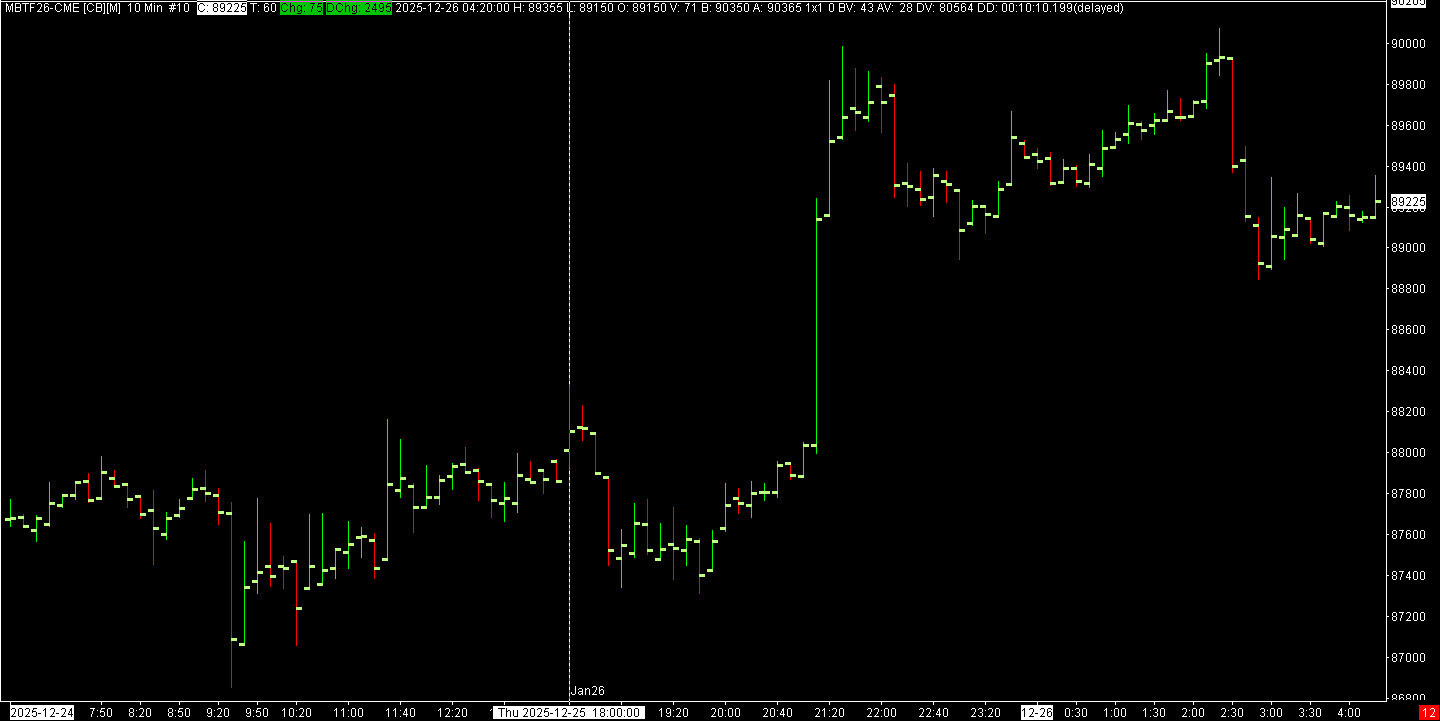

Related question: Is the dashed line shown by "Chart > Show Rollover Dates" consistent with the internal workings? For example, in here (https://www.sierrachart.com/image.php?Image=1767385036600.png), the dashed line appears on 12/25 at 18:00:00 ET. Is the following a correct statement?
"MBTZ25 is shown up until right before the dashed line (i.e., until the end of the 12/24 trading session) with +505 adjustment; and MBTF26 begins to show on and after the dashed line (i.e., from the beginning of the 12/26 trading session)."

[2026-01-05 21:16:37]
The nearest date will be used. So we need to understand what was in the data files at the time. We will do some testing.
2026-01-02 10:40:37.040 | MBTF26-CME [CB][M] 60 Min #10 | MBTZ25-CME Settlement price on 2025-12-30 is 87245.
2026-01-02 10:40:37.042 | MBTF26-CME [CB][M] 60 Min #10 | MBTF26-CME Settlement price on 2025-12-24 is 87750.
Yes this is correct, but we are not sure of the adjustment amount you specify:
