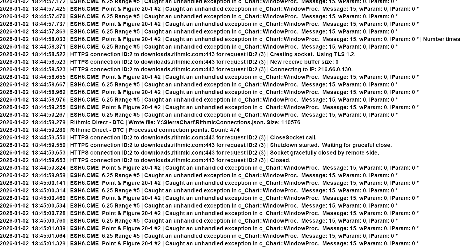

Hi, I don't know what's wrong with Sierra Chart. It doesn't load anything, no charts. I'm attaching the log.

Ok, the problem was solved by restarting but now it's as if it's not loading my data: they arrive up to December 12th, then directly to today but with a time gap: the data for the entire day is missing.
[2026-01-02 19:28:14]
You are going to have problems using Rithmic data:
Rithmic Trading Platform Service: Rithmic Support Policy
Regarding those exceptions you are getting, you do need to restart Sierra Chart.
Also update to the current version:
[2026-01-02 19:59:50]

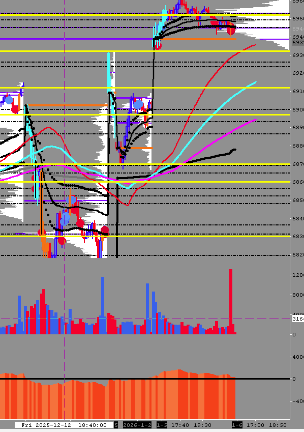

Okay, sure, actually I only use Rithmic for trading data. I left the Market Data and Historical Data blank so I can use Denali. It's always worked, but since yesterday I can't figure out why it's not working. Specifically, the data goes up to December 12th and then slips to January 2nd (even though I have a gap in the January 2nd data). But I had that data since I traded all December. Do you know how to help me?

Okay, thanks. But I still have a gap in the historical data. I look at the screen, the date is December 12th and the last profile volume is from yesterday.
Date Time Of Last Edit: 2026-01-06 09:30:35
imageScreenshot 2026-01-06 alle 10.27.49.png / V - Attached On 2026-01-06 09:30:28 UTC - Size: 44.61 KB - 195 views
[2026-01-06 15:36:08]
Now that you have the Denali Exchange Data Feed active for the CME Group data, you can get the missing data. Follow the instructions at the following link:
