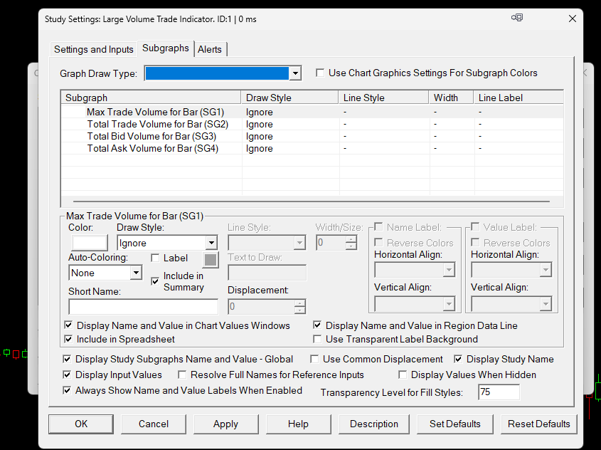

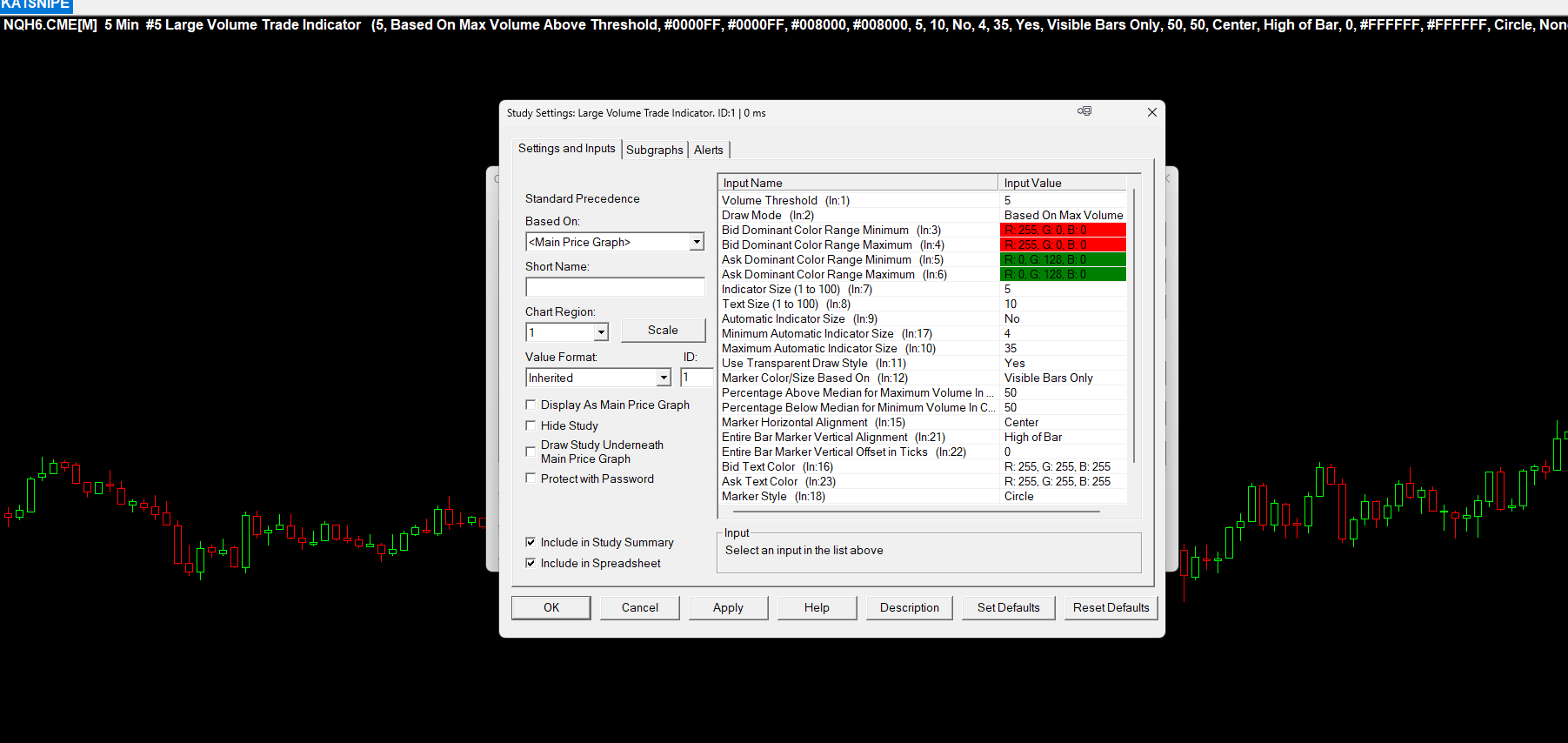

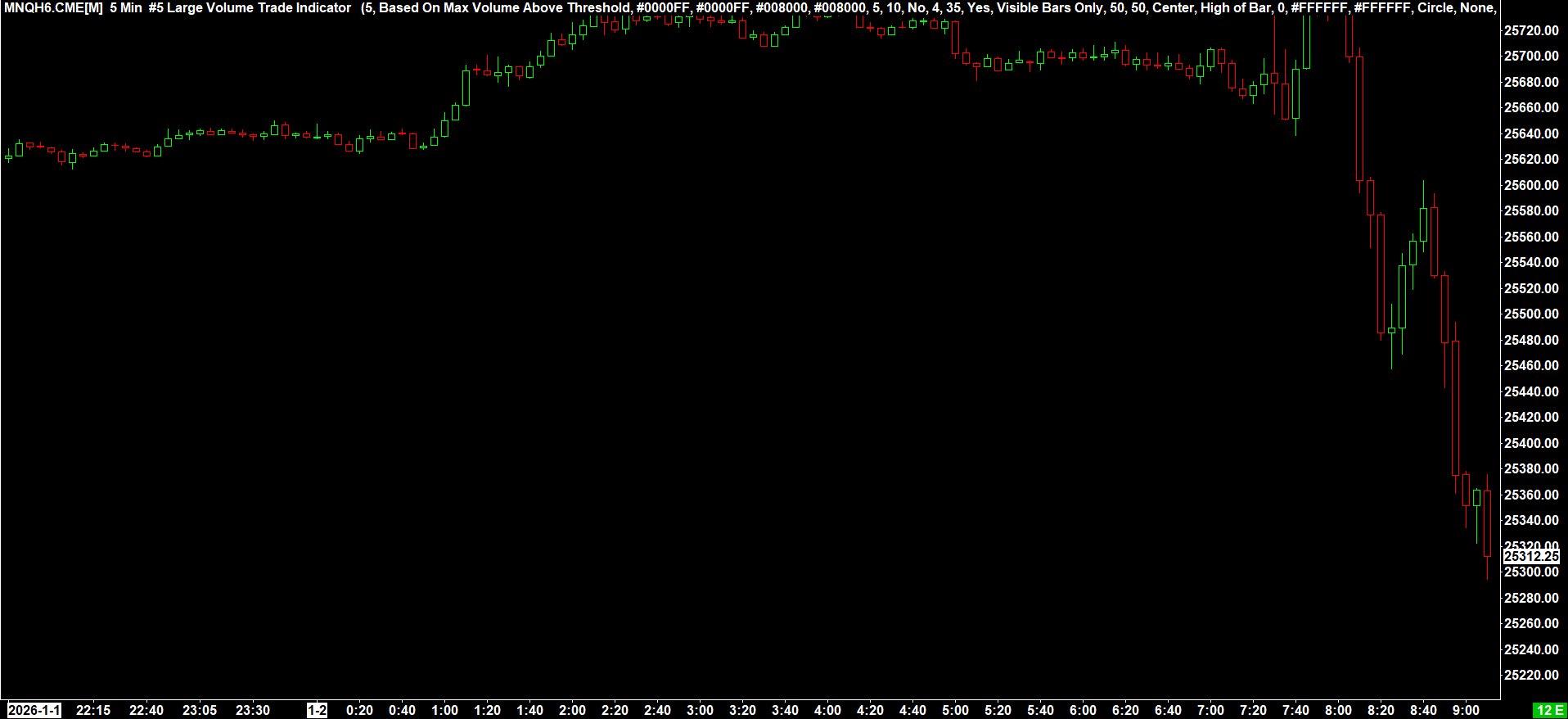

It only displays the candle sticks but none of the Large Volume Trade Indicator study. It is my first attempt to add this study to my chart book. Recently, I upgraded SC to the latest version. The attached uploaded files show the chart, the study's Settings and Inputs & Subgraphs that I am using based on a friend's chart who has had his working for a while. It is on a Renko 10-4-3 Chart with the symbol MNQH6.CME. I am using Denali data. I looked through the Message Board under the topic of Large Volume Trade Indicator not displaying where I did find a couple of older threads about a similar issue but the recommended solutions did not work. Please assist.

[2026-01-02 18:18:15]
Typically, when there is a problem with this study it is related to the setting for "Global Settings >> Data/Trade Service Settings >> Common Settings >> Intraday Data Storage Time Unit". This needs to be set to "1 Tick". Refer to the following:
Data/Trade Service Settings: Intraday Data Storage Time Unit (Global Settings >> Data/Trade Service Settings >> Common Settings >> Common Settings)
[2026-01-02 18:36:24]
User543381 - Posts: 10
"Global Settings >> Data/Trade Service Settings >> Common Settings >> Intraday Data Storage Time Unit" was set to 1 Second. There is no change after setting it to 1 Tick. I tried a couple of other times with the same results. After setting it back to 1 Tick I tried shutting down SC and restarting it. No change. btw, thank you for the prompt response.
[2026-01-02 19:08:36]
John, I guess that I needed to be patient. Large Volume Trade Indicator is working now. THANK YOU!
[2026-01-02 19:46:24]
If you want to get the information displayed on the existing data, then you would need to redownload it so you have the 1 tick data stored. This is called out in the documentation for the "Intraday Data Storage Time Unit".
