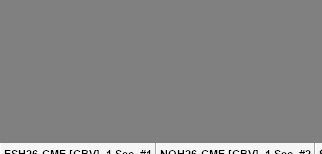

What can be observed is as follows:
After the login window, SC starts with a maximized main window.
If I open a chartbook with charts (or create a new chartbook and open a chart window), the chart window tabs at the bottom of the screen are slightly offset downward (see attached screenshots). But it is not just these tabs. It is really everything in the main window that is "offset downward". This is not visible, i.e. the top of the main window with the menu bar and status bar looks normal, but when I try to click on any item, it can be observed that these clicks act as being "offset upward", e.g. I can click on a button although the mouse pointer tip is not hovering above the button, or, to the other edge, the mouse pointer tip is on the button, but clicks have no effect.

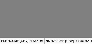

The situation can be resolved by
1) de-maximizing the SC main window and
2) maximizing the SC main window again.
After that the effect is gone.

imageScreenshot From 2026-01-02 13-11-50.png / V - Attached On 2026-01-02 13:30:00 UTC - Size: 1.65 KB - 182 views
imageScreenshot From 2026-01-02 13-12-03.png / V - Attached On 2026-01-02 13:30:17 UTC - Size: 2.51 KB - 190 views

Screenshots are from the bottom left corner of the screen. Showing the effect (*11-50.png), and the normal state after de-maximize and maximize of the main window (*12-03.png).
