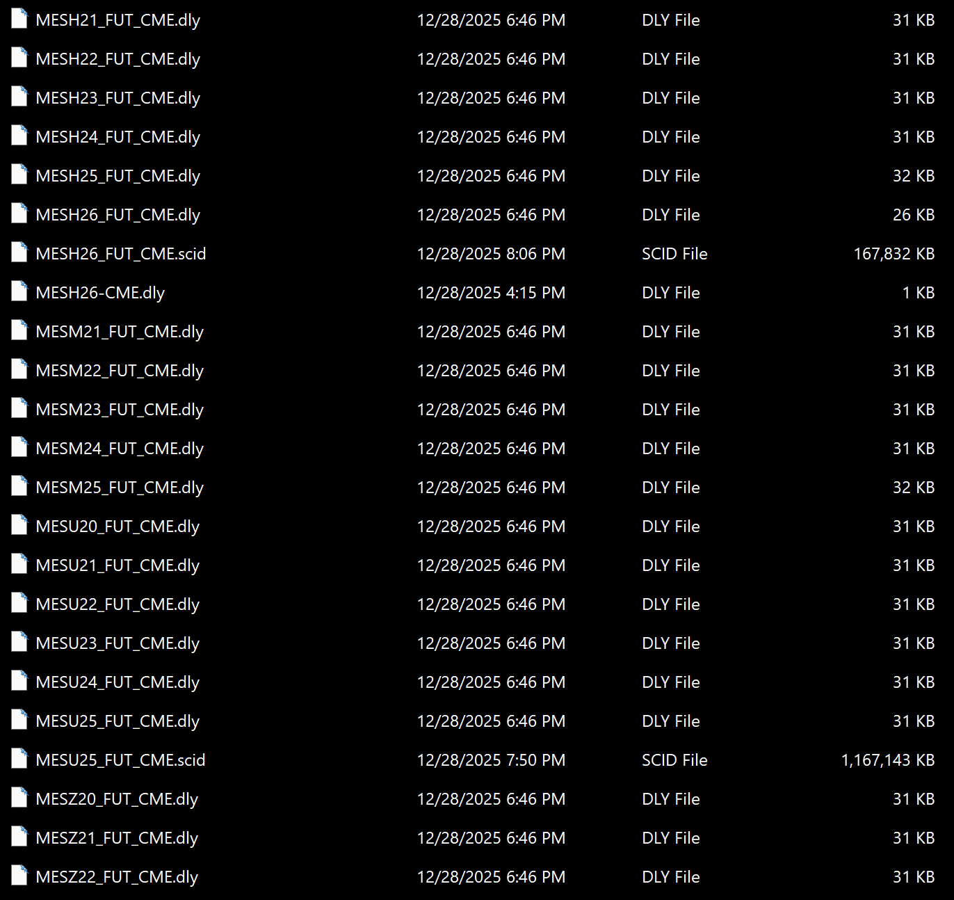

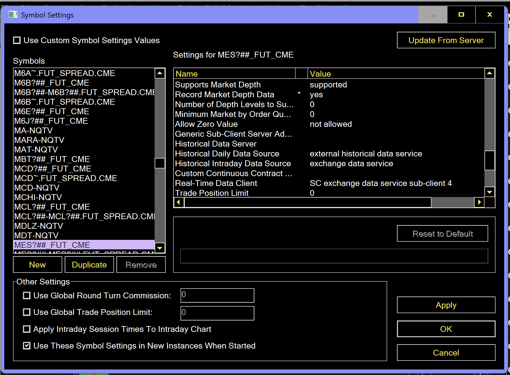

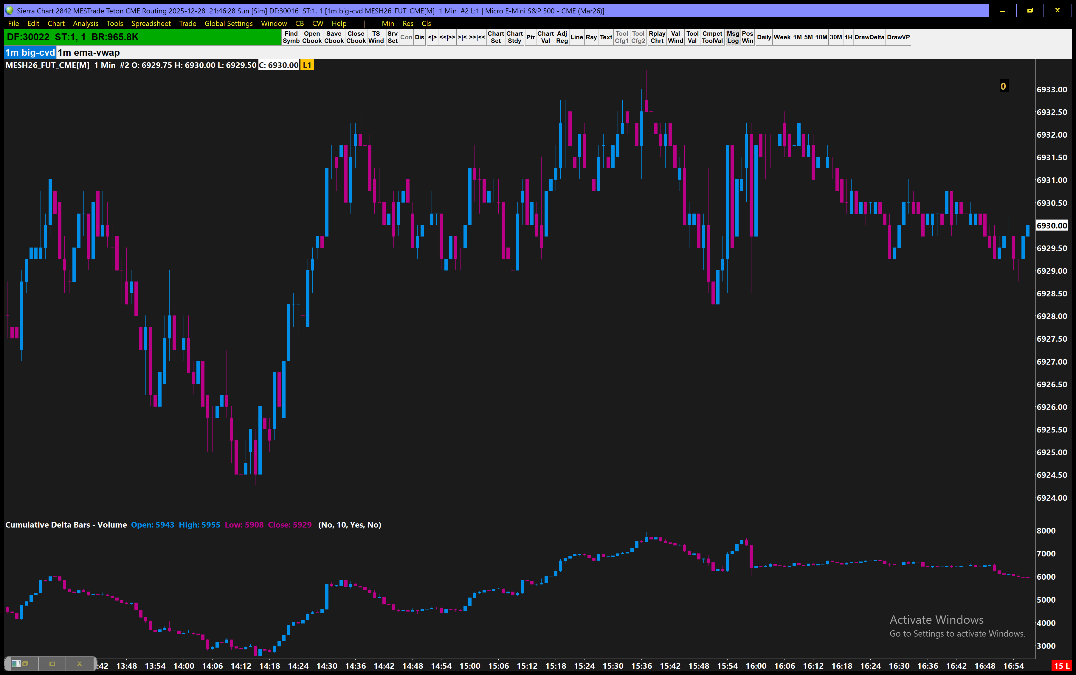

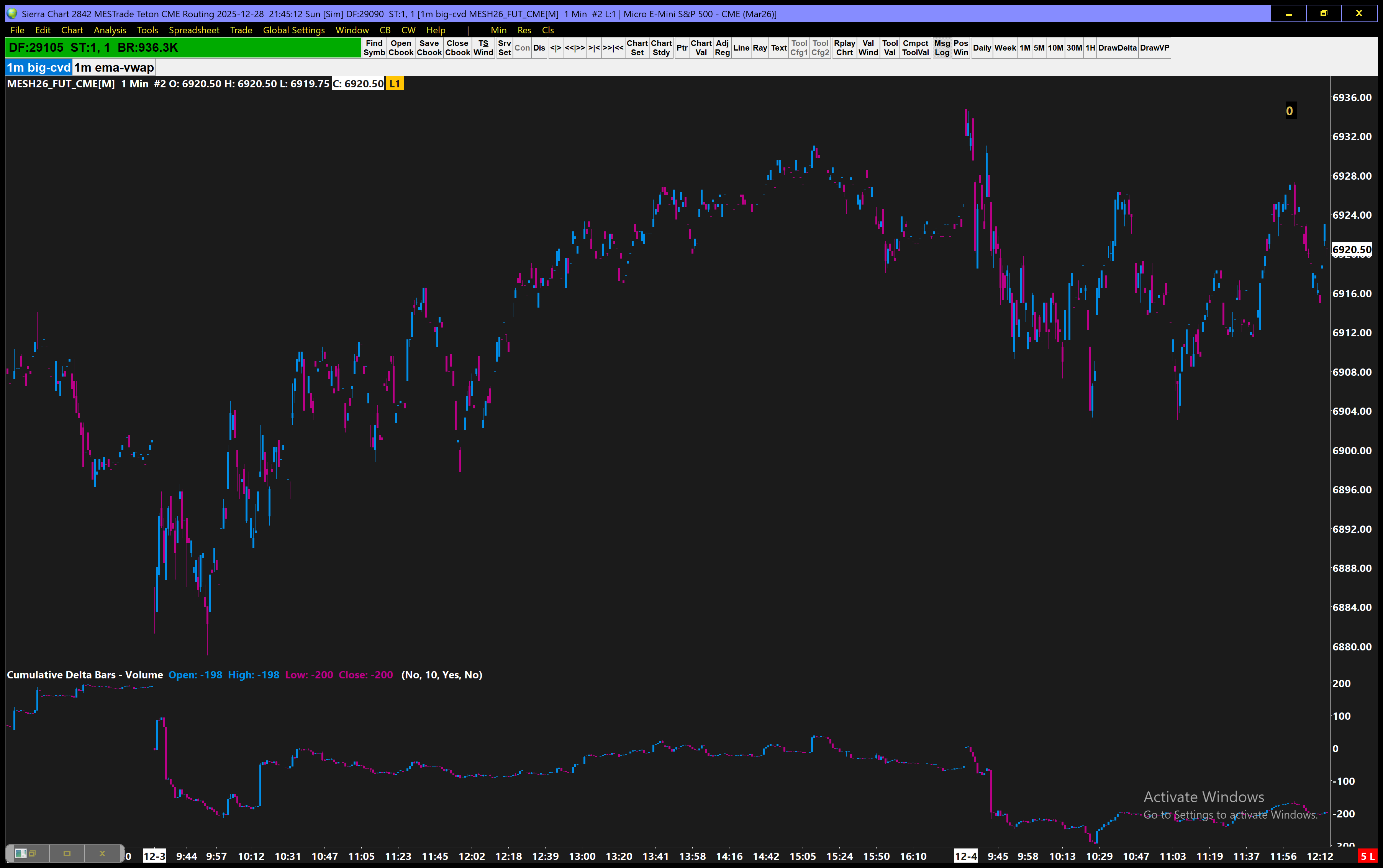

I am facing issues with the quality of my intraday data falling off. It may not be a data degradation issue, but visually it appears like some kind of degradation. The information becomes more sparse as you move farther back. The candles are completely fine until about December 10th where it suddenly drops off in quality. Here are the images demonstrating the difference.
- Issue: [https://www.sierrachart.com/image.php?Image=1766976313707.png](https://www.sierrachart.com/image.php?Image=1766976313707.png)
- Normal appearance same chart: [https://www.sierrachart.com/image.php?Image=1766976390268.png](https://www.sierrachart.com/image.php?Image=1766976390268.png)
I have spent most of the day trying to resolve this through your documentation and public materials about properly setting up the data for chart replay.

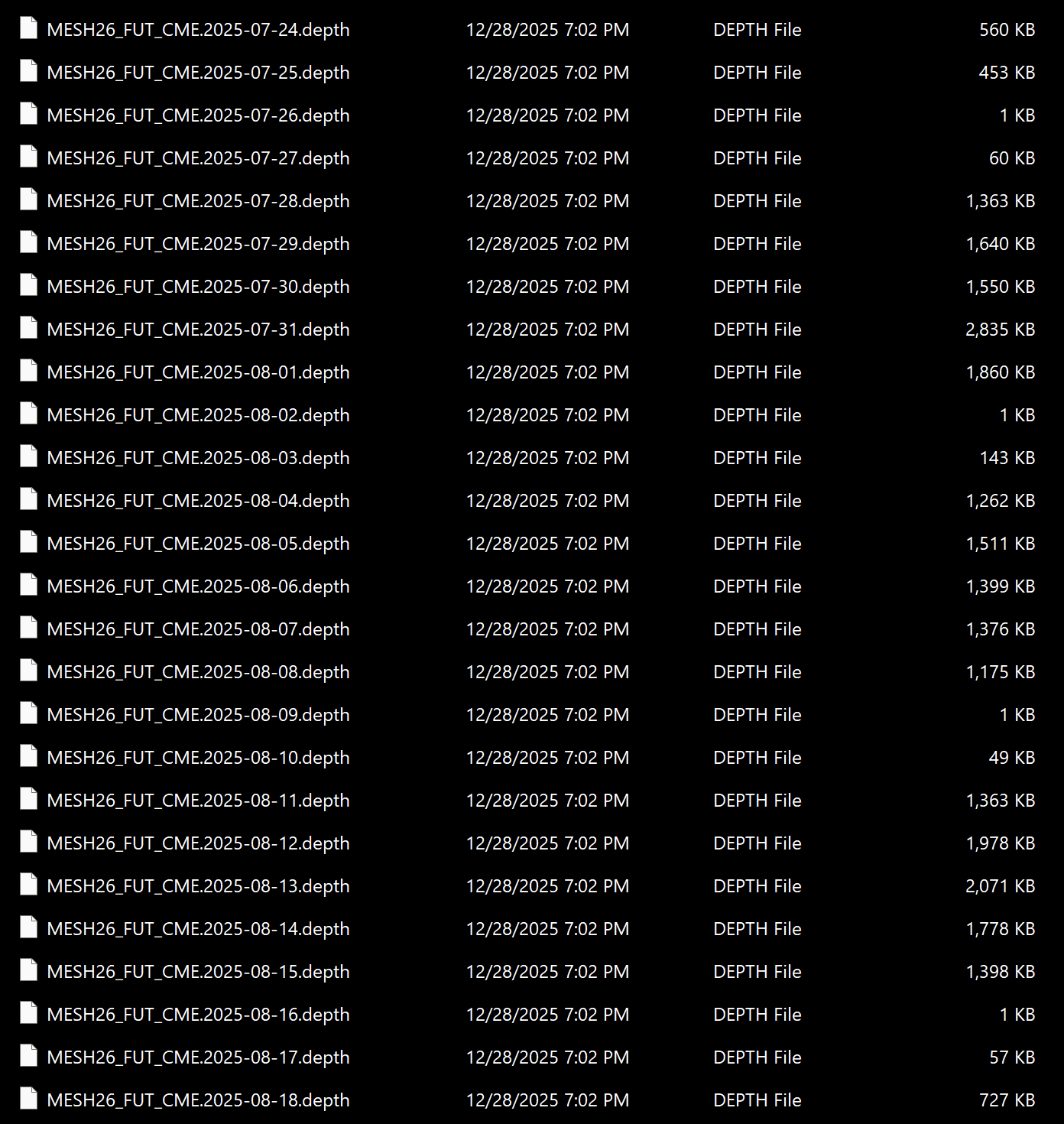

In videos I've seen progress bars indicating the loading of .depth files when they start chart replay. I've tried many times and have not seen that indication. I was having issues getting .depth files to download until I used post #4 from this documentation to resolve that:
- Problem with depth data
I deleted and redownloaded the data in every way I've seen suggested. I also tried deleting them directly from the directories. I've checked many times to ensure that the chart, symbol, and data settings are in-line and operating within proper permissions on data download.
I am adding images of the directories where it seems that there are inconsistencies with the file sizes of the .scid files and .depth files.
I'm running SC on Parallels on a Macbook Pro and live in Central America. I don't know what will be relevant, so I'm sharing anything that might help resolve this.
I took your recommended steps to fix a time zone discrepancy between Windows in Parallels and SC and tried once again, but it didn't make any difference.
I need to resolve this and successfully run chart replays on market depth data. Thank you for the support.

2025-12-28 21:58:33.720 | Real-time Intraday chart data file updates started for MESH26_FUT_CME
2025-12-28 21:58:33.720 | Intraday chart data file opened for MESH26_FUT_CME
2025-12-28 21:58:33.720 | HD Request # 1 | Enabling Intraday chart updating for symbol.
2025-12-28 21:58:33.720 | No download requests in the queue to start downloads for.
2025-12-28 21:58:33.768 | Socket (3) | Socket gracefully closed by remote side.
2025-12-28 21:58:33.768 | Socket (3) | Closed.
2025-12-28 21:58:38.515 | Opened cached Intraday file: C:\SierraChart\Data\MESH26_FUT_CME.scid. Thread ID: 3908
2025-12-28 21:58:46.563 | MESH26_FUT_CME 1 Min #1 | Reloading chart.
2025-12-28 21:58:46.584 | MESH26_FUT_CME 5 Min #2 | Reloading chart.
2025-12-28 21:58:46.607 | MESH26_FUT_CME [CBV] 60 Min #3 | Reloading chart.
2025-12-28 21:58:46.608 | Added historical Intraday data request for MESU25_FUT_CME to the queue.
2025-12-28 21:58:46.608 | Triggering next historical data download in queue.
2025-12-28 21:58:46.610 | Added historical Intraday data request for MESZ25_FUT_CME to the queue.
2025-12-28 21:58:46.612 | Added historical Intraday data request for MESH26_FUT_CME to the queue.
2025-12-28 21:58:46.612 | Intraday data recording state for symbol MESH26_FUT_CME is set to download 'Pending'.
2025-12-28 21:58:46.643 | MESH26_FUT_CME [CBV] 60 Min #3 | Waiting for historical downloads to complete with the IDs: 2, 3, 4,
2025-12-28 21:58:46.666 | MESH26_FUT_CME [CBV] Daily #4 | Reloading chart.
2025-12-28 21:58:47.294 | MESH26_FUT_CME 1 Min #2 | Reloading chart.
2025-12-28 21:58:47.334 | MESH26_FUT_CME 1 Min #1 | Reloading chart.
2025-12-28 21:58:47.337 | Mapping MESU25_FUT_CME to MESU25. Service code: cme
2025-12-28 21:58:47.337 | HD Request # 2 | Downloading Intraday chart data for MESU25_FUT_CME to the file MESU25_FUT_CME.scid. Service: cme
2025-12-28 21:58:47.337 | Enabling compression for file: C:\SierraChart\Data\MESU25_FUT_CME.scid
2025-12-28 21:58:47.337 | HD Request # 2 | Download start date-time: 2025-05-29 20:00:00.000000. File last date-time: 00:00:00.000000
2025-12-28 21:58:47.343 | HD Request # 2 | Using server: ds26.sierracharts.com port 10149
2025-12-28 21:58:47.360 | MESH26_FUT_CME [CBV] Daily #4 | Chart data loading complete.
2025-12-28 21:58:47.368 | MESH26_FUT_CME 1 Min #1 | Chart data loading complete.
2025-12-28 21:58:47.371 | MESH26_FUT_CME 5 Min #2 | Chart data loading complete.
2025-12-28 21:58:47.430 | Socket (3) | Creating socket.
2025-12-28 21:58:47.430 | Socket (3) | New receive buffer size: 0
2025-12-28 21:58:47.430 | Socket (3) | Connecting to IP: 64.152.155.17.
2025-12-28 21:58:47.562 | HD Request # 2 | Setting DTC encoding to Binary VLS
2025-12-28 21:58:47.562 | HD Request # 2 | Sending historical data logon request message.
2025-12-28 21:58:47.657 | HD Request # 2 | Requesting Intraday data. Start date-time: 2025-05-29 20:00:00. Record interval: 0. Symbol: MESU25
2025-12-28 21:58:47.722 | HD Request # 2 | Decompressing data.
2025-12-28 21:58:47.734 | HD Request # 2 | Receiving Intraday data for MESU25_FUT_CME starting at 2025-05-29 20:02:32.407000
2025-12-28 21:58:47.999 | HD Request # 2 | Timestamp of first Intraday data file record written: 2025-05-29 20:02:32.407000.
2025-12-28 21:58:48.203 | MESH26_FUT_CME[M] 1 Min #2 | Chart data loading complete.
2025-12-28 21:58:48.523 | MESH26_FUT_CME[M] 1 Min #2 | Reloading chart.
2025-12-28 21:58:48.623 | MESH26_FUT_CME[M] 1 Min #1 | Chart data loading complete.
2025-12-28 21:58:49.341 | MESH26_FUT_CME[M] 1 Min #2 | Chart data loading complete.
2025-12-28 22:00:44.713 | Socket (3) | CloseSocket call.
2025-12-28 22:00:44.713 | Socket (3) | Shutdown started. Waiting for graceful close.
2025-12-28 22:00:44.715 | Historical data download thread signaled to stop.
2025-12-28 22:00:44.715 | HD Request # 2 | Received 29878853 Intraday data records from 2025-05-29 20:02:32.407000 to 2025-09-19 09:29:57.599000 (112.6 days. Delay: 100.6 days) and wrote 29878853 records for MESU25_FUT_CME
2025-12-28 22:00:44.729 | HD Request # 2 | Add time&sales data | Remembered last file record date-time: 2025-09-19 13:29:57.599000
2025-12-28 22:00:44.729 | HD Request # 2 | Completion time: 1m 57s.
2025-12-28 22:00:44.729 | HD Request # 2 | Intraday data download complete for MESU25_FUT_CME. Unique request ID: 2
2025-12-28 22:00:44.729 | Removing historical data download ID 2.
2025-12-28 22:00:44.729 | Real-time Intraday chart data file updates started for MESU25_FUT_CME
2025-12-28 22:00:44.729 | Intraday chart data file opened for MESU25_FUT_CME
2025-12-28 22:00:44.729 | HD Request # 2 | Enabling Intraday chart updating for symbol.
2025-12-28 22:00:44.729 | Triggering next historical data download in queue.
2025-12-28 22:00:44.730 | Mapping MESZ25_FUT_CME to MESZ25. Service code: cme
2025-12-28 22:00:44.730 | HD Request # 3 | Downloading Intraday chart data for MESZ25_FUT_CME to the file MESZ25_FUT_CME.scid. Service: cme
2025-12-28 22:00:44.730 | Enabling compression for file: C:\SierraChart\Data\MESZ25_FUT_CME.scid
2025-12-28 22:00:44.730 | HD Request # 3 | Download start date-time: 2025-08-28 20:00:00.000000. File last date-time: 00:00:00.000000
2025-12-28 22:00:44.730 | HD Request # 3 | Using server: ds32.sierracharts.com port 10150
2025-12-28 22:00:44.735 | Socket (4) | Creating socket.
2025-12-28 22:00:44.735 | Socket (4) | New receive buffer size: 0
2025-12-28 22:00:44.735 | Socket (4) | Connecting to IP: 69.39.70.248.
2025-12-28 22:00:44.778 | Socket (3) | Socket gracefully closed by remote side.
2025-12-28 22:00:44.778 | Socket (3) | Closed.
2025-12-28 22:00:44.875 | HD Request # 3 | Setting DTC encoding to Binary VLS
2025-12-28 22:00:44.875 | HD Request # 3 | Sending historical data logon request message.
2025-12-28 22:00:44.981 | HD Request # 3 | Requesting Intraday data. Start date-time: 2025-08-28 20:00:00. Record interval: 0. Symbol: MESZ25
2025-12-28 22:00:45.050 | HD Request # 3 | Decompressing data.
2025-12-28 22:00:45.077 | HD Request # 3 | Receiving Intraday data for MESZ25_FUT_CME starting at 2025-08-28 20:07:19.329000
2025-12-28 22:00:45.373 | HD Request # 3 | Timestamp of first Intraday data file record written: 2025-08-28 20:07:19.329000.
2025-12-28 22:03:20.372 | Socket (4) | CloseSocket call.
2025-12-28 22:03:20.372 | Socket (4) | Shutdown started. Waiting for graceful close.
2025-12-28 22:03:20.373 | Historical data download thread signaled to stop.
2025-12-28 22:03:20.373 | HD Request # 3 | Received 42597399 Intraday data records from 2025-08-28 20:07:19.329000 to 2025-12-19 09:29:59.326001 (112.6 days. Delay: 9.5 days) and wrote 42597399 records for MESZ25_FUT_CME
2025-12-28 22:03:20.398 | HD Request # 3 | Add time&sales data | Remembered last file record date-time: 2025-12-19 14:29:59.326001
2025-12-28 22:03:20.398 | HD Request # 3 | Completion time: 2m 36s.
2025-12-28 22:03:20.398 | HD Request # 3 | Intraday data download complete for MESZ25_FUT_CME. Unique request ID: 3
2025-12-28 22:03:20.398 | Removing historical data download ID 3.
2025-12-28 22:03:20.398 | Real-time Intraday chart data file updates started for MESZ25_FUT_CME
2025-12-28 22:03:20.398 | Intraday chart data file opened for MESZ25_FUT_CME
2025-12-28 22:03:20.398 | HD Request # 3 | Enabling Intraday chart updating for symbol.
2025-12-28 22:03:20.398 | Triggering next historical data download in queue.
2025-12-28 22:03:20.398 | HD Request # 4 | Downloading Intraday chart data for MESH26_FUT_CME to the file MESH26_FUT_CME.scid. Service: cme
2025-12-28 22:03:20.399 | HD Request # 4 | Download start date-time: 2025-12-28 21:58:34.000000. File last date-time: 2025-12-28 21:58:34.425001
2025-12-28 22:03:20.399 | HD Request # 4 | Using server: ds28.sierracharts.com port 10149
2025-12-28 22:03:20.399 | Socket (3) | Creating socket.
2025-12-28 22:03:20.399 | Socket (3) | New receive buffer size: 0
2025-12-28 22:03:20.400 | Socket (3) | Connecting to IP: 67.214.125.5.
2025-12-28 22:03:20.438 | Socket (4) | Socket gracefully closed by remote side.
2025-12-28 22:03:20.438 | Socket (4) | Closed.
2025-12-28 22:03:20.536 | HD Request # 4 | Setting DTC encoding to Binary VLS
2025-12-28 22:03:20.536 | HD Request # 4 | Sending historical data logon request message.
2025-12-28 22:03:20.645 | HD Request # 4 | Requesting Intraday data. Start date-time: 2025-12-28 21:58:34. Record interval: 0. Symbol: MESH26
2025-12-28 22:03:20.714 | HD Request # 4 | Decompressing data.
2025-12-28 22:03:20.778 | HD Request # 4 | Receiving Intraday data for MESH26_FUT_CME starting at 2025-12-28 21:58:34.425000
2025-12-28 22:03:20.779 | Socket (3) | CloseSocket call.
2025-12-28 22:03:20.780 | Socket (3) | Shutdown started. Waiting for graceful close.
2025-12-28 22:03:20.782 | Historical data download thread signaled to stop.
2025-12-28 22:03:20.782 | HD Request # 4 | Timestamp of first Intraday data file record written: 2025-12-28 21:58:48.499000.
2025-12-28 22:03:20.782 | HD Request # 4 | Received 198 Intraday data records from 2025-12-28 21:58:34.425000 to 2025-12-28 22:03:17.169000 (4.7 minutes. Delay: 3.6 seconds) and wrote 196 records for MESH26_FUT_CME
2025-12-28 22:03:20.801 | HD Request # 4 | Add time&sales data | Remembered last file record date-time: 2025-12-29 03:03:17.169000
2025-12-28 22:03:20.802 | HD Request # 4 | Completion time: 0s.
2025-12-28 22:03:20.802 | HD Request # 4 | Intraday data download complete for MESH26_FUT_CME. Unique request ID: 4
2025-12-28 22:03:20.802 | Removing historical data download ID 4.
2025-12-28 22:03:20.802 | Real-time Intraday chart data file updates started for MESH26_FUT_CME
2025-12-28 22:03:20.802 | Intraday chart data file opened for MESH26_FUT_CME
2025-12-28 22:03:20.802 | HD Request # 4 | Enabling Intraday chart updating for symbol.
2025-12-28 22:03:20.802 | No download requests in the queue to start downloads for.
2025-12-28 22:03:20.855 | Socket (3) | Socket gracefully closed by remote side.
2025-12-28 22:03:20.855 | Socket (3) | Closed.
2025-12-28 22:03:21.129 | MESH26_FUT_CME [CBV] 60 Min #3 | Download is complete for all contract months in chart. Proceeding with data load.
2025-12-28 22:03:21.130 | MESH26_FUT_CME [CBV] 60 Min #3 | Reloading chart. | Number times message added: 1
2025-12-28 22:03:29.038 | Opened cached Intraday file: C:\SierraChart\Data\MESH26_FUT_CME.scid. Thread ID: 3908
2025-12-28 22:03:48.147 | MESH26_FUT_CME [CBV][M] 60 Min #3 | Chart data loading complete.
