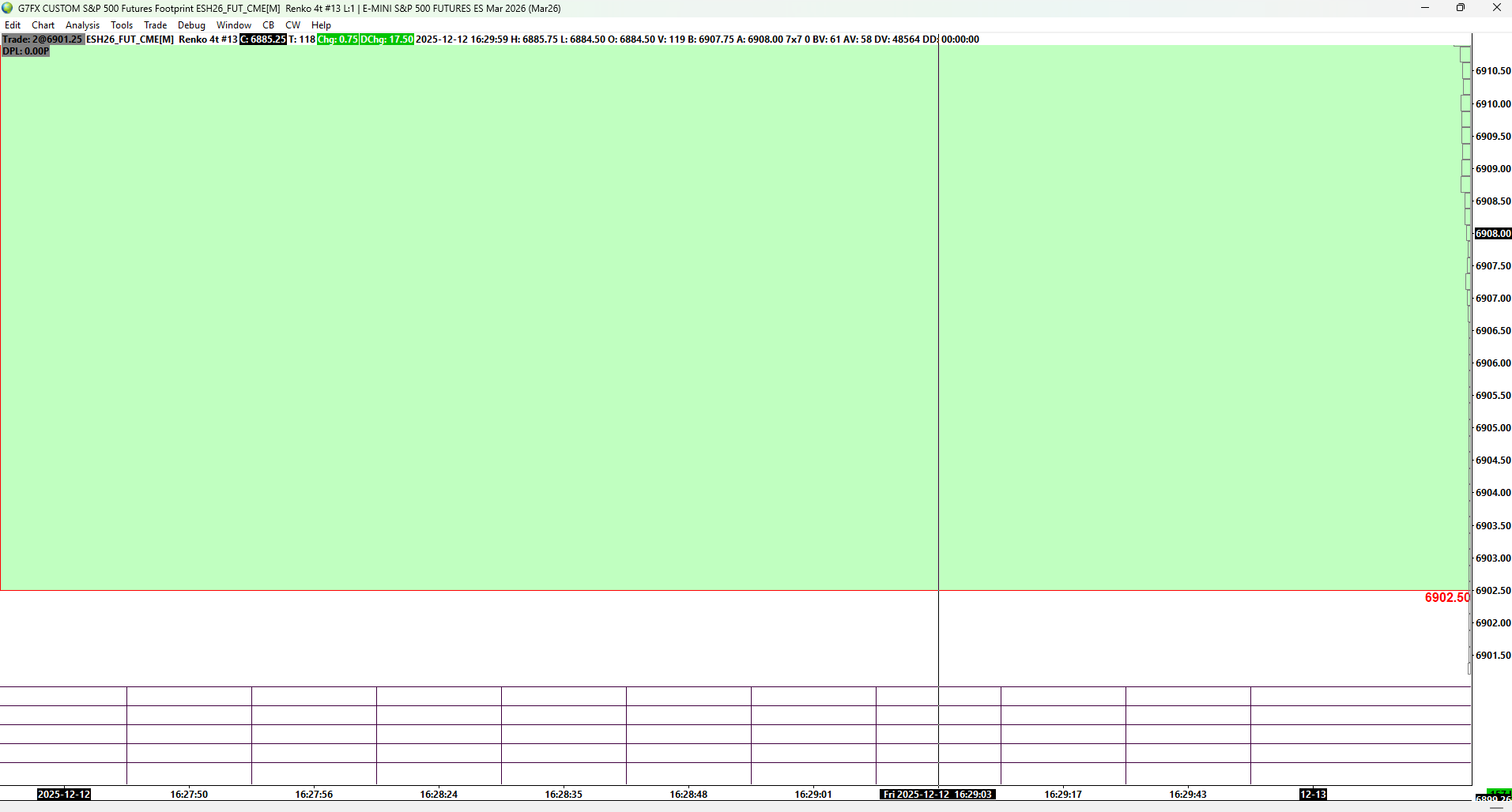

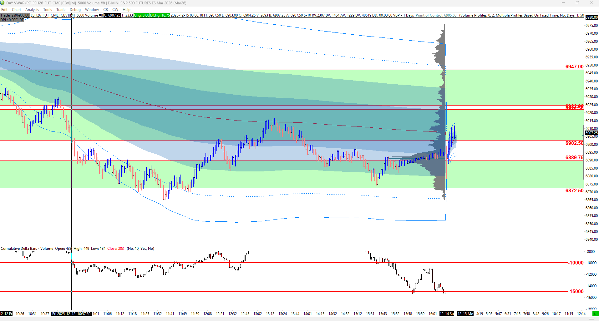

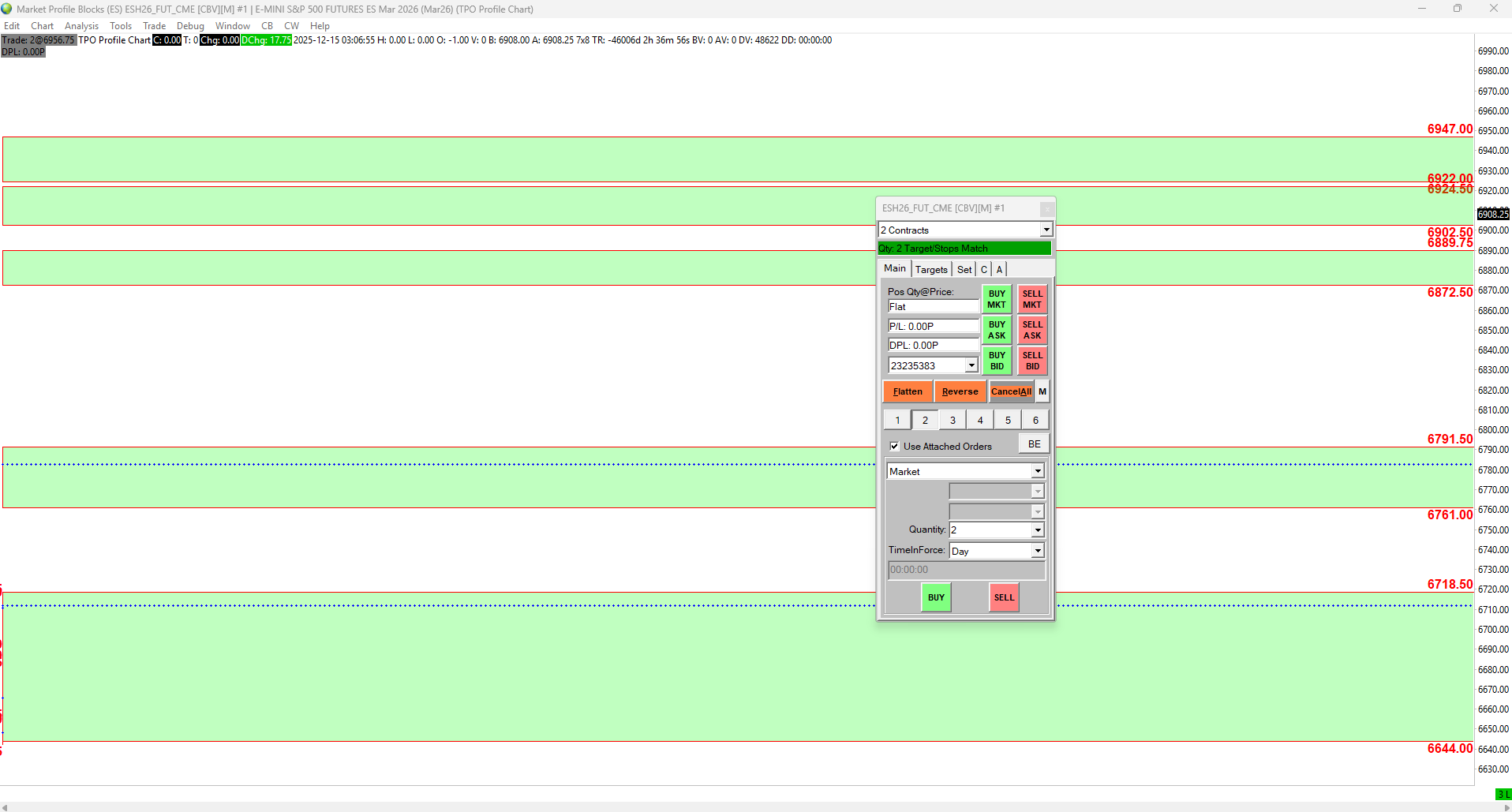

I have tried everything and followed every settings instruction there is but for some reason i can't get my footprint or market profile charts to show data.
I have activate the Denali data feed and the full CME group with market depth exchange, I have also linked my futures account from Ironbeam as well.
The charts were fine before i activated all the live data etc but now i just can't seem to bring them back.
Can anyone help out with this please.
(P.s I am using the G7FX templates for the charts)
imageScreenshot 2025-12-15 120629.png / V - Attached On 2025-12-15 08:24:05 UTC - Size: 82.65 KB - 153 views
imageScreenshot 2025-12-15 120648.png / V - Attached On 2025-12-15 08:24:10 UTC - Size: 44.64 KB - 134 views
imageScreenshot 2025-12-15 120705.png / V - Attached On 2025-12-15 08:24:13 UTC - Size: 76.53 KB - 223 views

This is because you are using service package 10. You will need service package 11 for this. We have given you a trial for 30 days to service package 11 for free.
You are also running a significantly older version. A newer version would make this clear as to what the problem is. Update instructions:

Thank you that solved the problem, been stuck on this for a while such a relief.
I will upgrade the package as well, thanks a lot for your help
