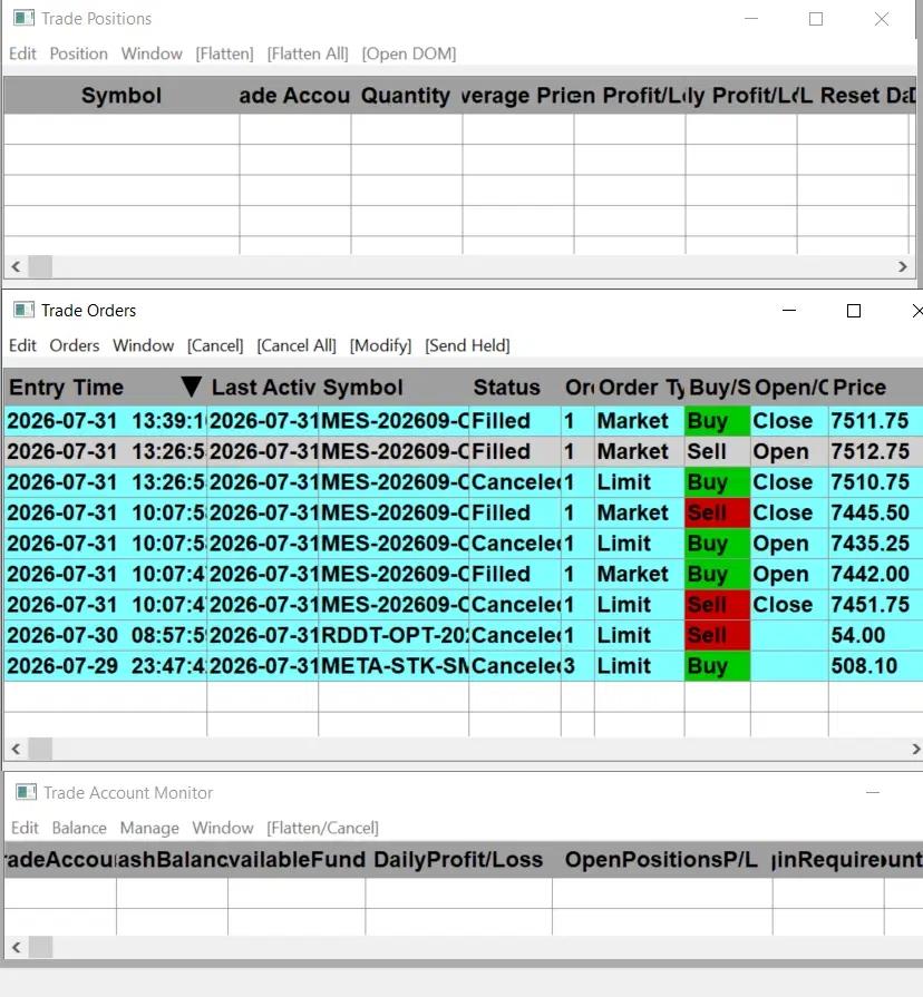

[2026-07-31 18:42:53]
User860690 - Posts: 12
2026-07-29 22:46:13.233 | Interactive Brokers | Received Open orders end message.
2026-07-29 22:46:13.486 | Interactive Brokers | Requesting Open orders.
2026-07-29 22:46:13.486 | Interactive Brokers | Sent reqAutoOpenOrders request
2026-07-29 22:46:13.588 | Interactive Brokers | Received Open orders end message.

2026-07-29 23:01:46.072 | Interactive Brokers | Requesting Open orders.
2026-07-29 23:01:46.072 | Interactive Brokers | Sent reqAutoOpenOrders request
2026-07-29 23:01:46.073 | Interactive Brokers | Received Open orders end message.
2026-07-29 23:01:57.055 | Trading message from IB: Order Canceled - reason:Order was discarded. Error Code: 202. ServiceOrderID: 3. InternalOrderID: 172.
2026-07-29 23:03:03.260 | TradeActivity files query time: 0.002470 seconds. Entries: 4. BeginDateTimeUTC: 2025-07-22 04:00:00.000. Outstanding queries: 0
2026-07-29 23:03:05.465 | TradeActivity files query time: 0.002777 seconds. Entries: 0. BeginDateTimeUTC: 2025-07-22 04:00:00.000. Outstanding queries: 0
2026-07-29 23:03:17.011 | Trading message from IB: Order Event Warning:Attribute 'Outside Regular Trading Hours' is ignored based on the order type and destination. PlaceOrder is now being processed. Error Code: 2109. ServiceOrderID: 4. InternalOrderID: 173.
2026-07-29 23:03:32.004 | Interactive Brokers | Requesting Open orders.
2026-07-29 23:03:32.004 | Interactive Brokers | Sent reqAutoOpenOrders request
2026-07-29 23:03:32.006 | Interactive Brokers | Received Open orders end message.
2026-07-29 23:03:48.170 | Trading message from IB: Order Canceled - reason:. Error Code: 202. ServiceOrderID: -113. InternalOrderID: 164.
2026-07-29 23:03:48.172 | Trading message from IB: Order Canceled - reason:. Error Code: 202. ServiceOrderID: -115. InternalOrderID: 166.
2026-07-29 23:03:48.419 | Trading message from IB: Order Canceled - reason:. Error Code: 202. ServiceOrderID: 4. InternalOrderID: 173.
2026-07-29 23:04:02.539 | Interactive Brokers | Requesting Open orders.
2026-07-29 23:04:02.539 | Interactive Brokers | Sent reqAutoOpenOrders request
2026-07-29 23:04:02.540 | Interactive Brokers | Received Open orders end message.
2026-07-29 23:05:41.638 | Trading message from IB: Order Event Warning:Attribute 'Outside Regular Trading Hours' is ignored based on the order type and destination. PlaceOrder is now being processed. Error Code: 2109. ServiceOrderID: 5. InternalOrderID: 174.
2026-07-29 23:05:50.255 | Trading message from IB: Order Canceled - reason:. Error Code: 202. ServiceOrderID: 5. InternalOrderID: 174.
2026-07-29 23:06:05.005 | Interactive Brokers | Requesting Open orders.
2026-07-29 23:06:05.005 | Interactive Brokers | Sent reqAutoOpenOrders request
2026-07-29 23:06:05.007 | Interactive Brokers | Received Open orders end message.

hi i think im facing similar issues.
in my case, the orders are passed on to IB. attached orders as well. just my only problem is the trade positions window and trade account monitor does not display anything when a position is open.
are these 2 windows no longer supported by sierra?
imagemarkuphero-6a6ce8618f589b7e85a80d8e.png / V - Attached On 2026-07-31 18:41:49 UTC - Size: 714.66 KB - 75 views
[2026-07-31 19:30:51]
John - SC Support - Posts: 48101
The "Trade Account Monitor" is not going to show anything for an Interactive Brokers account, so that is normal.
The "Trade Positions" are only going to show when you have an open position.
It looks like you may be referring to positions for the symbols "RDDT-OPT-20..." and "META-STK-SM...". In this case, it sounds like you may be having the issue mentioned in this documentation:
Interactive Brokers Trading Service: Trade Position Line or Quantity Disappearing or Displaying Zero
