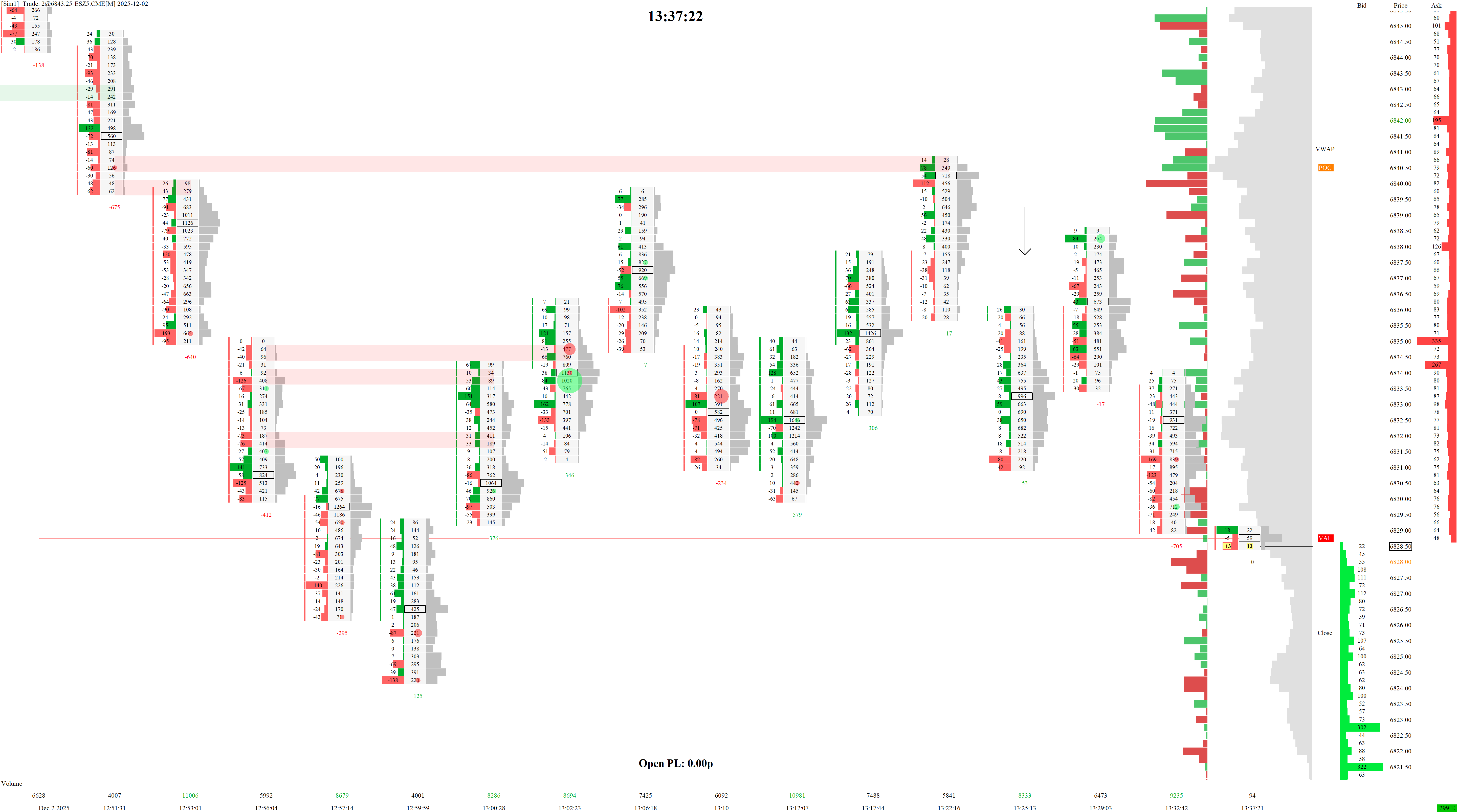

https://www.sierrachart.com/image.php?Image=1764700644839.png
I tried following the instructions for the lock fill space, but I just wanted to add a screenshot so you can see what I'm trying to accomplish. i don't want the candles to exceed where i have the arrow at because it proceeds to interfere with the Volume and delta profiles on my chart
[2025-12-02 20:19:03]
Then the Lock Fill Space is the correct option to use. You just set the last bar in the chart to where you want it to be, and then select "Chart >> Lock Fill Space". It's as simple as that.
The only thing to be aware of is that the spacing is based on a number of candles. So if you change the bar spacing, the location of the Lock Fill Space will change.
