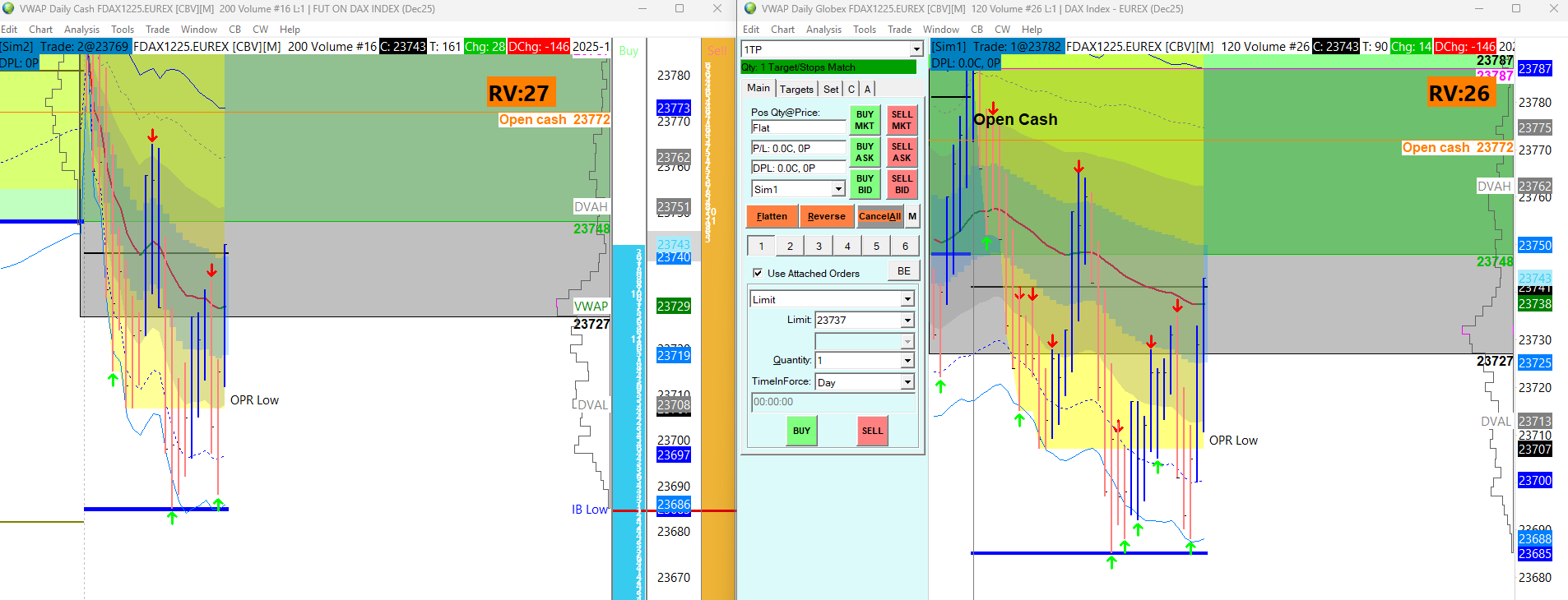

I cannot select two different symbol on different charts in the same chartbook. Is it possible to dot that ? I would like to trade on mini and analyse on full. Thank you in advance.

It does not answer to my question.
Attached a picture of my screen.
I wanted to know if it is possible to have symbol DAX on left chart and symbol mini DAX on right chart for instance ? So I can do my analysis on DAX and trade on mini DAX at the same time.
Regards,

The above answer tells you that it can be done. There is no reason you can not have two different charts with two different symbols in them. If you are having a problem with this, then most likely you have the charts linked so when you change the symbol for one it is changing the other. Refer to the following:
Chart Settings: Linking
If not the above, then we need to know specifically what the problem is that you are having. Why are you not able to open two charts and set them side-by-side?
[2025-12-02 08:46:22]
User760530 - Posts: 6
Clear it was the linking between the charts !
