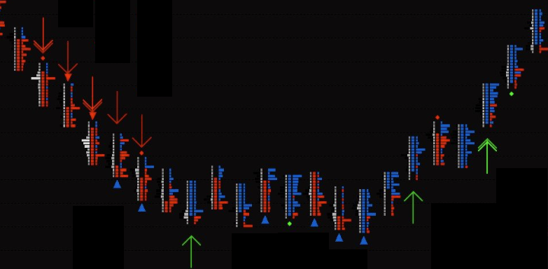

Hi, I'd like to know how to set up those arrows and green/red dots that appear on the footprint graph. Thanks.
imageScreenshot 2025-11-15 alle 16.05.48.png / V - Attached On 2025-11-19 18:59:37 UTC - Size: 203.76 KB - 203 views

There are two ways to get an item drawn at the High/Low of a bar. One is to set the subgraph to one of the "...on Low" or "...on High" draw styles, refer to the following:
Chart Studies: Point On Low (ACSIL: DRAWSTYLE_POINT_ON_LOW)
Chart Studies: Value on Low (ACSIL: DRAWSTYLE_VALUE_ON_LOW)
The other way is to use the "Color Bar Based on Alert Condition" per the following:
Color Bar Based on Alert Condition: Drawing Arrows/Text or Other Styles at the High or Low of Bars

Ok, but how don't find Point on low/high. I mean, I have to search in the window studies - studies available ? Why can't I find it in this window? Maybe I don't understand where to find this entry.

The link we gave gives you the information on where the item is located in the system by the hierarchy of the documentation.
For instance, "Point on Low" is a "Draw Style" (as Draw Style is the next higher level up item in the documentation). "Draw Style" is found on the "Subgraphs Tab", as the Subgraphs Tab is the next higher level in the documentation. The Subgraphs Tab can be found on the "Study Settings Window".
There are instructions in the section for the "Study Settings Window" for how to access that window.
In this case, the following is the way to get to that item:
- Select "Analysis >> Studies".
- Add a study, or select the study you want to modify.
- Select the study and select the "Settings" button.
- Select the Subgraphs Tab.
- Select the Subgraph you want.
- Find the entry for "Draw Style".
- Change the Draw Style to what you want.
