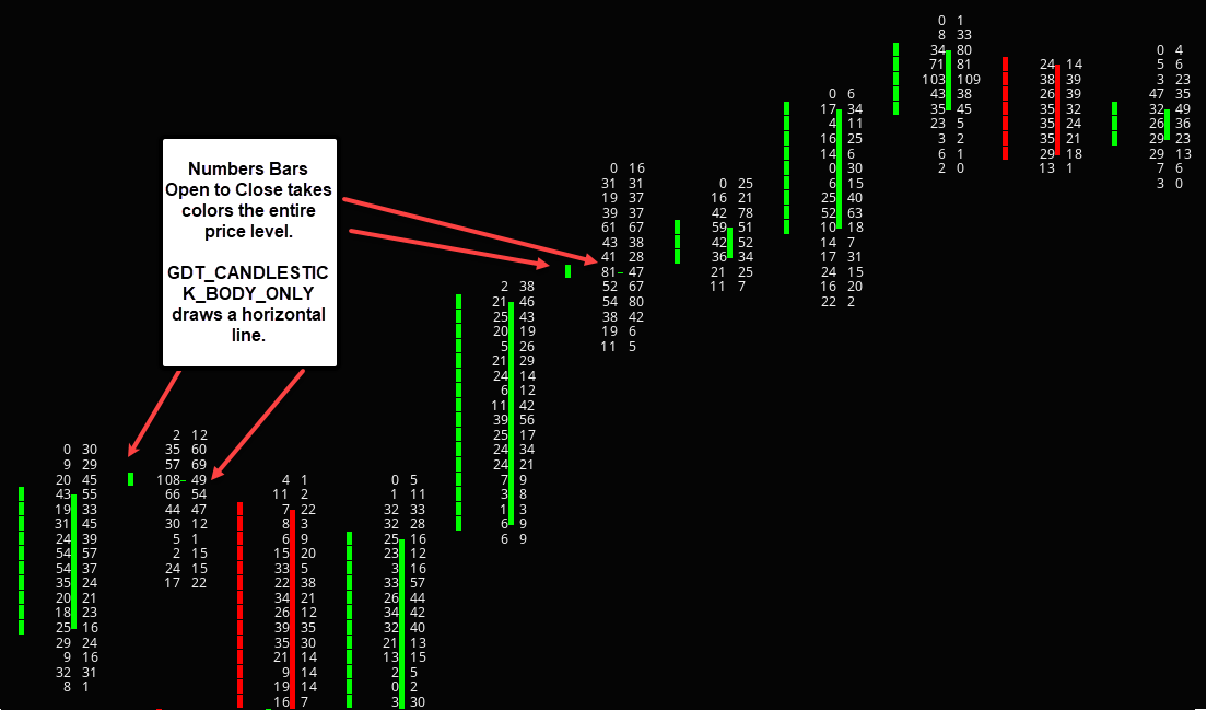

I've tried both using the Study/Price Overlay and developing a custom study using GDT_CANDLESTICK.
The issue I have come across is that GDT_CANDLESTICK draws the body from the tick price level, not the entire price level when applied to a Numbers Bars chart. Attached is an annotated screenshot.
If this is the only way to display a candlestick on a Numbers Bars chart, i.e., via overlay, what options are there to have the candlestick body take up the entire price level as this is important when the Open-Close range is 1-2 ticks?
Thank you!

[2025-11-24 20:16:49]
That is how the price bars are drawn outside of the Numbers Bars options themselves.
