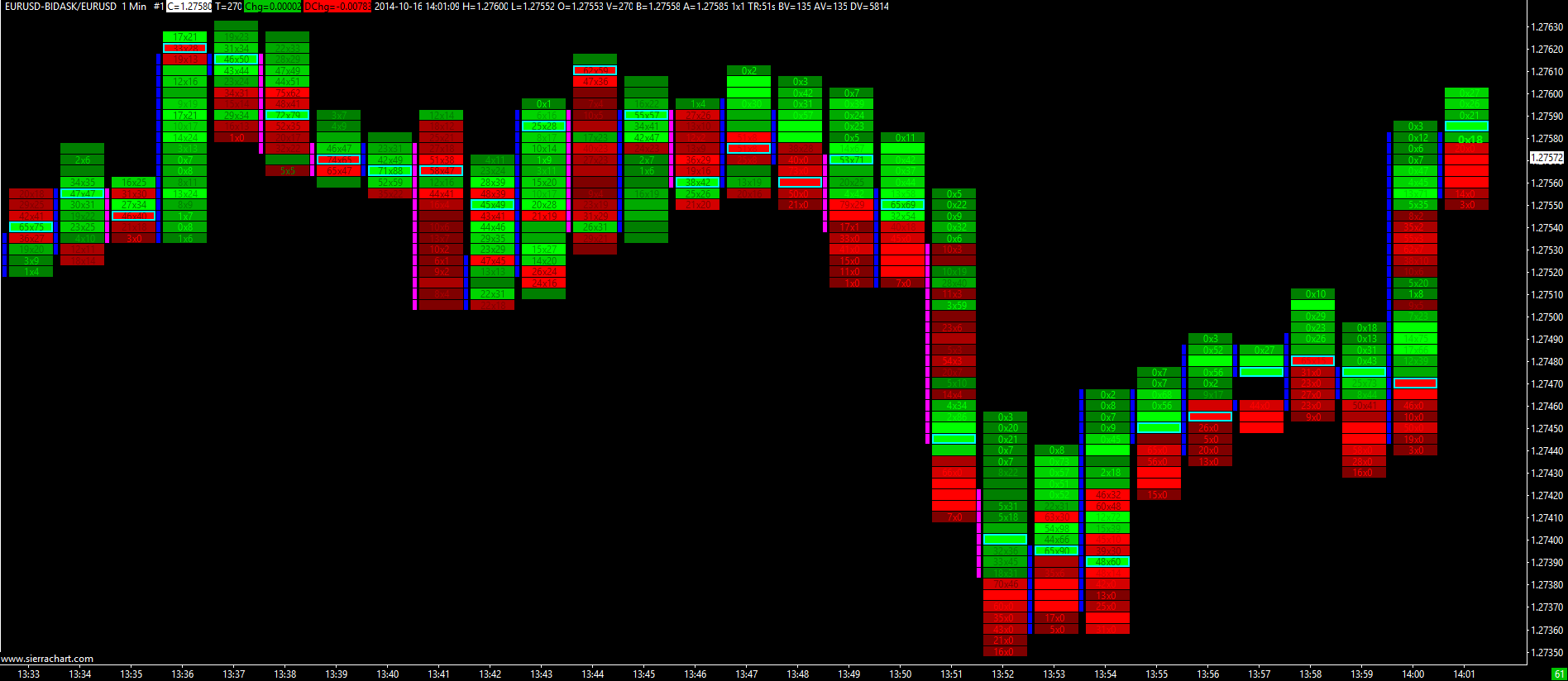

thx for your prompt response, I've attached my chart image http://www.sierrachart.com/image.php?l=1413468072371.png

[2014-10-16 16:36:53]
1. Do not use a data recording suffix like -BIDASK for the symbol with Numbers Bars charts. This will not work properly.
2. For information about volume for Forex, refer to:
Sierra Chart Real Time and Historical Forex and CFD Data Service: Volume Data for Forex and CFD Markets
3. What you need to do is set the Scale Range for those studies to Same As Region:
Chart Scale and Scale Adjusting
Date Time Of Last Edit: 2014-10-16 16:37:29
