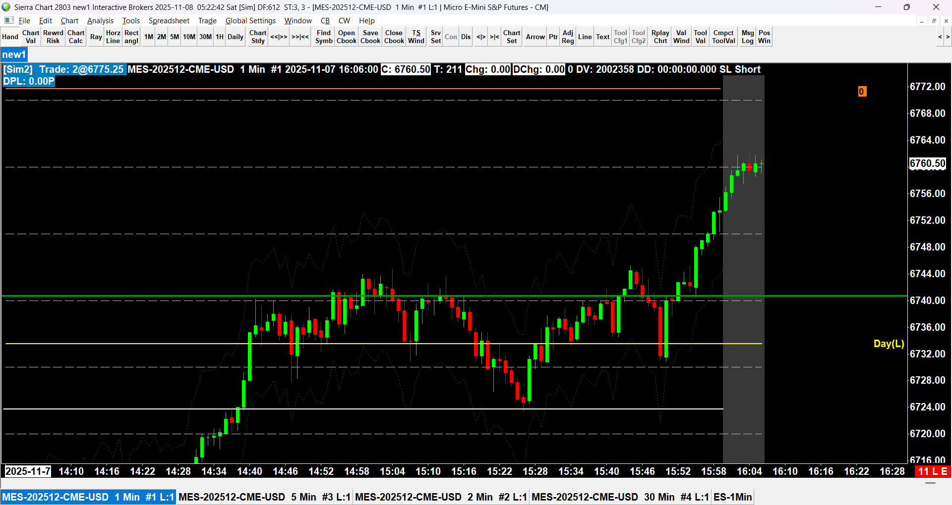

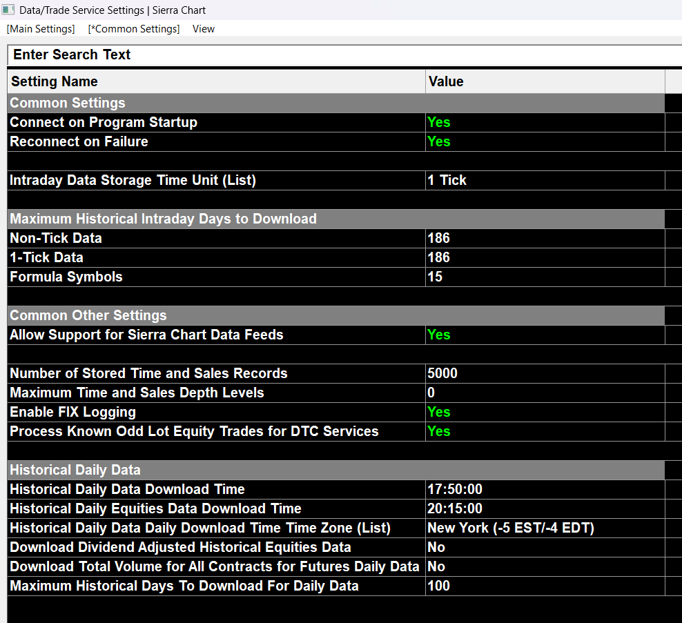

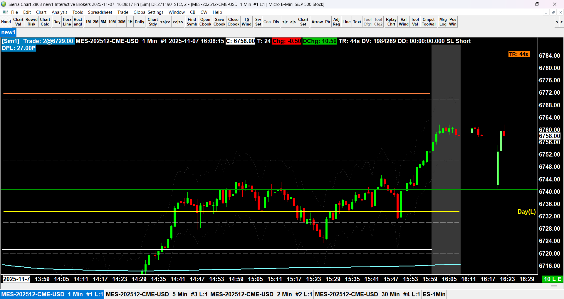

After yesterdays trading session, I decided to look as some historical intraday charts (1min) but my "Data/Trade Service Settings" would only allow me to look back 7 days. I changed it 100 and allowed the PC to download (it took some time). This morning I fired up the SC and the charts were there but when I looked at yesterdays chart there were significant differences. I've since repeated the procedure, setting the days back to 10, and I can not get back yesterdays charts as I was trading it.
Fortunately, I took screens of yesterdays chart so I can visually compare.
I am NOT using Denali as I get my data from Interactive Brokers but even so, there should not be discrepancies, right?
Right now, I have no faith in any charts, either historical or going forward, until I understand what's going on.
Any help is greatly appreciated
imageScreenshot 2025-11-08 102430.png / V - Attached On 2025-11-08 10:31:54 UTC - Size: 68.51 KB - 176 views
imageScreenshot 2025-11-08 102251.png / V - Attached On 2025-11-08 10:32:06 UTC - Size: 90.51 KB - 169 views
imageScreenshot 2025-11-07 210823.png / V - Attached On 2025-11-08 10:32:16 UTC - Size: 96.12 KB - 199 views

John - SC Support - Posts: 48659
The following statement is not correct:
After all the data up to current moment has been downloaded from Denali, IB will take over and do the streaming.
You are either using Interactive Brokers data (or whatever service you are connected to) or you are getting the Denali data. There is no combination of the data.
We did do this (historical data from us, real-time data from the service) at one point, but we stopped it several years ago.
