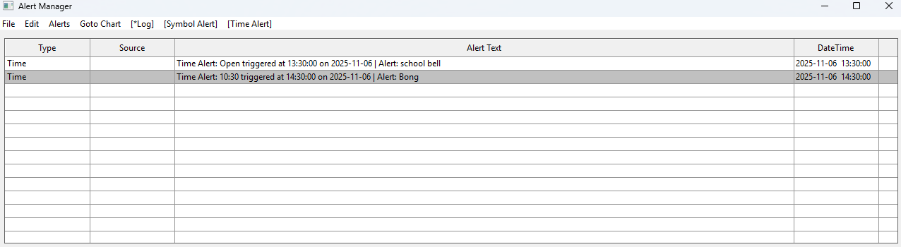

I have 2 alerts that occur every day that have no trigger on the alert manager. How can I remove them? Pic included.

The are "Time Alerts". There is a tab at the top of the "Alert Manager" for "Time Alert". Select that tab and you can add/remove those alerts. Refer to the following:
Alerts Manager: Time Alerts

Thank you. I must have set them a long time ago for the open and first hour and forgot how to set them. I've changed the times to reflect Standard Time so they ring at the right times. Hopefully I remember to change them again.
