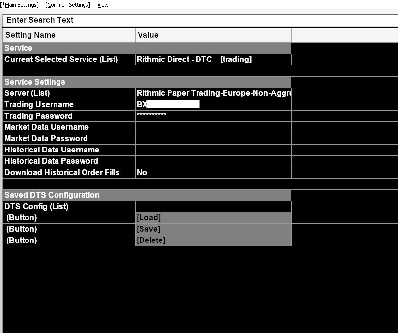

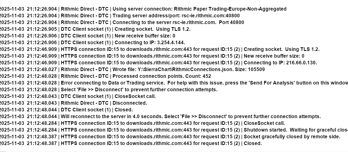

Hi, I don't know but sierra cannot connect tu data feed. I've always used bulenox but with Teton data (see attachment) but now it doesn't work. Why doesn't it connect?

[2025-11-03 21:33:24]
John - SC Support - Posts: 48658
The exchange that you had active in October did not automatically renew on November 1, 2025, due to insufficient funds in your account at that time. You need to add funds to your account and then you can re-activate the exchange (or other exchanges) at the following link:
https://www.sierrachart.com/UserControlPanel.php?page=DenaliDataFeed#Exchanges
[2025-11-05 18:02:55]
User931951 - Posts: 79
I don't understand why it stops connecting every day. Yesterday I got the Exchange package and it worked. Now I turned on Sierra but it won't connect. I don't understand all these problems.

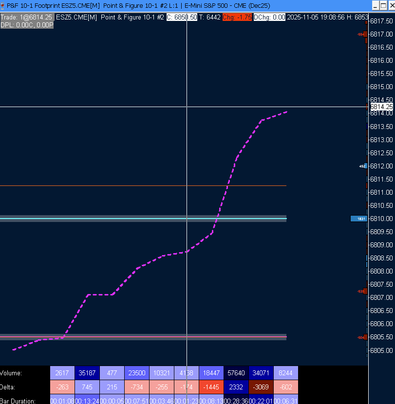

I don't understand why I can't even see the footprint, it's incredible

[2025-11-05 20:14:21]
In terms of connectivity, you are trying to connect to Rithmic. Rithmic is known for having issues with their connectivity. You need to talk to them about this, as they own the software for the connection between Sierra Chart and Rithmic.
The only thing we can suggest is to try a different server when you are having connectivity issues with Rithmic.
With regards to the Numbers Bars, it doesn't look like you have the Numbers Bars study on that chart. Check to ensure that the study is added to that chart. If it is, then get that chart by following these instructions:
