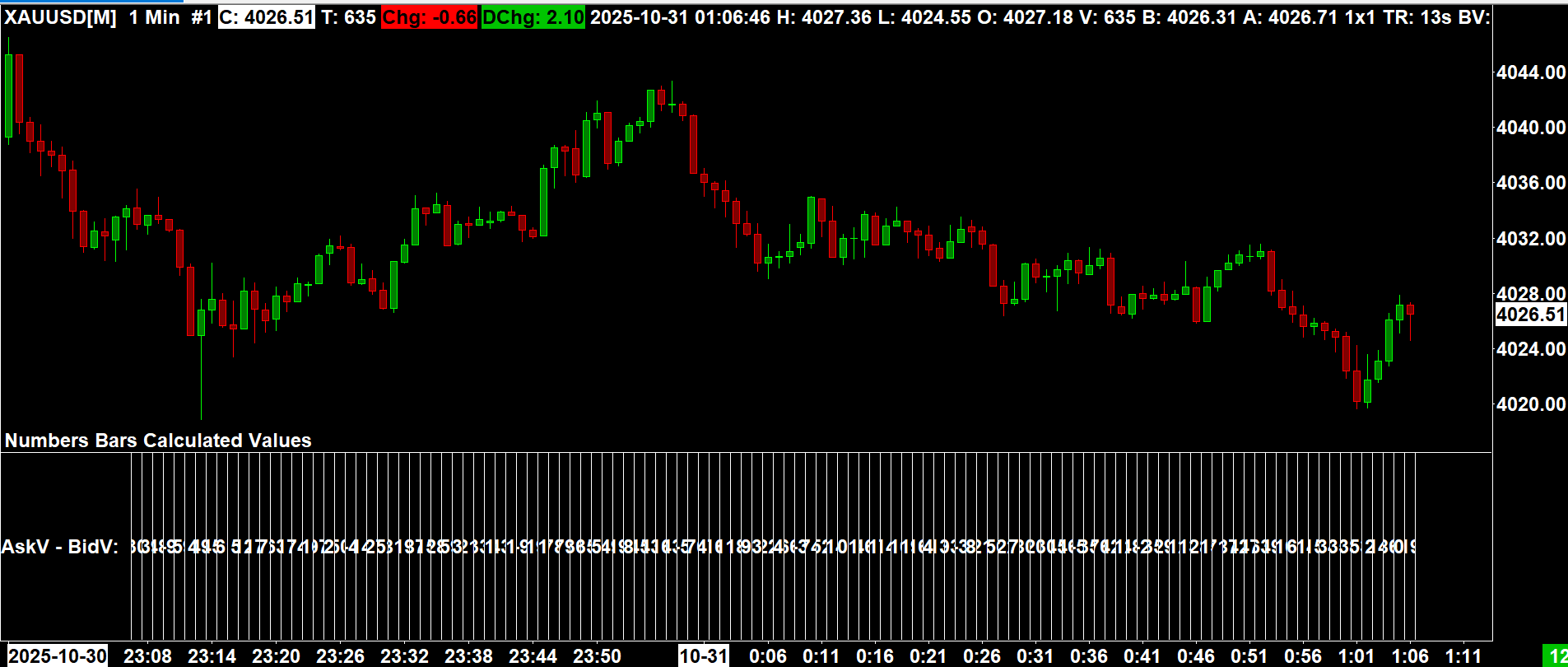

Hi i have been having problems loading certain indicators on my sierra chart and i do not know what is the issue. I have attached two pics one is of a chart how i would like my sierra chart to look like the other is the chart how it looks like if i add the bar number calculator which i need for delta reading. Any help is to how to fix the issue as seen the other picture will be appreciated

You have the "Numbers Bars Calculated Values" study added, as shown at the bottom of the window, but you do not have the Numbers Bars study itself. Refer to the following:
Numbers Bars
