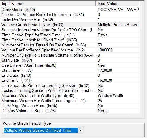

Hello, I'm struggling to get my volume profile to start at Globex open instead of being anchored to NY open.
I've changed the Volume Graph period type to half a dozen things and changed the start time and end time half a dozen times and It just will not start from globex open...
Only way I've been able to achieve when it starts is by messing with my chart session times, but then price is reported incorrectly(Like my previous post)
Please halpppp.
Thank you.
imagefffff.jpg / V - Attached On 2025-10-24 15:02:46 UTC - Size: 119.11 KB - 221 views

[2025-10-24 15:32:07]
There is not a way to have the option for "Multiple Profiles" to be assigned to a Start Time other than what is set in the Session Times. If this is what you are wanting, then you would need to use a separate chart to have your Volume Profiles setup as you want to view them versus the Bar Data in another chart.
Another option would be to have a single Volume Profile set to the Start Time you want. To do this, set "Volume Graph Period Type" to "From Start Time to End" (or one of the other options, depending on exactly how you want the ending time to be). Then set the Start Time as you want it for that profile. Refer to the following:
Volume By Price Study: From Start Time To End
