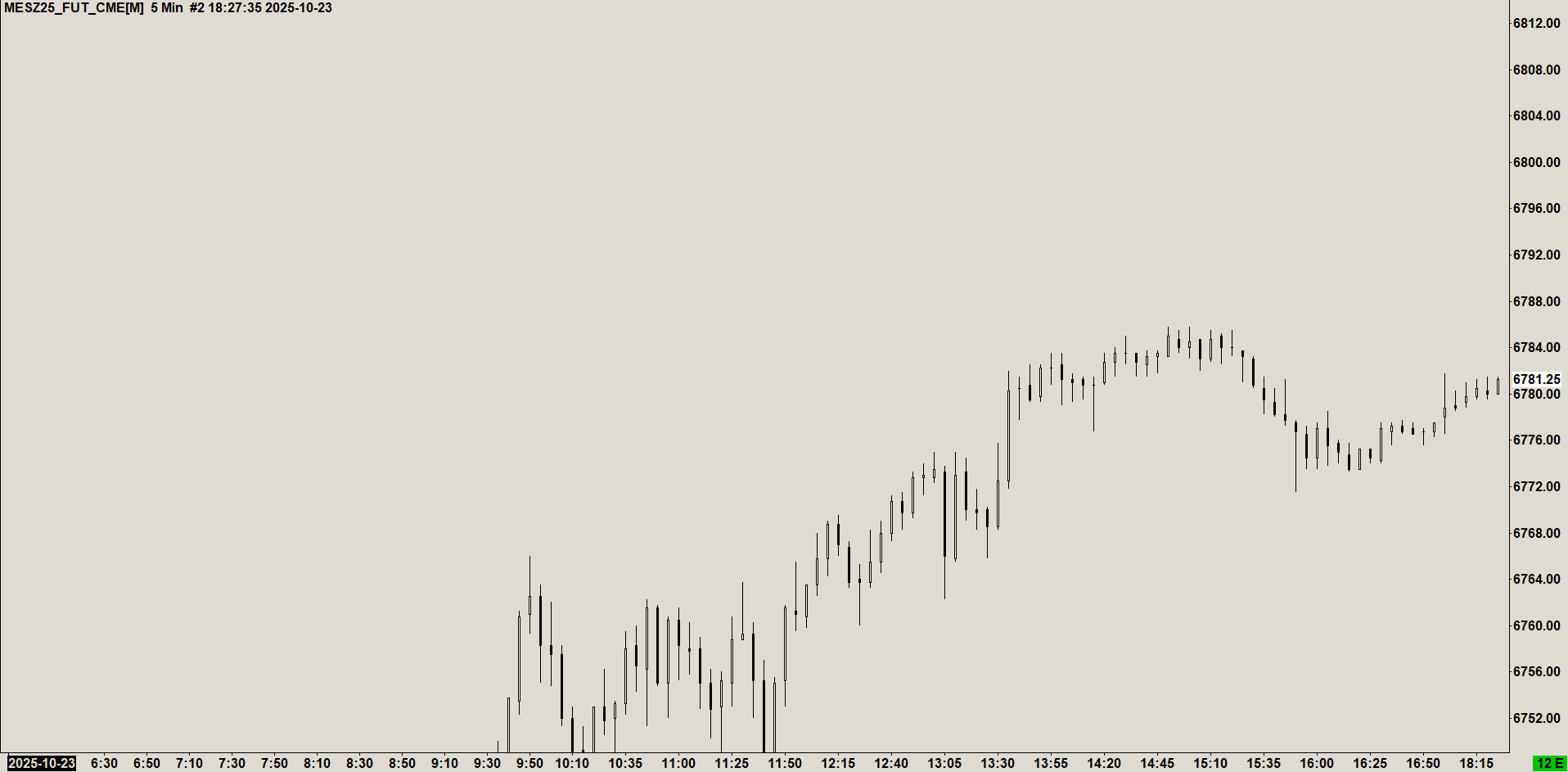

| User654358 - Posts: 14 |
I had a Numbers Bars study on the chart. I had volume in column 1 and Delta in column two. Other studies applied such as a candlestick in the middle, cumulative delta number above each bar and a volume number beneath etc. When I paid for a Sierra Chart account a week or two ago it all disappeared leaving only the candlesticks. Here is a photo of a the chart copied. It's cleaned per all instructions. I begin with just 5 minute candlesticks. When I apply the Numbers Bars study the chart is then blank and a message states that Numbers Bars study not supported on service package. I've tried the force login procedure to no avail. Hopefully this more or less blank chart will show what I have done incorrectly. Thank you. https://www.sierrachart.com/image.php?Image=1761258268573.png |
| [2025-10-23 22:28:29] |
Before the Numbers Bars study is applied. https://www.sierrachart.com/image.php?Image=1761258469237.png |

| [2025-10-24 14:49:01] |
| John - SC Support - Posts: 48653 |
You need to change your package to Package 11. To do this, follow these instructions: Sierra Chart Purchase and License Information: Changing Package For the most reliable, advanced, and zero cost futures order routing, use the Teton service: Sierra Chart Teton Futures Order Routing |
