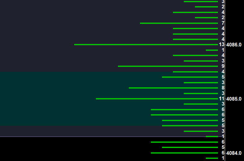

I have compressed my footprint chart by increasing the tick size to a multiple of the standard size. This seems to cause issues with the market depth historical graph highlighting. For example, I have set any volume above 10 to be highlighted. This works reliably for the normal tick size, but after increasing the tick size, it only works sometimes. In the attached screenshot, see how the combined price 4085 is highlighted due to the limit order with 11 volume, but the price 4086 is not highlighted despite there being a limit order with volume 13. I initially thought it somehow takes the average of all limit orders within the price increment, but that's not it. From my observation, it only highlights based on the last changed price, which is undesirable behaviour. E.g. if within the same price increment, a limit order changes from 9 to 10, it highlights the 10, but if another one changes to 9 afterwards (while the 10 remains unchanged), the highlight disappears. It should always highlight based on the highest volume within a price increment.
image2025-10-22_20-11.png / V - Attached On 2025-10-22 18:25:53 UTC - Size: 10.28 KB - 187 views

We are not fully understanding your setup, particularly from the image.
The DOM and the Market Depth Historical Graph have different controls for aggregating the Market Depth data.
For the DOM, the following settings apply:
Chart Settings: Market Depth Combine Increment in Ticks (Chart >> Chart Settings >> Market Depth menu)
Chart Settings: Apply Combine Increment in Ticks to Other Market Data Columns (Chart >> Chart Settings >> Market Depth menu)
For the Market Depth Historical Graph, it is the following Input:
Market Depth Historical Graph: Combine Increment in Ticks
If you do not have these two different items set to the same aggregation, then you really can not compare what is occurring.

It's not about any of these settings. You can easily reproduce.
I opened the default Sierra Chart ExampleChartbook and only did the following: set MNQ as Symbol on the first chart, increased tick size from 0.25 to 2.5, enabled "Draw DOM Graph on Chart", and added Market Depth Historical Graph Study with default settings (I used "Reset Defaults"). The issue presents itself with just that.
