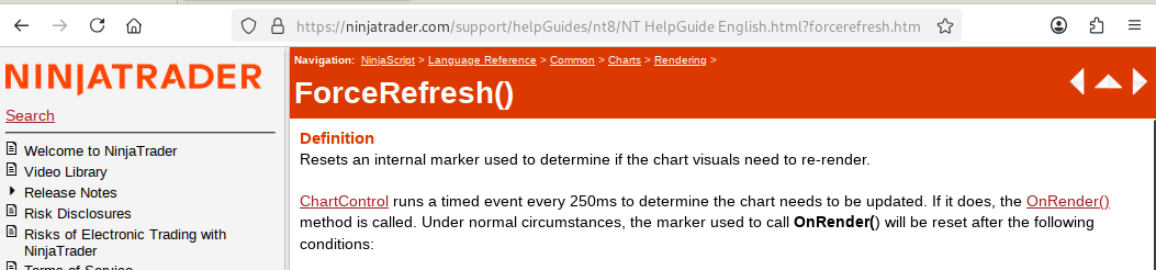

Cesium - Posts: 179
Youre worried about 9ms, ninja doesnt even update faster than 250ms.
That's 4 times per second in case you were confused.
image2025-10-19_11-55-51.png / V - Attached On 2025-10-19 15:56:09 UTC - Size: 50.87 KB - 263 views
