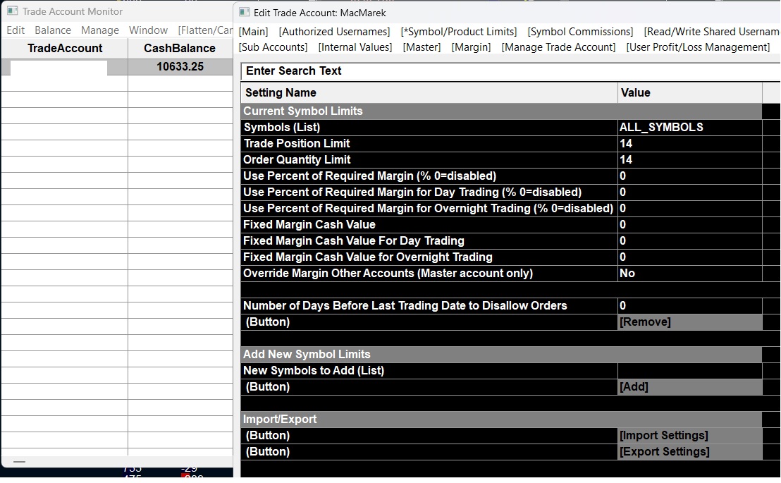

Hello Sierra Chart Support Team,
I am writing to report a sudden issue with a limitation on the number of open orders I can place on my Trading Evaluator simulated account.
Sierra Chart Version: 2800
Operating System: Windows 11
For the past few days, I have been unable to have more than 5 orders (including working/pending orders) open at the same time. If I try to place a 6th order, it gets rejected.
This is a recent problem. Previously, about two weeks ago, I was able to place up to 14 orders simultaneously without any issues. I want to emphasize that I have not changed any of my settings in Sierra Chart during this time. I have attached a screenshot of my current Trading Evaluator service settings for your reference.
I am trading micro contracts (like MES) and my simulated account balance appears to be more than sufficient, so I do not believe this is a margin issue. The limitation seems to be on the specific number of orders, not the overall position size.
I am not sure what is causing this issue, whether it is a recent change in Sierra Chart or a setting I might have inadvertently changed myself. My current account balance was sufficient for a higher number of orders before. Please let me know what, if anything, I can change on my end to restore the ability to use more than 5 orders at a time.
Thank you for your time and assistance.
Best regards
imageTrading Evaluator.jpg / V - Attached On 2025-10-09 15:09:58 UTC - Size: 230.96 KB - 141 views

I wanted to follow up and let you know that I have managed to solve the problem. The issue was with the setting: Trade account monitor/ account name/ Manage/Edit Trade Account/Main/>margin Settings and "Use Percent of Required Margin (%)"
I don't fully understand how this setting works or why it was set to 100%, but after I changed the value to 10%, everything has returned to normal and the order limit issue is gone.
