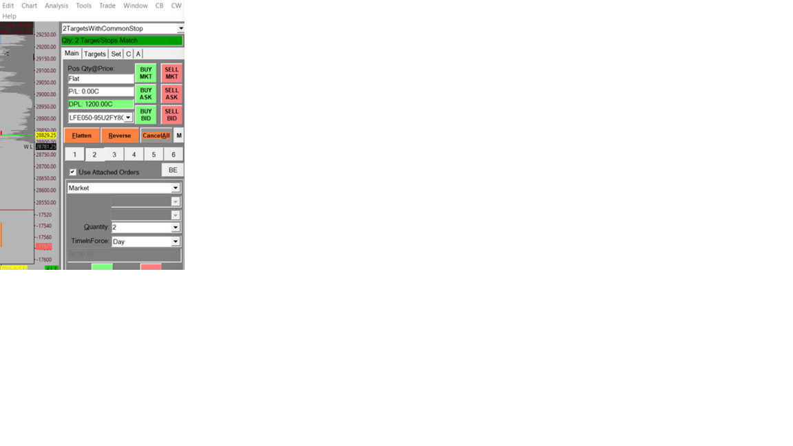

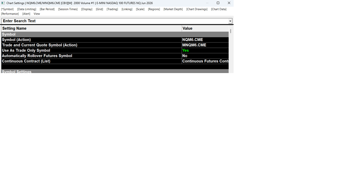

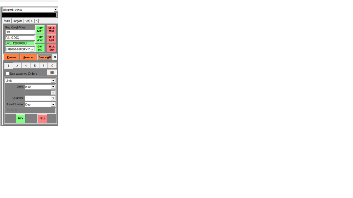

User635925 - Posts: 23
Could you please check what is the issue with trade window (attached)
my profit is $1200 but it is showing $12000
i am using NQ Chart and trading MNQ, but when i am removing NQ Symbol and using MNQ Symbol its working fine
Thanks,

[2026-06-07 02:08:16]
Sierra_Chart Engineering - Posts: 25447
Refer to the information here:
Chart Settings: Updating Currency Value per Tick for Trade Symbol

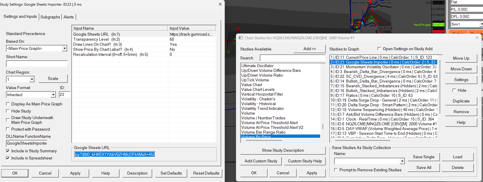

Hi
recently i subscribed to a 3rd party sierrachart study
i tried few settings and i contacted them as well, in 1 sierrachart instant its showing the levels and in other sierrachart instant i am not getting the display of those study levels (Attached screenshot for your reference)
could you please let me know what is the issue.

[2026-10-05 14:13:13]
John - SC Support - Posts: 48608
You need to contact the developer of that study.
Please start a new support ticket for new issues. Do not use this same thread for unrelated issues to the original post.
