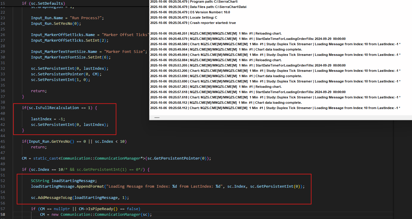

Hi Support, I have created a namedpipe connection which works great, I can pass data through it just fine. My issue is that when I load SierraChart and either the data loads when the chartbook is opened or I 'reload and recalculate' the chartbook, SierraChart is cycling through the data twice. I have not been able to figure out why but it happens every time. Is there a known reason why it would do this?

User238948 - Posts: 13
Hi John,
Thanks for the reply. Here is a screenshot that hopefully shows that its loading twice. I ran it a few times to show that it happens every time.
You can see it reloads the chart > I print my message at index 10 (I burn the first few indexes) > SC confirms loading is complete > My message gets hit again which is the issue.
I can also see this is happening on my external app that is receiving the data over the named pipe and so far I have had to handle it doing these two cycles.
Let me know if you need any further info.
imageSierraChart - Support.png / V - Attached On 2025-10-06 16:29:12 UTC - Size: 135.05 KB - 224 views

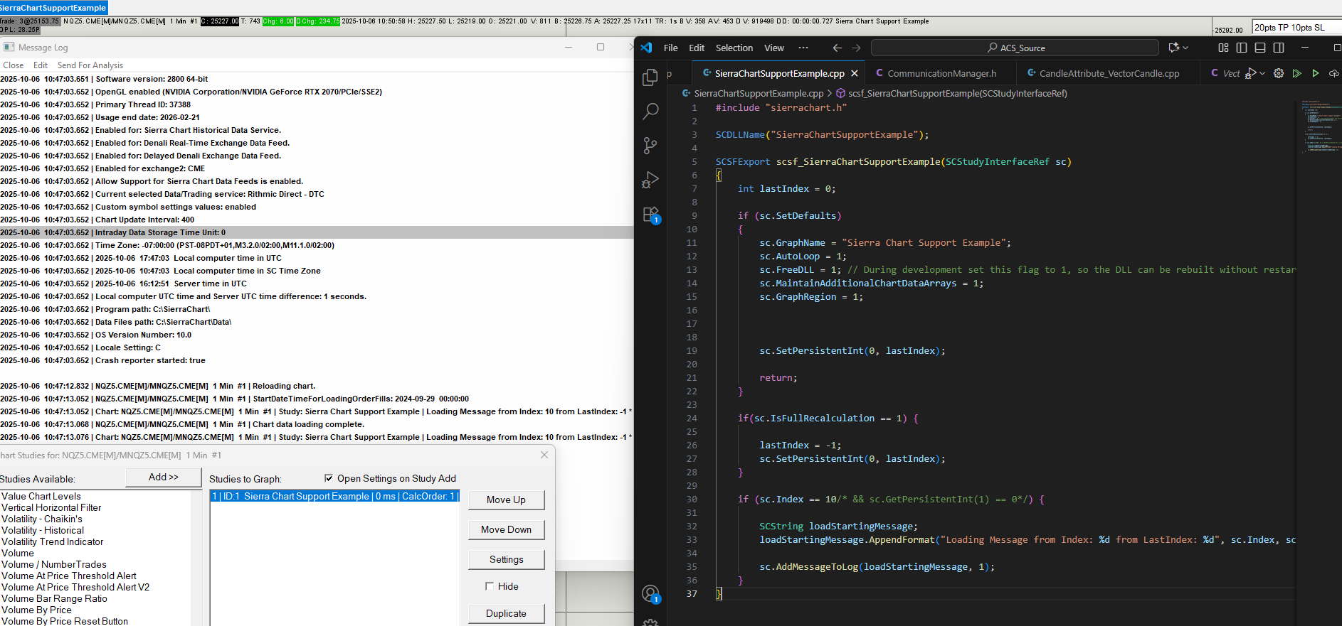

[2025-10-06 17:55:06]
If remove them all then I would only get the detail reloading chart and chart data loading complete messages which would hide the fact its loading twice.
Instead, I have taken a copy of the chartbook and created a very basic study to still show that its loading twice. I have also attached a screenshot and the chartbook and study.
You can see in the screenshot the default SC messages are printed once but the study message is printed twice.
hopefully this is helpful
attachmentSierraChartSupportExample.cpp - Attached On 2025-10-06 17:52:36 UTC - Size: 1.04 KB - 183 views
attachmentSierraChartSupportExample.Cht - Attached On 2025-10-06 17:52:56 UTC - Size: 11.21 KB - 181 views
imageSierraChart - Support - 2.png / V - Attached On 2025-10-06 17:53:09 UTC - Size: 208.13 KB - 166 views

[2025-10-06 22:02:23]
Sierra_Chart Engineering - Posts: 25481
Chart Trade Mode will not cause a reloading of chart data twice. This cannot happen.
If you do not see Reloading Chart twice in the log then it is not reloading twice.
The logging that you have does not indicate reloading of chart data twice. It only indicates a full recalculation which is completely different. You are confusing the two things.
