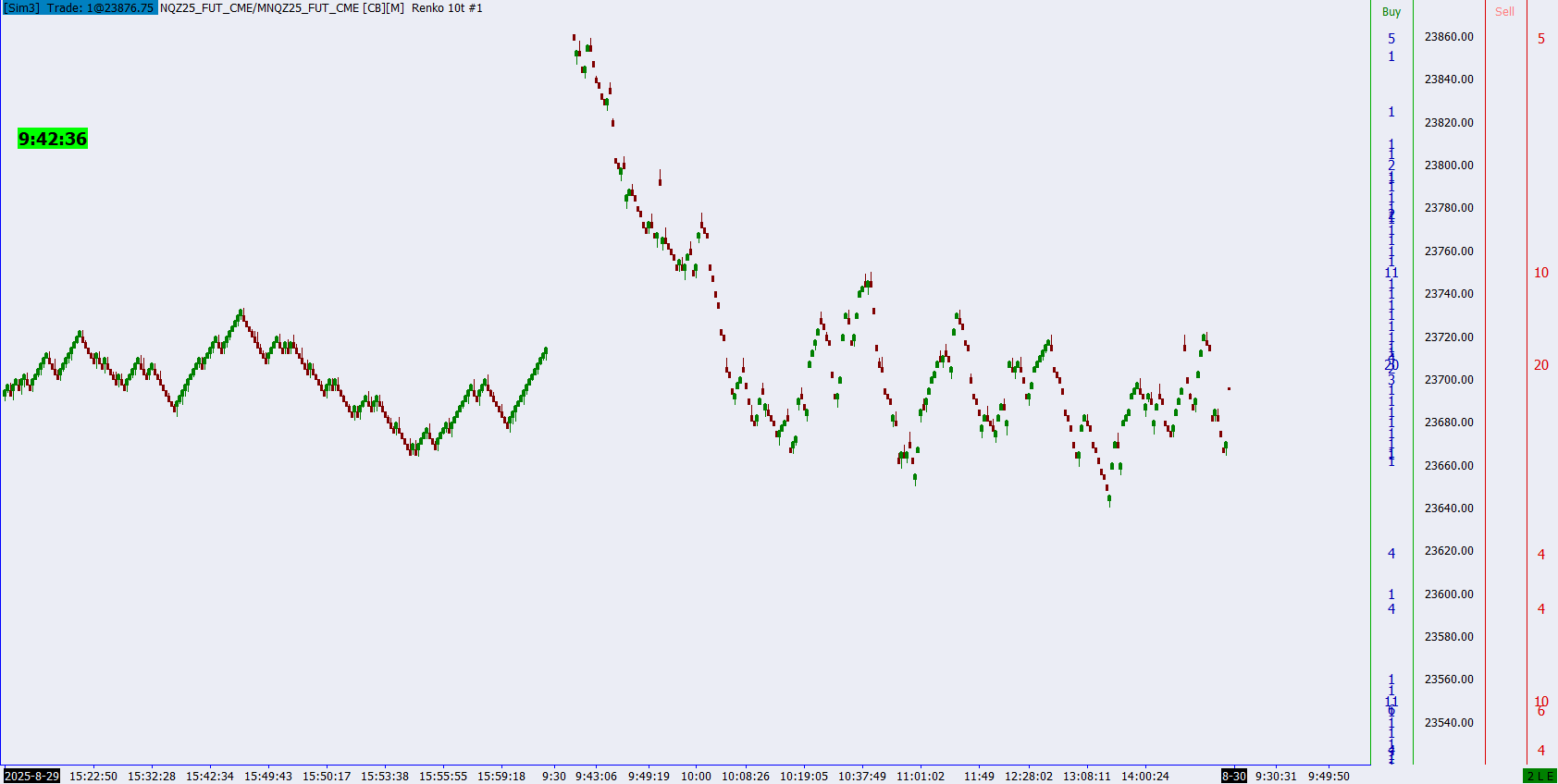

I began having an issue with a chart this afternoon and I cannot figure it out.
I've been working with a fairly bland, 10-tick Renko chart while using a custom indictor for testing. This is a Futures Chart (NQ/MNQ), a Continuous Futures Contract, Date Rule Rollover, Back Adjusted. I wanted to test specific periods, monthly periods for instance, so I began setting the Chart>Chart Settings>Data Limiting to "Use Date Range" and entering dates in the Date Range section below that.
I'm not going back far. I began running into problems when I tried to load 2025-08-01 to 2025-08-31.
For testing, I have a bit of a quirky time frame. My Intraday Session Time is normal and set from 09:30:00 to 15:59:59. My Evening Session is set with a Start Time of 09:15:00 and an End Time of 09:29:29.
The problem appears on the last day, 2025-08-29 after what you would expect to be the last bars of the session, around 16:00. I see choppy, broken bars that begin with a time stamp of 09:24:08, and somewhat similar prices as the start of the day (8/29), and the 2025-08-29 date on them. It's very strange.
I assumed I had a corrupt chart/chartbook so I created a new CB and a new chart from scratch. Same issue. If I switch from Use Date Range to Use Number of Days to Load, the problem goes away.
I then went to my standard instance of SC, on my normal daily chart and tried to switch that to "Use Date Range" and the same problem appeared.
Am I missing something?
I'm attaching the new CB I created.
Thanks for the help.

[2025-09-30 14:21:53]
Sierra_Chart Engineering - Posts: 25481
First re-download the data for September and December contract months following these instructions:
[2025-09-30 18:50:49]
User98657 - Posts: 420
I followed those steps, and it did seem to correct the issue. The issue only seemd to be related to this most recent roll.
