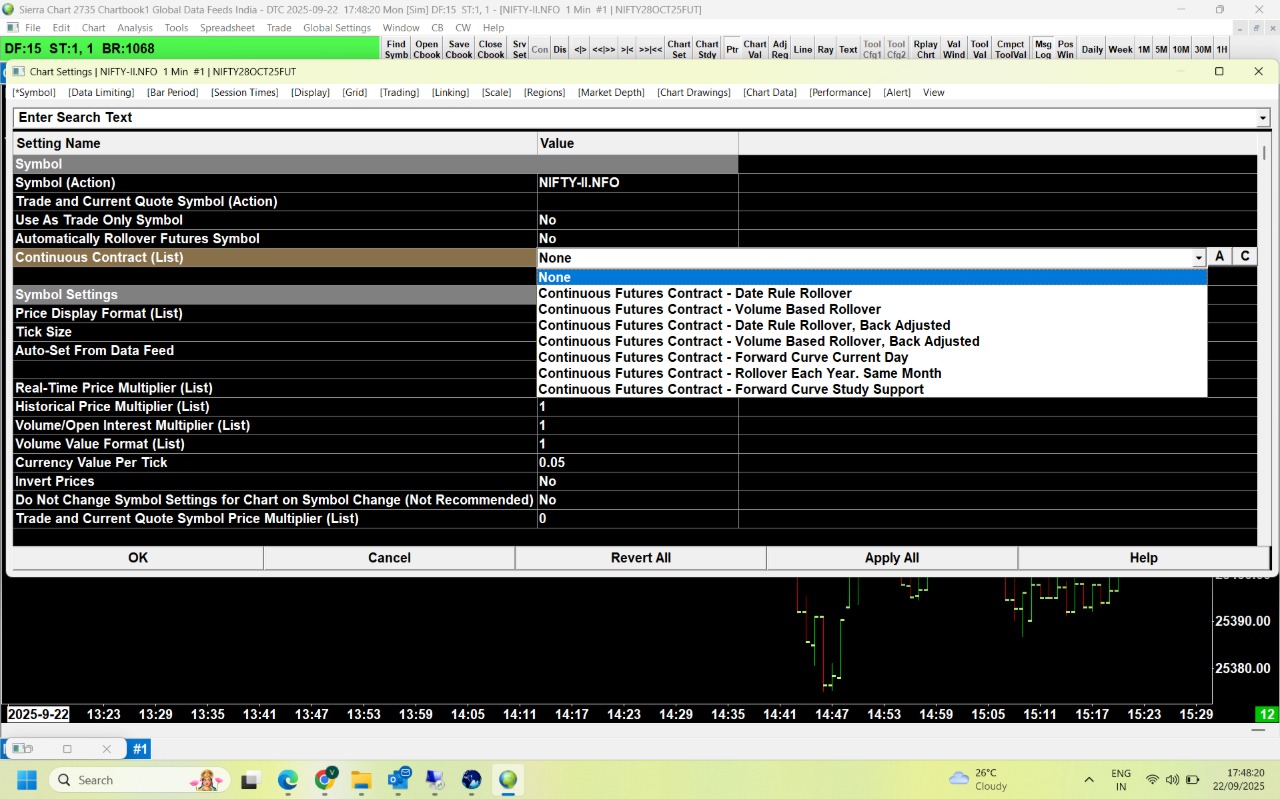

Kindly review the email below. Our customer has raised a few points regarding data in Sierra Chart that we need to understand and address:
1. Mismatch in VWAP Values / back-adjustment
How is VWAP calculated on Sierra Chart for 1-year data on NIFTY-I.NFO with daily candles for adjusted and un-adjusted data - given there is no data for separate contracts as well as their expiry date is available for this symbol?
We feel until contract-wise symbols are mapped with NIFTY-I.NFO and their respective expiries, proper adjustment will not occur. Please clarify.
Reference: Please see Screenshot 1 provided by the customer.

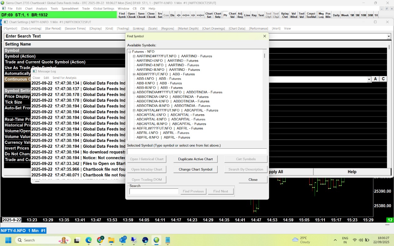

3. Incorrect/Outdated Future Symbols in Sierra Chart
There is a pre-populated list of Future symbols in Sierra Chart. The NFO symbols frequently change, and outdated symbols causes inconvenience. Is this list hard-coded in SierraChart or is there a way for this list to update automatically (we can share how SierraChart can programmatically fetch latest symbol list from our server). If not automatically, is there a way we can manually change update these symbols in bulk - please let us know.
Reference: Please see Screenshot 2 provided by the customer.
