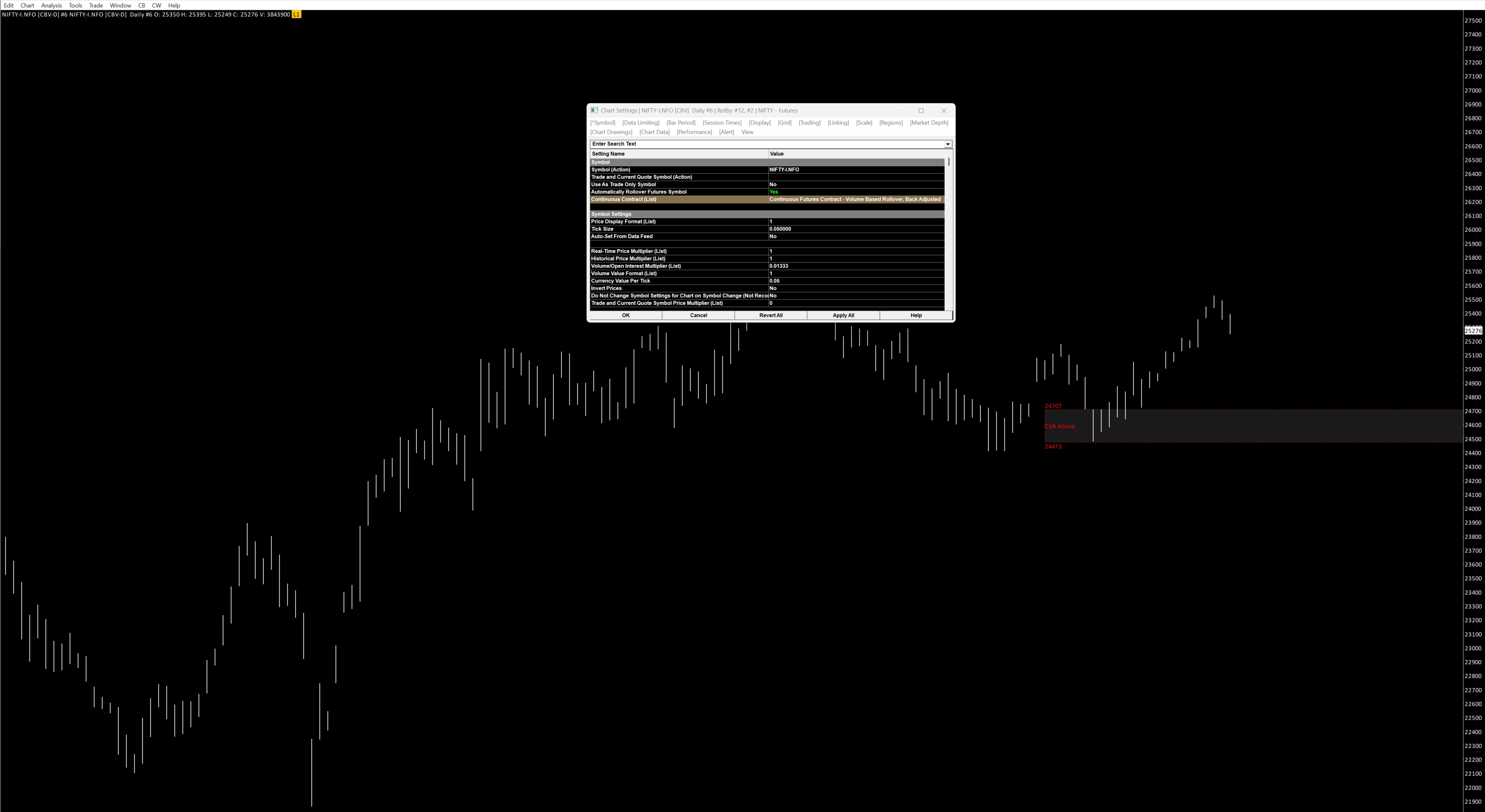

Hello Team,
Kindly review the email below. Our customer has raised a few points regarding data in Sierra Chart that we need to understand and address:
1. Mismatch in VWAP Values / back-adjustment
How is VWAP calculated on Sierra Chart for 1-year data on NIFTY-I.NFO with daily candles for adjusted and un-adjusted data - given there is no data for separate contracts as well as their expiry date is available for this symbol?
We feel until contract-wise symbols are mapped with NIFTY-I.NFO and their respective expiries, proper adjustment will not occur. Please clarify.
Reference: Please see Screenshot 1 provided by the customer.
2. Backfill Not as Promised
Customer query: Default backfill is 90 calendar days for 1-minute data, 4.5 months for 5-minute and 6 months for 15-minute data. When opening a 1-minute chart in SierraChart_64 (C_SierraChart), length of 1-minute data backfill shows correctly for 90 days. However, while changing periodicity to 5- or 15-minute, backfill length remains 90 days and does not increase to 4.5months (5minute) or 6months (15minute).
Suspected cause: We feel SierraChart is compressing already downloaded 1-minute data to form 5min/15minute candles instead of fetching 5- or 15-minute history separately.
Action requested: Can we modify this to fetch 5- and 15-minute history data separately? Or suggest solution
3. Incorrect/Outdated Future Symbols in Sierra Chart
There is a pre-populated list of Future symbols in Sierra Chart. The NFO symbols frequently change, and outdated symbols causes inconvenience. Is this list hard-coded in SierraChart or is there a way for this list to update automatically (we can share how SierraChart can programmatically fetch latest symbol list from our server). If not automatically, is there a way we can manually change update these symbols in bulk - please let us know.
Reference: Please see Screenshot 2 provided by the customer.

Dear Global Datafeeds Support Team,
I am writing to bring to your attention a critical discrepancy in VWAP values between TradingView and Sierra Chart when using Global Datafeeds. Please see the comparison below:
Platform & Adjustment
PY VWAP
CY VWAP
Notes
TradingView (Backadjusted)
25,374
24,621
Much higher PY vs Sierra → possible over-adjustment / handling of rollover premium
TradingView (Not Backadjusted)
23,395
24,100
More consistent, but still diverges from Sierra’s
Sierra Chart (Backadjusted)
23,495
24,122
PY lower by ~1,900 vs TV Backadjusted
Sierra Chart (Not Backadjusted)
23,495
24,122
Same as Sierra Backadjusted → suggests backadjustment not being applied at all
_____
Please note
1. There is a 1,900-point gap in PY VWAP between TradingView (25,374) and Sierra Chart (23,495).
2. CY VWAP differences are smaller (~500 points), but still material for trading.
3. Sierra Chart values are identical in both backadjusted and non-backadjusted modes, strongly suggesting that backadjustment is not functioning properly with your feed.
_____
Impact on Trading
VWAP is a critical institutional reference level. A 1,900-point discrepancy can:
* Lead to an incorrect market bias (bullish vs bearish).
* Cause entries/exits around false VWAP levels.
* Create inconsistency between platforms, undermining confidence in your feed.
_____
I request your urgent clarification on the following:
1. Is the data you provide for NIFTY backadjusted or not?
2. If backadjusted, what process/logic is being followed for adjustment?
3. Why does Sierra Chart show identical VWAP values for both modes?
Given the scale of the discrepancy and its direct impact on trading decisions, I request a detailed written clarification within 7 working days.
Best regards,
Nalin

imageScreenshot - 1.jpg / V - Attached On 2025-09-25 03:23:55 UTC - Size: 229.9 KB - 212 views
imagescreenshot 2.jpg / V - Attached On 2025-09-25 03:24:14 UTC - Size: 283.53 KB - 153 views
imageNIFTY SC-GDFL.jpg / V - Attached On 2025-09-25 03:24:31 UTC - Size: 585.84 KB - 185 views
