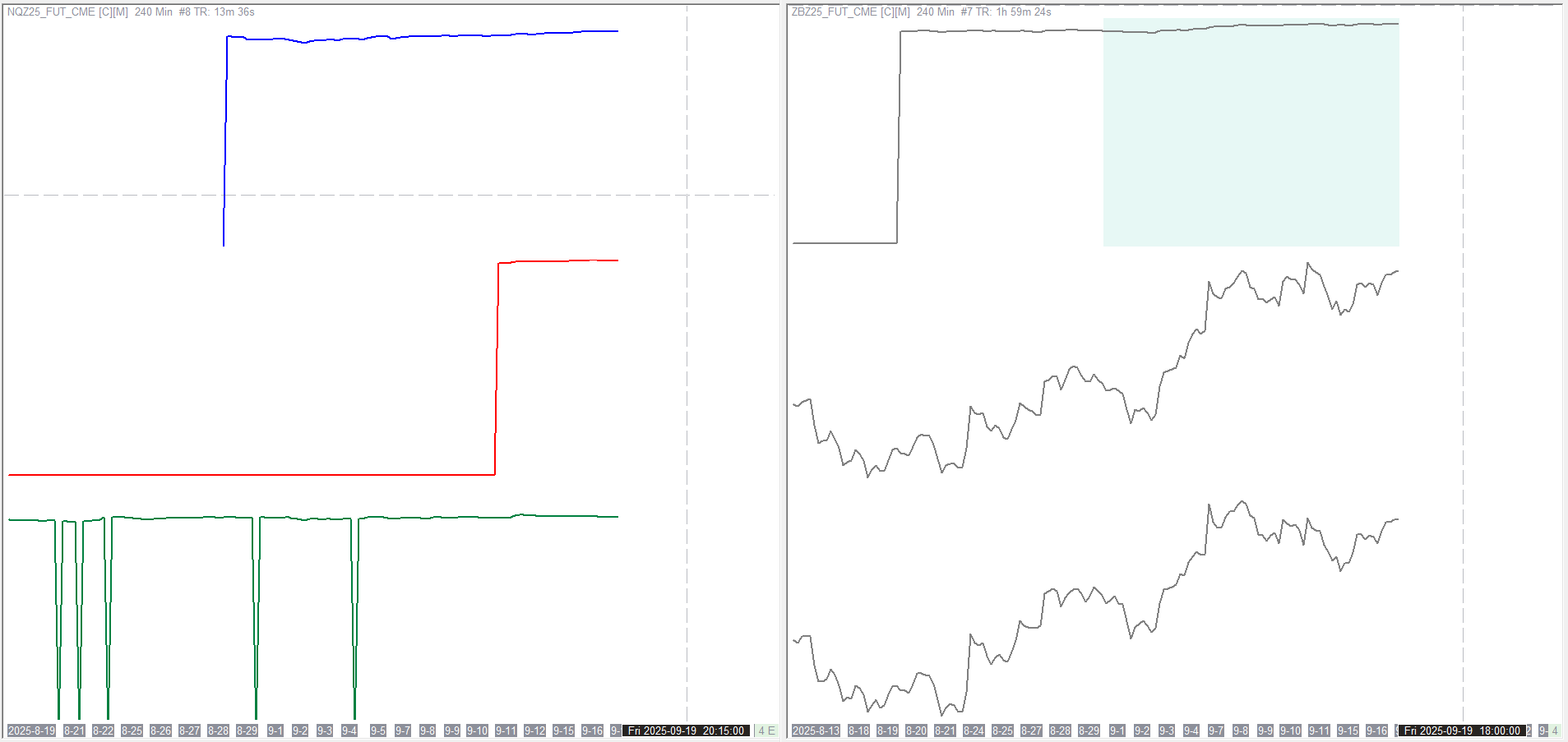

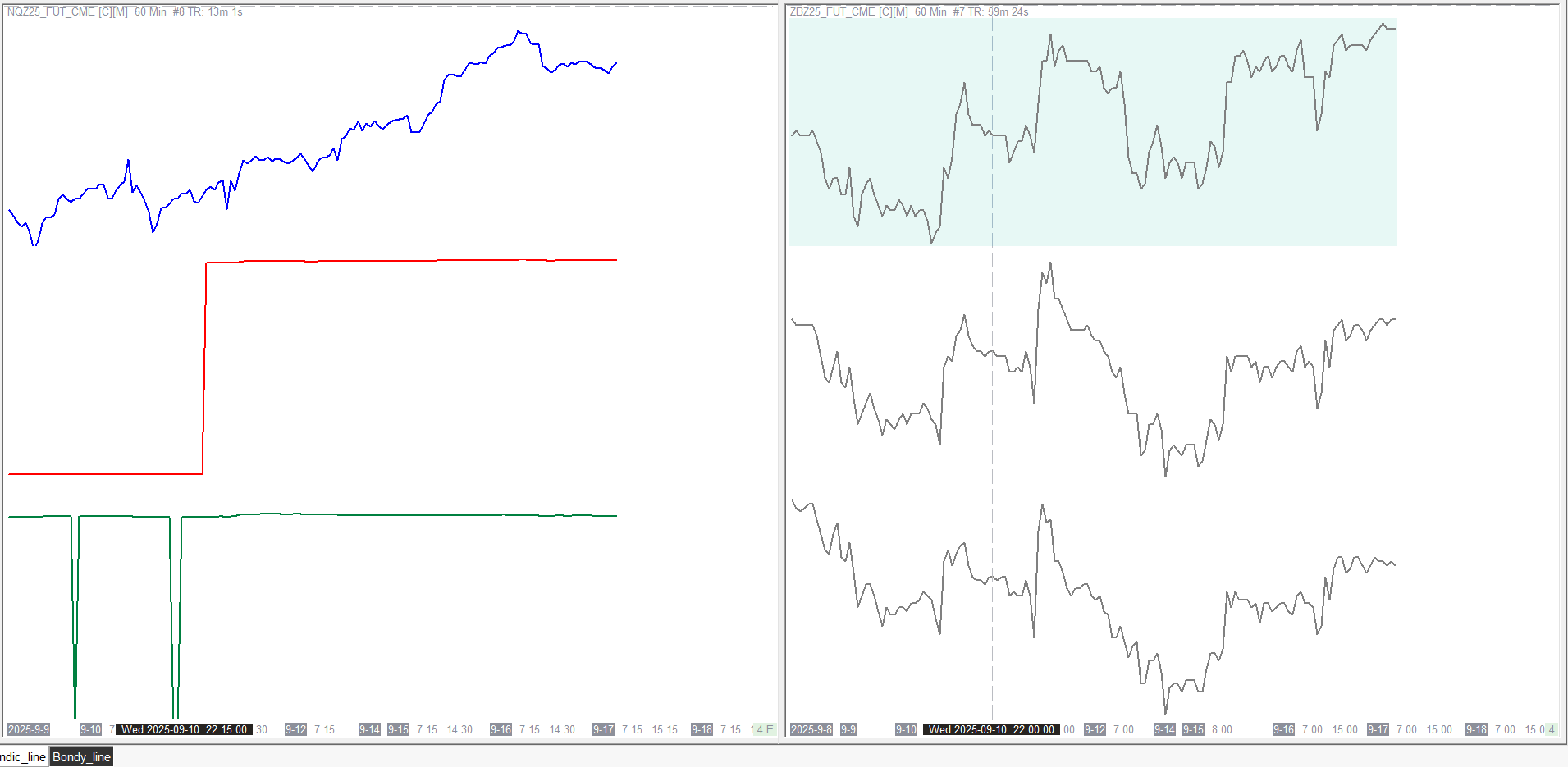

I would like to compare three charts using charts as line on bar low... I found a solution here on forum, by using Add additional symbol + Moving Average simple (set to Low + Length 1).
It is working until I switch to 1 hour or 4 hour chart, than some of symbols show strange lines (see screenshot). Is there way to fix that?
Additional question: Is it possible to synchronize height of all regions?
https://www.sierrachart.com/image.php?Image=1758096838819.png
Thanks you
Tom

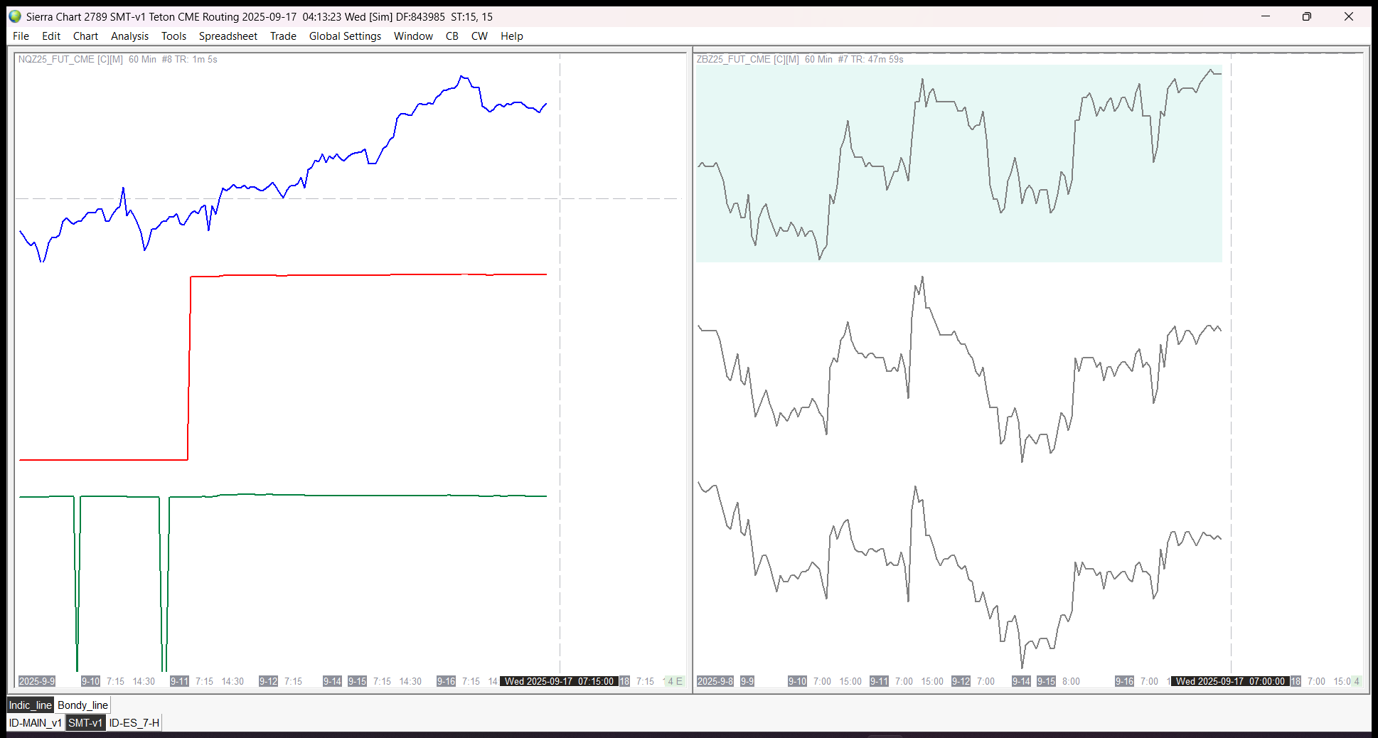

tokauo - Posts: 56
Here it is, with screenshot of it.
imageSnímek obrazovky 2025-09-17 190430.png / V - Attached On 2025-09-17 17:05:31 UTC - Size: 13.98 KB - 250 views
attachmentINDL.Cht - Attached On 2025-09-17 17:05:55 UTC - Size: 5.46 KB - 213 views
[2025-09-17 21:37:45]
There are too many issues with how you have this setup. Problems with Inputs set to bad values (Price Multiplier in Add Additional Symbol) along with wrong scaling (Independent for Add Additional Symbol) and the "Moving Average - Simple" is not the best solution, you really need to use the "Study Subgraph Reference" and set the "Draw Zeros" Input to "No".
Attached is a Study Collection that will do what you want. Refer to the following:
Study Collections: Using a Study Collection Provided by Sierra Chart Support
attachmentLinesOnLow.StdyCollct - Attached On 2025-09-17 21:37:42 UTC - Size: 80.34 KB - 208 views
