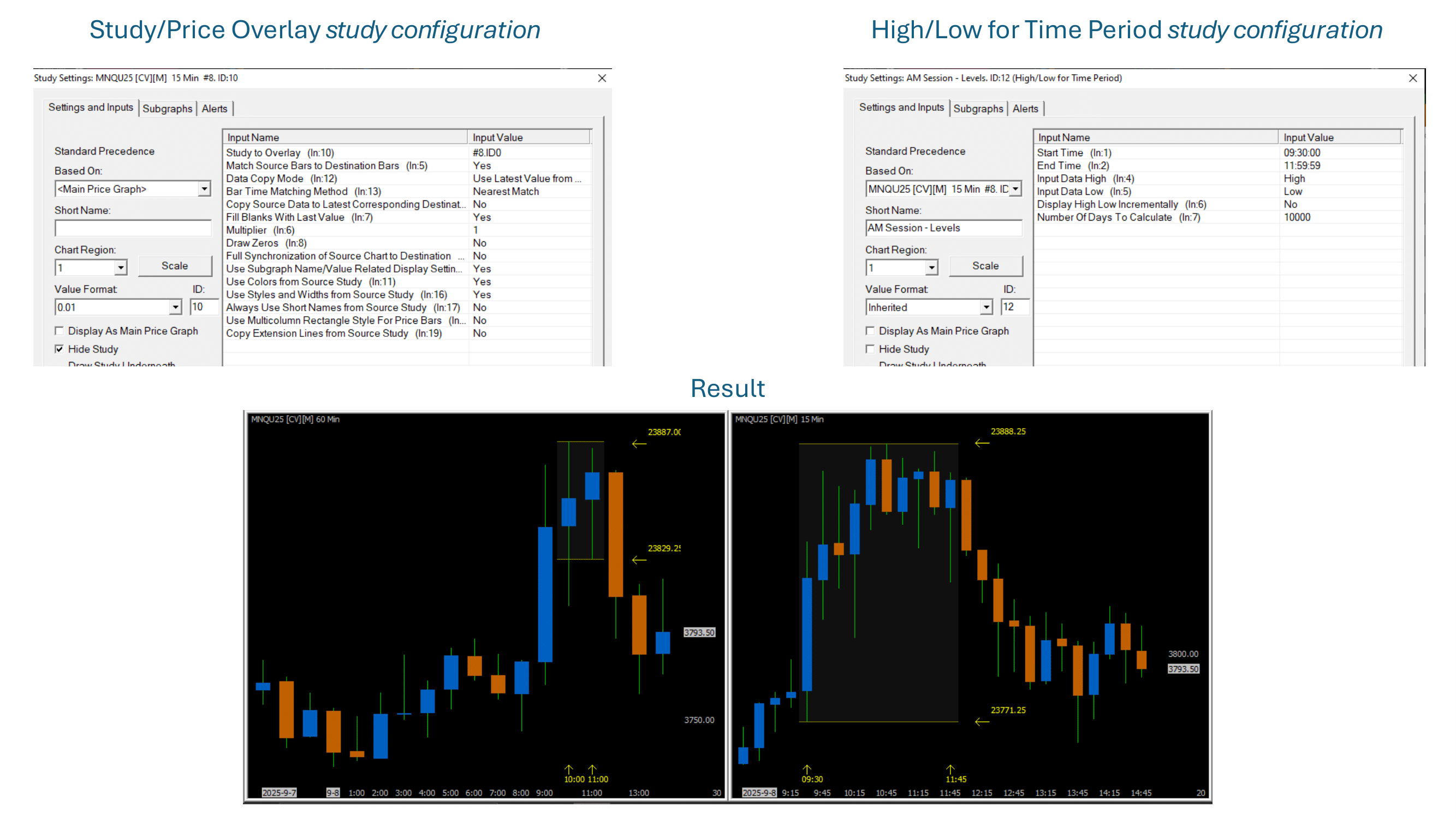

I would like your help in transposing a High/Low for Time Period Range calculated on a chart onto another higher timeframe chart. More specifically, I would like to transpose the High/Low range between 9:30 AM and 12:00 AM, which is calculated on a 15 minute timeframe chart, to a 1 hour timeframe chart.
To that end, I tried to use the Study/Price Overlay study in order to overlay the 15 minute timeframe to the 1 hour chart and use it for the High/Low Time Period Range calculation.
I've tried a few times, but I can't seem to get the 9:30 AM to 12:00 AM High/Low range properly transposed onto the 1 hour chart; please find attached the result I obtain and the studies' respective configurations.
Any help would be greatly appreciated.
Best regards,
imageIllustration.png / V - Attached On 2025-09-09 20:00:41 UTC - Size: 314.84 KB - 252 views
[2025-09-09 21:01:05]
We do not see any reason to have different values, given how this works.
Please get us a Chartbook that has those two charts in it so we can take a look. Follow the instructions at the following link, only get us 2 charts instead of 1:

[2025-09-10 17:46:39]
In these charts, the Study/Price Overlay is hidden and each chart has its own "High/Low for Time Period".
Please setup the Study/Price Overlay by following the information at the following link:
Study/Price Overlay Study
If you can not get this to work properly, then let us know what is occurring and what is wrong.
[2025-09-10 17:56:51]

[2025-09-10 18:13:03]
The chartbook from post #5 has an overlay of the Main Price Graph and not the "High/Low for Time Period".
We have setup this chartbook as we believe you are wanting it. Please take a look at how this is setup to understand how this works. Refer to the following for how to use this Chartbook:
Chartbooks (Workspaces): Using a Chartbook Provided by Sierra Chart Support
attachmentPrice Range Transposition2.Cht - Attached On 2025-09-10 18:12:59 UTC - Size: 9.73 KB - 221 views
