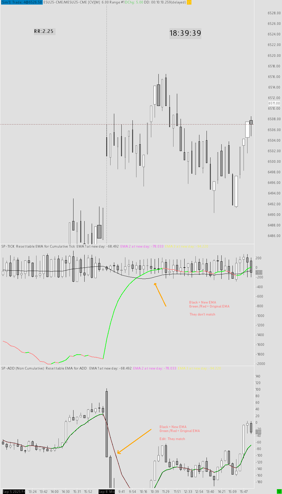

Hello SC Team,
I have 2 market statistics I'm monitoring in the sample chart:
1. Cumulative TICK (Cumulative Sum of Study on TICK)
2. ADD
For each of them, I have a EMA. I wanted to check if the EMA reset at the start of the day.
- Hence, I used https://www.sawtoothtrade.com/free-stuff-18.html (Thank you SawTooth!) which have SMAs/EMAs that reset.
- I used that and applied on my Cumulative TICK and ADD
- Result: Matches EMA on ADD so I know that the existing EMA I originally reset. Did not match EMA on Cumulative Tick.
Qn:
- Why did it match EMA on ADD (I assumed the original EMA does not reset)?
- Why did it not match EMA on Cumulative Tick (I assumed the orignal EMA will match since it's based of Cumulative Sum of Study where I enabled Reset at Start of Trading Day)?
- Which EMA should I use to have one that resets every session?
I have attached both an image: https://www.sierrachart.com/image.php?Image=175737118115.png and the chart file

I took a look at Average - Continuous beforehand, unfortunately it seems like it is only meant for Simple Moving Averages (SMAs), not Exponential Moving Averages (EMAs) -> Any alternatives for EMA though I think what SawTooth(https://www.sawtoothtrade.com/free-stuff-18.html) should do the same.
If they do not reset, why did the following happen for ADD (it also happened for NISS but I did not attached that in the chartbook nor image)?
Yup, I did take a look at the definitions in Sierra Chart Market Statistics: Symbols prior but was unable to clarify based on the wordings alone.
But, I came to the conclusion that they were cumulative because the open of the subsequent candle was the the close of prior candle (which I thought has to be a pre-requisite for cumulative-ness but I just thought of cases where that is clearly not true) so I now know they are definitely not cumulative.

neevaksama - Posts: 78
Sorry, I'm not sure what you mean.
I did use 8EMA in both studies but isn't that the point - to make all things constant except the indicator themselves to check if the orignal EMA was resetting?
Also, just to double check again, there isn't an EMA version of Average - Continuous right?

[2025-09-10 06:45:33]
Thank you John and SawTooth.
Here are my follow ups:
@John
- what I meant was if there an EMA alternative to Average - Continuous since the latter is SMA that resets. I.E do we have a study with EMAs that reset
@Sawtooth
- I have a better understanding of how the sheet works, thank you (using it on a different Chart was kinda difficult till you told me how to do it).
- The funny thing why the SawTooth EMA matches the regular EMA on 1 study (ADD and actually NISS as well but I did not state that) but not on the other (Cumulative Tick, infact the EMA is very off from Cumulative Tick, when Cumulative Tick is sloping up. The original EMA is rising but SawTooth EMA is flat)
- In fact, it looks like SawTooth EMA is based on the original NYSE TICK and not the Cumulative version (hence why it is flat)
- Do you know any particular reason as to why this might be the case or is it just a lack of my Spreadsheet Study know-how?
[2025-09-10 13:01:54]
Sawtooth - Posts: 4362
The 'SMAs EMAs at new day' study references the Last price of the price bar, not another study's subgraph.
Try this:
In cell X3, enter the ID#.SG#@3 of the Cumulative Sum of Study, then edit the formula in M3, replacing E3 with X3.
If you need more help with this, you may DM me.
