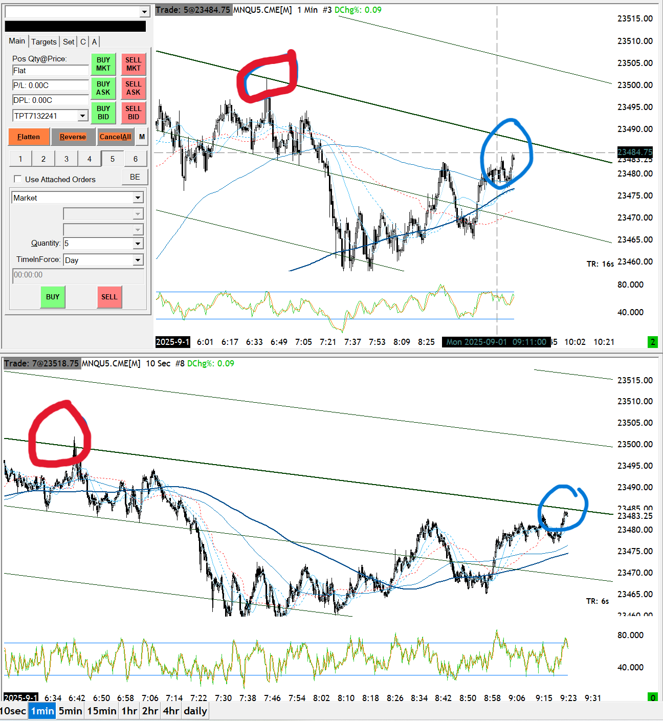

I have attached a photo of my 1 min chart (top) and 10 second chart (bottom). The charts are linked and I have drawn a parallel line.
The drawings are showing up differently although since it is linked, it should be drawn the same way. If you take a look at the red circle, you can see that the lines are drawn so that the candle sticks are touching on the 1 min, but on the 10 second chart, it parallel line is totally off from where it should be. In the blue circle the most current candle should be far from the parallel line as I have drawn on the 1 min, but the 10 second shows differently.
The only method to fix it that I have found was the redraw on the 10second chart.. Is there something else I can do so that this doesnt happen?

Refer to:
Lines/Rays or Other Chart Drawings Move After Drawing Them: Chart Drawings Are Misaligned After Changing the Period / Timeframe Per Bar
Why?:
We do not need the answer. This is for you to analyze by examining the exact anchor points, on the origin chart, and matching those up to the destination chart, and doing the math, and seeing where the line would appear at each chart bar.
