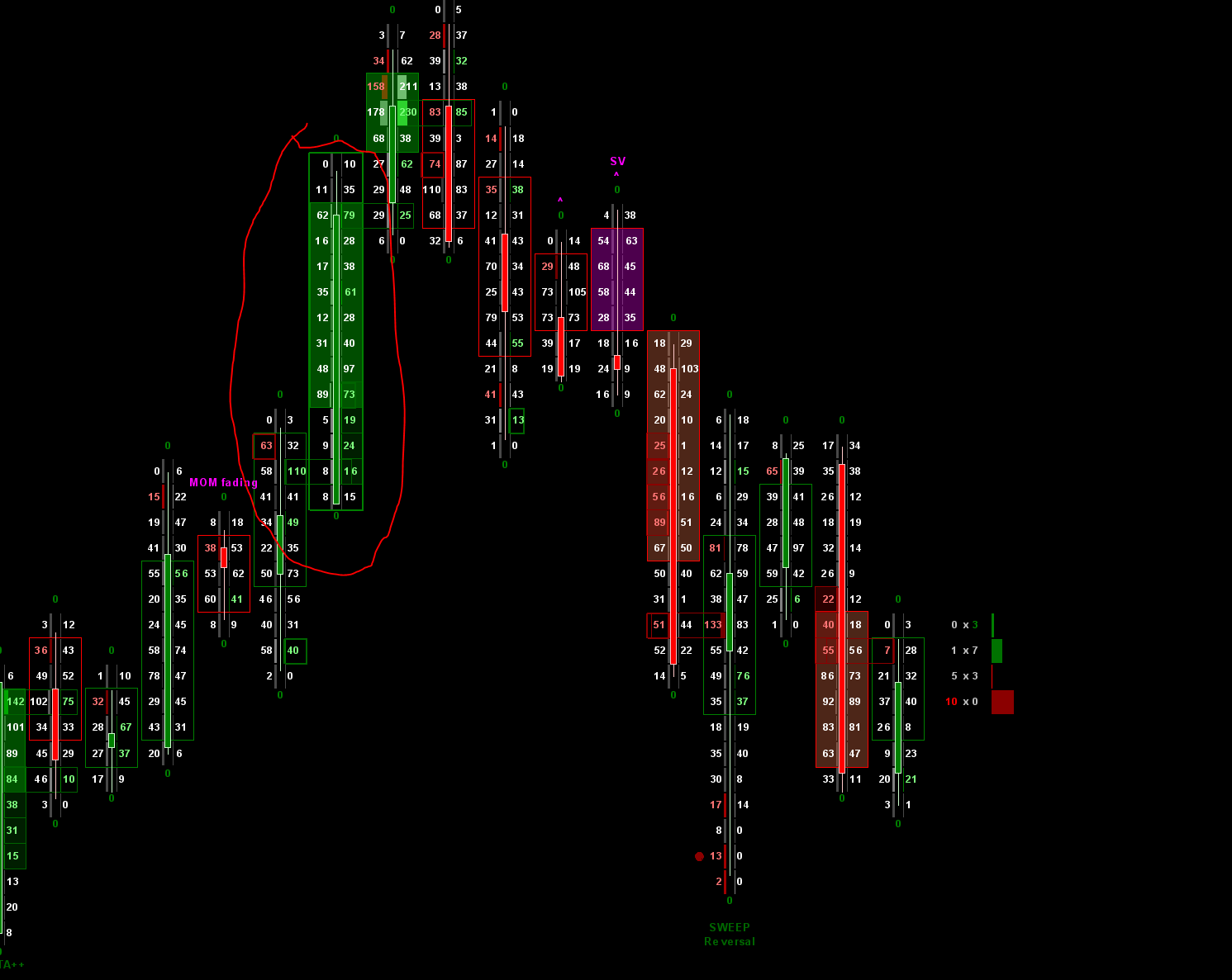

Trade Devils makes a 3rd party footprint I don't like the way they look and they use way too much CPU so I never use them HOWEVER they do two cool things I'd like to code up in Sierra using Color Bar Alerts.
One is a BOX around entire bar if say 3+ imbalances happen in a bar its a great sign for future short term trend direction.
Second is coloring in an AREA in this case notice it shows the value area of the bar colored green because its ABOVE the previous bar's this also tends to be bullish. A few bars later you see a red one and price short term continues that direction.
So I'd like to be able to draw a box around the candle from high to low and also FILL in two areas if an alert condition is true.
Can either of these be done and if so how? Thanks these will help me so much its just a clean and intuitively obvious way to see important things.

The general way to do this is to setup two Spreadsheet Formula studies, each that will perform the test you want where one will return the lowest price value in the bar and the other will return the highest price value in the bar and otherwise to be zero. Keep in mind that despite its name, the Spreadsheet Formula uses the Alert syntax. Refer to the following:
Spreadsheet Formula
Then you would use the "Study Subgraphs Reference" to reference the two Spreadsheet Formula studies and set the Draw Style for the subgraphs for the "Study Subgraphs Reference" to be "Fill Rectangle Top" and "Fill Rectangle Bottom". Refer to the following:
Chart Studies: Notes about Top and Bottom Draw Style Pairs

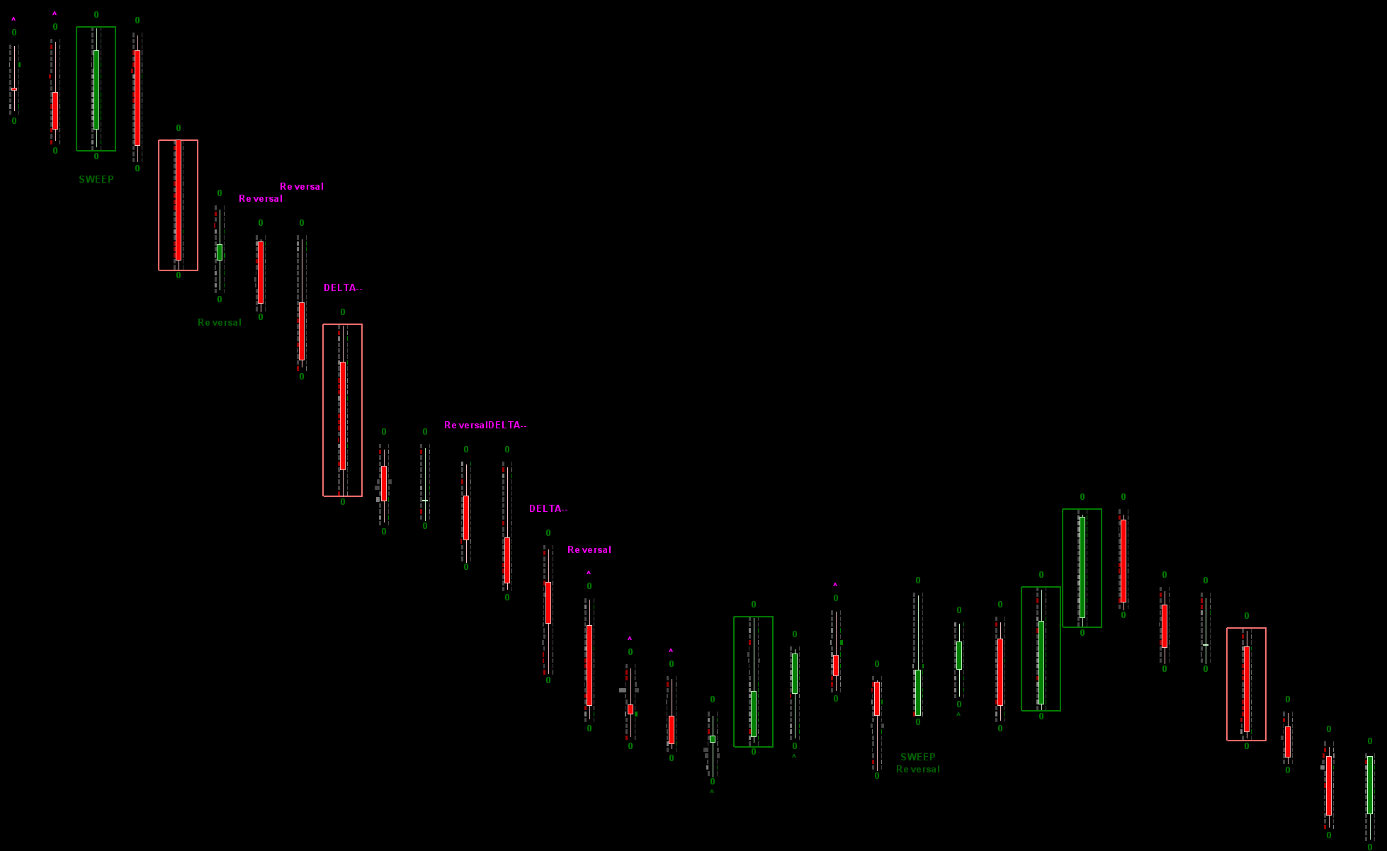

I know you guys are very busy but would like to make a suggestion new Draw Style Rectangle Surrounding Candle.
Here's example of what it would look like. Ideally there should be two subgraphs so if an alert is hit one can color between those two levels or have rectangle/square line around it. I'd love to have an alert condition that would for example mark a ZONE above/below candle for future buying/selling.

There is a Draw Type of "Box Top" and "Box Bottom", which draws an empty rectangle, but the reason we did not point you to this is that it draws between two bars and not over a single bar, so it will not work for what you are wanting.
