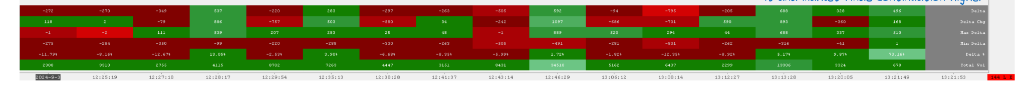

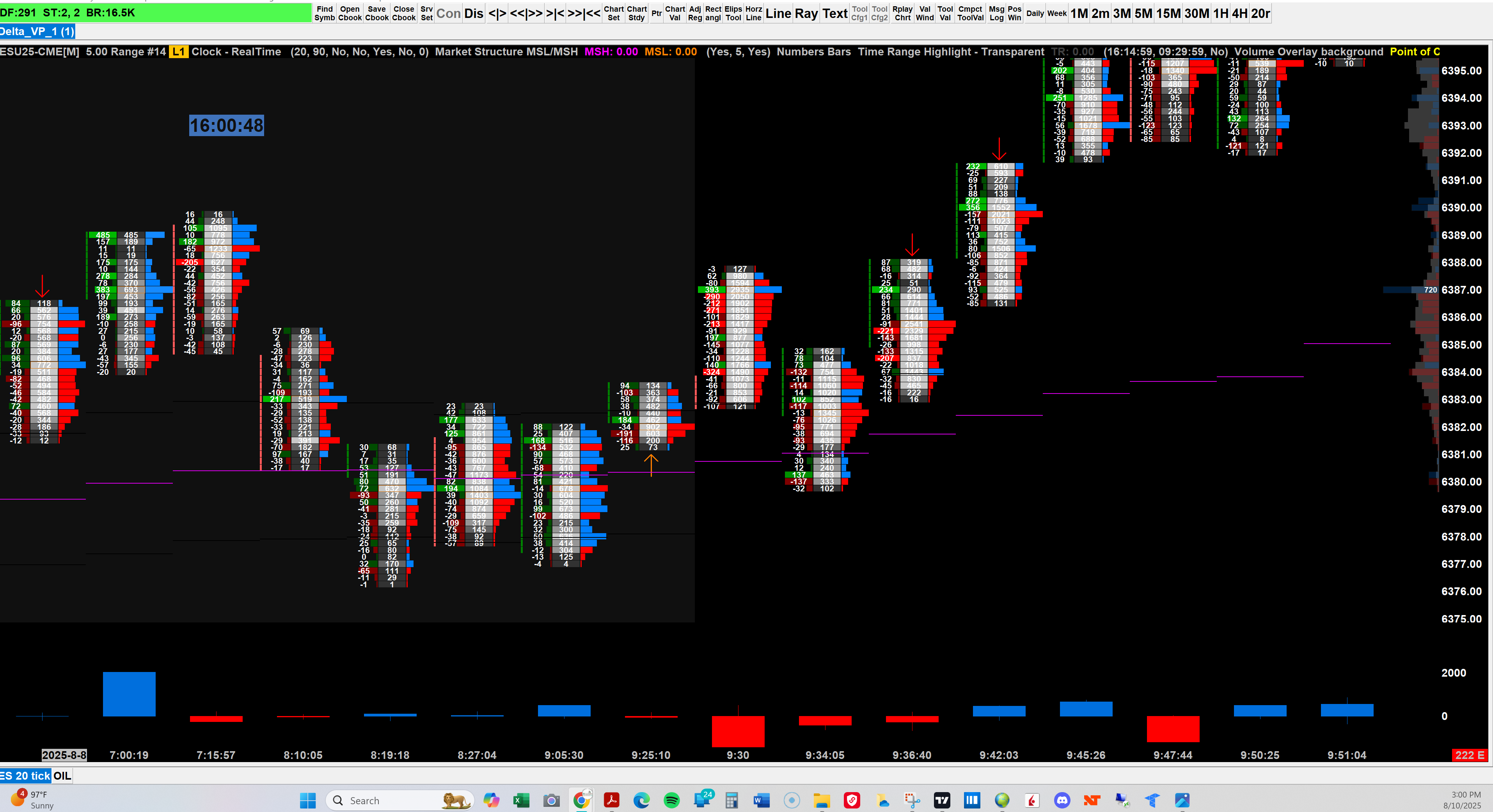

Hi, im looking for a study that goes with my current Delt Profile study. Its shows data from the number bars below my graph in a table format.... See "Delta Row" image as thats what im looking for and need help in finding please.

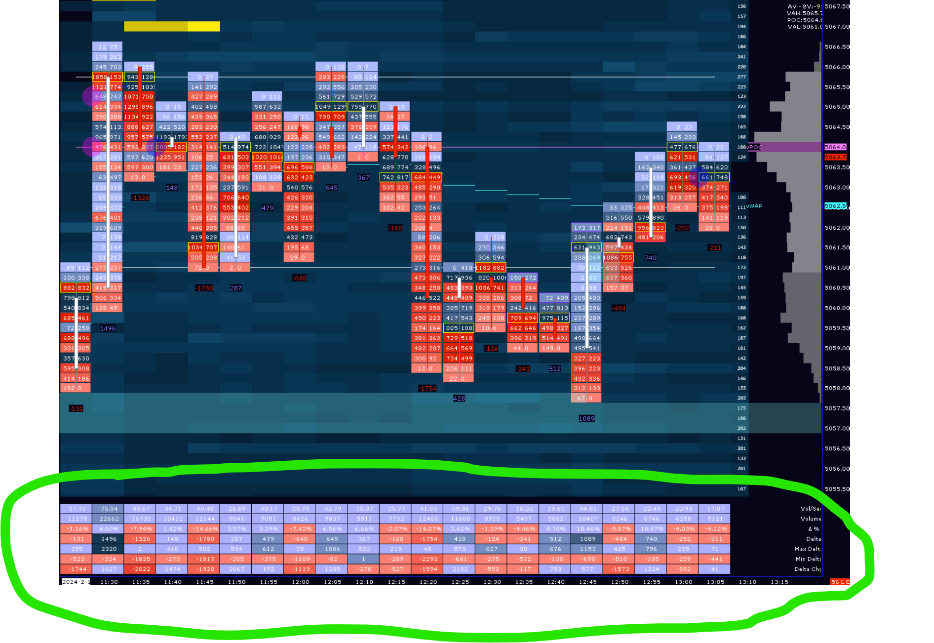

see attached for better image of the footprint statistics im looking for in studies.. thanks

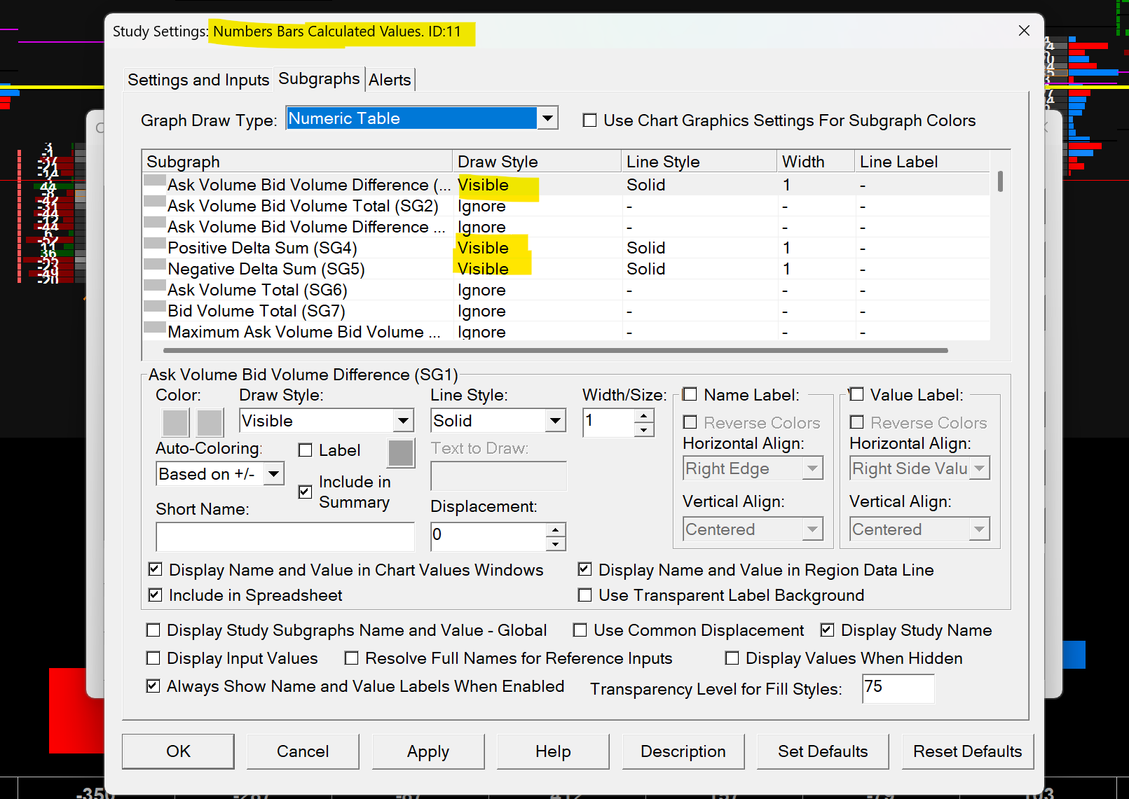

Brightstone - Posts: 28
Im specifically looking for (see screenshot)
* Total Vol
* Max DELTA
* Min DELTA
* DELTA
* DELTA %
The only settings i found on the Number Bar Calculated Values is: Total Vol. It doesn't have the other4 options available like i seen on many other sample layouts abroad from SC
How and Where can i get these 5 specific subgraphs?

User431178 - Posts: 910
What is delta? Ask Volume - Bid Volume
* Max DELTA = Maximum Ask Volume Bid Volume Difference
* Min DELTA = Minimum Ask Volume Bid Volume Difference
* DELTA = Ask Volume Bid Volume Difference
* DELTA % = Ask Volume Bid Volume Difference Percent
Read the docs that the user above linked.
In the image you shared, whoever made it has set short names for the subgraphs.

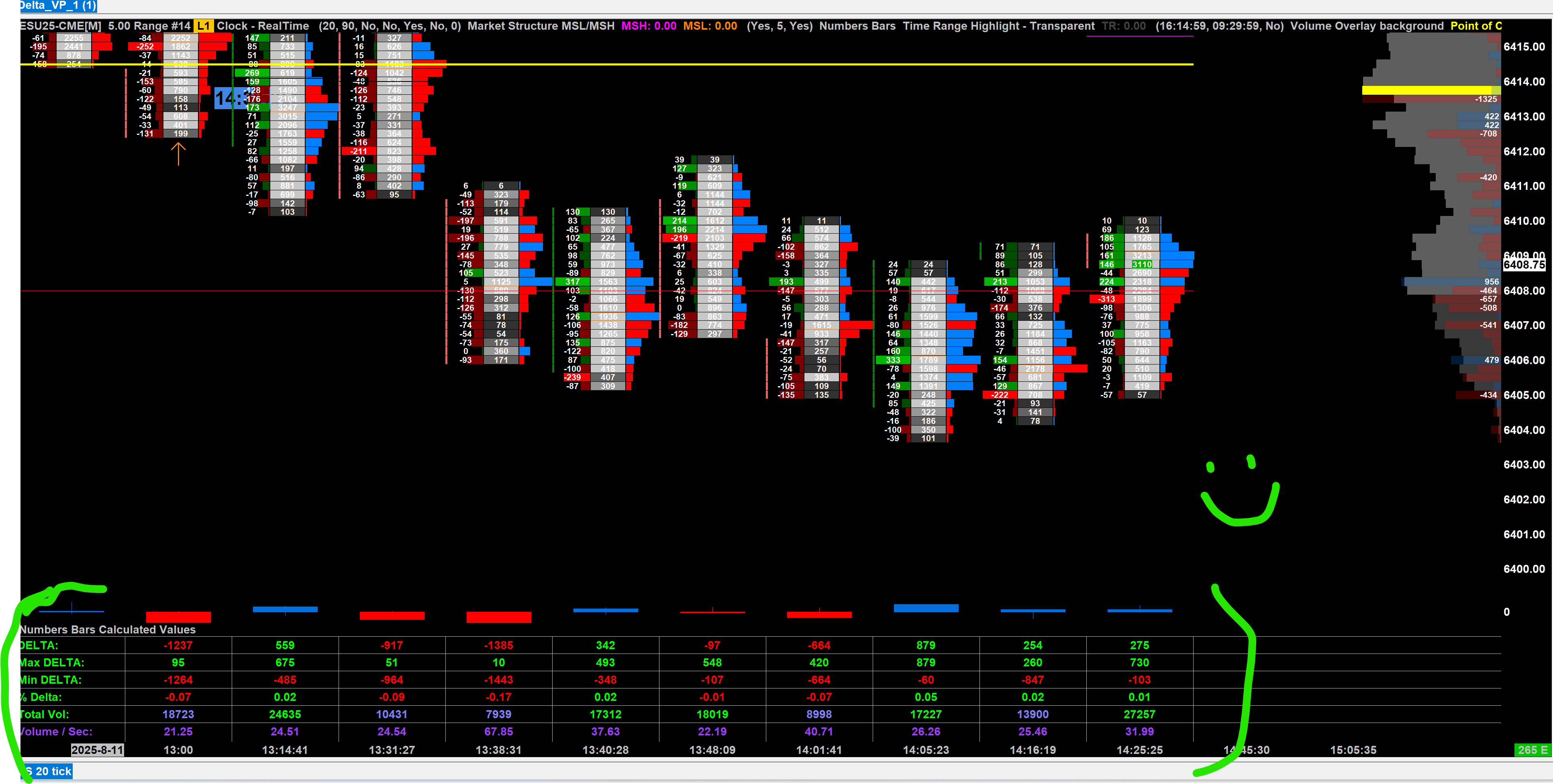

I love you. That made so much sense. Im an idiot. I now have what i've been trying to setup for months. (see screenshot) thank you very much and God Bless You!
